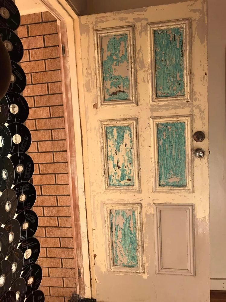

I have a question regarding Paint stripper or heatgun use. We have been discussing at work which is a better way to remove paint (from my door) and everyone seems to be pushing for a heatgun use. They think I am crazy using paint stripper. Can anyone tell me the what the circumstances are for use of either products?
I have used a heatgun to remove paint from a door frame before and yes it works but I didnt like how it left the timber sometimes.
Paint stripper works but I have generally needed a few coats to remove layers of paint.
As I will be buying some paint stripper to continue with the job tomorow I was just wondering about the answers.
Yeah there are around 4ish layers of paint on the door, plus the timber relief (That I dont want to take off) This is only one coat of paint stripper so far and it is going resonably easy.

Yeah The trim I have done around the door frame with paint stripper and it worked a treat (2 to 3 coats of paint stripper ) and then sanding was negligable. Almost tempted to try with paint stripper on the corner and compare lol
Might give that drop sheet idea a go tho would the paint stripper work its way through that plastic? I had a rubber mat under the door to protect the floorboards and it even chewed that. I did what you can see of the door so far in three sections as it warns to not let it dry out as it will reharden. And it does if I take too long scrapping it off.
