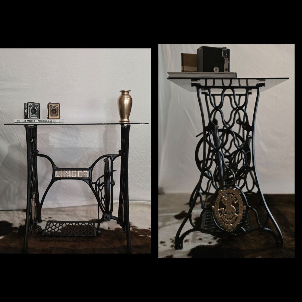

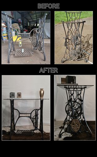

I was fortunate to discover this vintage cast iron Singer treadle sewing machine base, likely dating back to the early 1900s with its beautiful ornate detailing. As with all my vintage finds, I aimed to restore it as close to its original condition as possible. Though the base was structurally sound, it was quite worn and needed careful attention. The most challenging and rewarding part was hand-painting the intricate decorative elements. Through this project, I’ve learned that using high-quality tools and materials makes all the difference. I’ve styled the finished piece with era-inspired items, and I hope you love the result.

Steps
Step 1
Pulled the wheels off.
Step 2
Clean all the dust and dirt off the product with clean water and wiped it dry.
Step 3
Removed old paint carefully with the paint scraper. It is cast iron , if anything breaks it will be a challenge to fix.
Step 4
Used sandpaper in the cracks that i couldn't get the paint scraper into.
Step 5
Put wheel back on and turned it upside down.
Step 6
Under coated with dy - mark metal pro grey primer. Waited 1hr until dry, turned project back onto its legs.
Step 7
Applied the first coat of top coat which is the dy - mark pro black zince and waited 1hr to dry. Applied 2nd coat and waited 1hr to dry.
Step 8
Hand painted with deluxe gold metallic paint the singer word and the details on the legs.
Step 9
Waited 2hrs for gold paint to dry from previous step - 8.
Then done 2nd coat of gold using the gold paint.
Step 10
Placed the smokey grey glass top onto my product. I got that off of a recycled cane coffee table.
