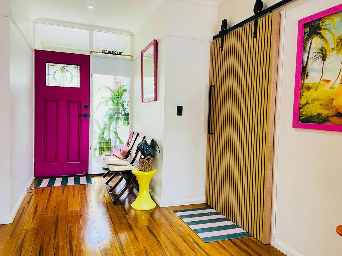

When we purchased our home, we could not fit our new lounges through any of the doors. So hubby cut through a wall, (as you do 😜) to gain internal access from the garage. Of course we then thought ‘why not keep the entrance permanent & create a quirky sliding barn door into our home’ so we did 🙌
I will include before & after pics & the materials used from Bunnings
Hubby cutting out the wallHubby cutting out the wall
Materials
These became the doorThese became the door
Door handleDoor handle

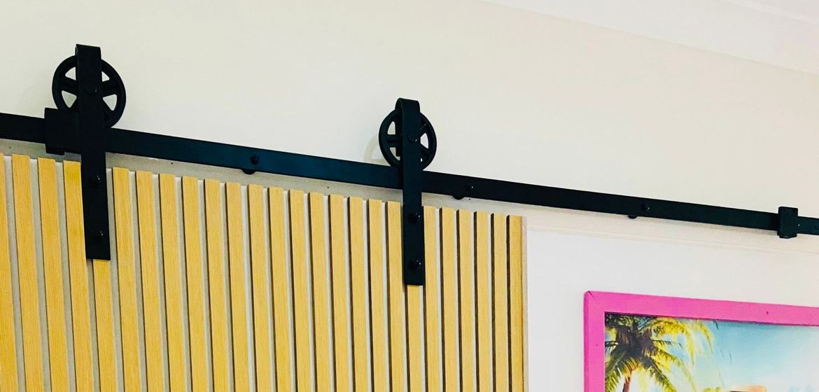

Sliding top part trackSliding top part track
Tools
Steps
Step 1
Cut a hole in the door
Gyprocked
Added the track
Added our creation of the two pieces of panelling
Added the handle
IMG_0002.jpegIMG_9999.jpegIMG_0001.jpegAll finished. Love how it all blends together. You would never know that this was not the original internal access from the garage.All finished. Love how it all blends together. You would never know that this was not the original internal access from the garage.

Hi Patsy60, just wondering if you also have a track at the bottom of the door or something to slide the door at the bottom.  Thanks Di
Re: Sliding barn door
Hi @diohoh,
Allow me to tag @Patsy60 so she is notified of your question.
It doesn't look like she has used the floor guide, but they are usually included in the door track kits.
