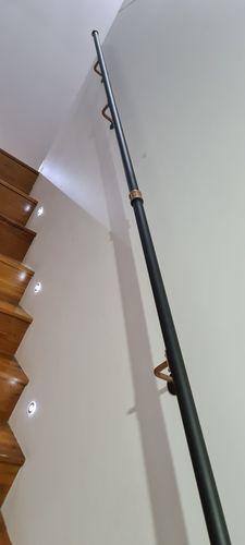

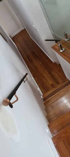

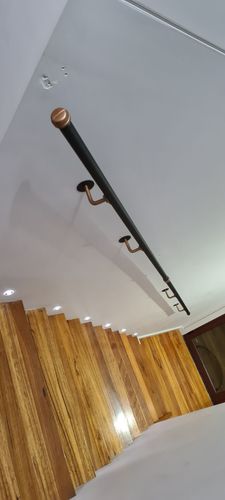

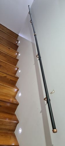

Hi Everyone,  so my latest project was making a 2 rustic handrails for our home. Originally out home had a wooden handrail with galvanised supports.
Please excuse the gyprock damage and holes from the old handrail..😊
The handrail i made is 25mm galvanised pressure pipe from the plumbing section.
The large staircase are ×2 1800mm×25mm galvanised pressure pipe with a joiner and two end caps to finish it.
The smaller staircase is ×1 1800mm×25mm gal pressure pipe
They are supported by flush mount handrail brackets from bunnings.
The pipe is painted in matt black and the joiner, end caps and handrail supports are painted in copper hammer tone.
Its a great alternative and best of all it was pretty cheap and looks awesome...well to me anyway.  
Enjoy.👌🏽👌🏽
