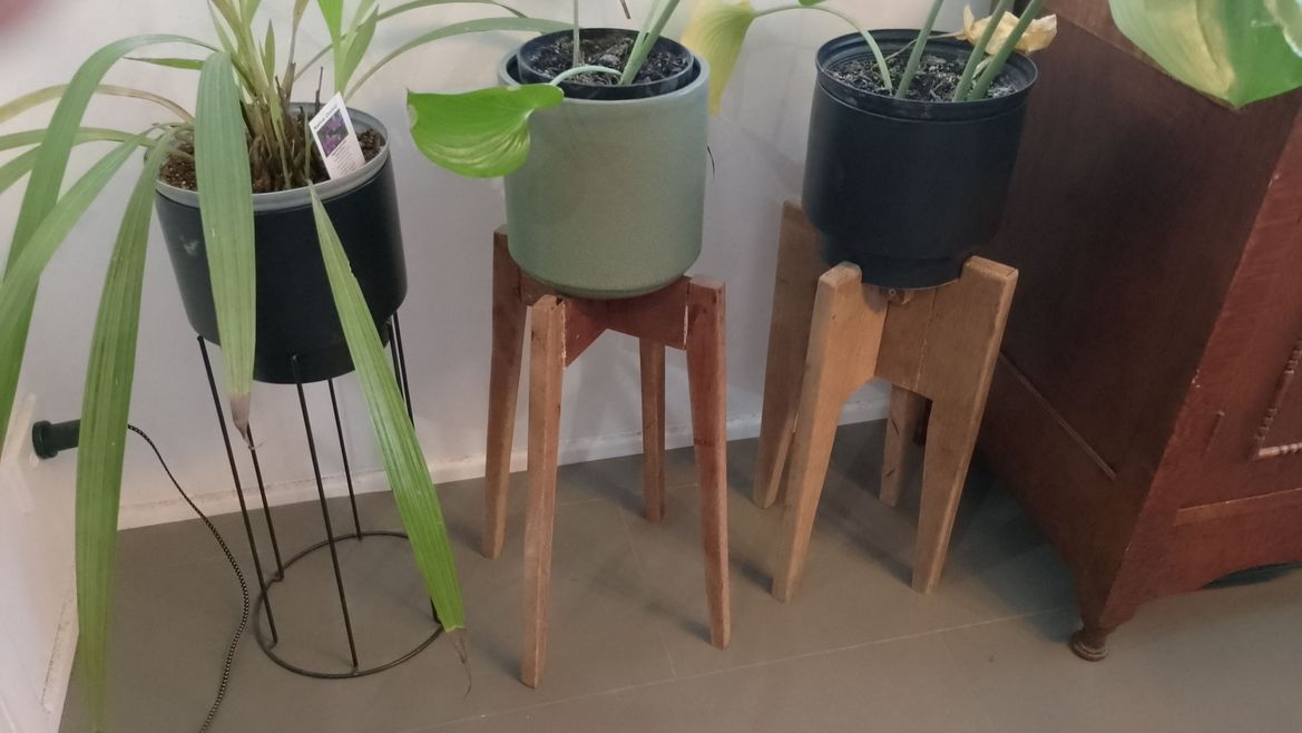

Pot plant stands (continued)
My latest iteration--leftmost timber stand in the main image, rightmost was the initial attempt.
I like the finer look of the cross-pieces & legs (spidery?).
Steps:
  • Legs cut to length & taper cut
  • cross pieces cut to length & lap joint cut
  • cross pieces dowel jointed to legs; set lower to create a lip to avoid pots slipping off. (Considering using screws in future)
Dimensions etc may be added later.
Materials
70x19mm merbau screening slats
dowels & glue
Tools
Drop saw
Hand saw/tenon saw
