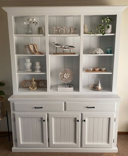

This is my completed upcycling project where I transformed an old Pine Timber Buffet & Hutch into a stylish Coastal meets Hampton cabinet. I wanted a fresh look without the price tag of new furniture.  The project involved cleaning and scuff sanding the wood, replacing the particle board with VJ panels from Bunnings, and applying a primer. I then applied two coats of chalk paint in 'white linen' and sealed the finish with a wax. To complete the transformation, I added black handles from Bunnings, giving the piece a fresh, modern look while maintaining its classic charm.

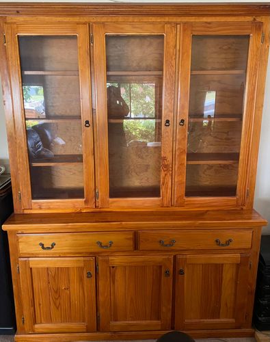

Step 1
The cabinet was in good condition but needed a refresh.

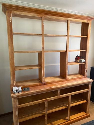

Step 3
The doors were all removed along with the particle board from the back.

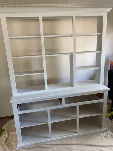

Step 4
 applied undercoat

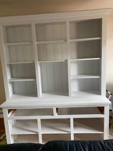

Step 5
 replaced particle board with VJ panels

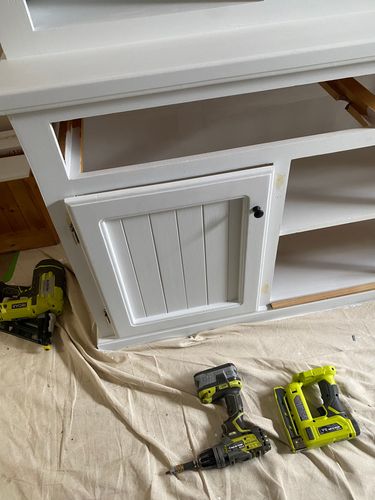

Step 6
returned the bottom doors with new black door knobs
Step 7
Sealed with wax, waited a few days then added decorative pieces.
