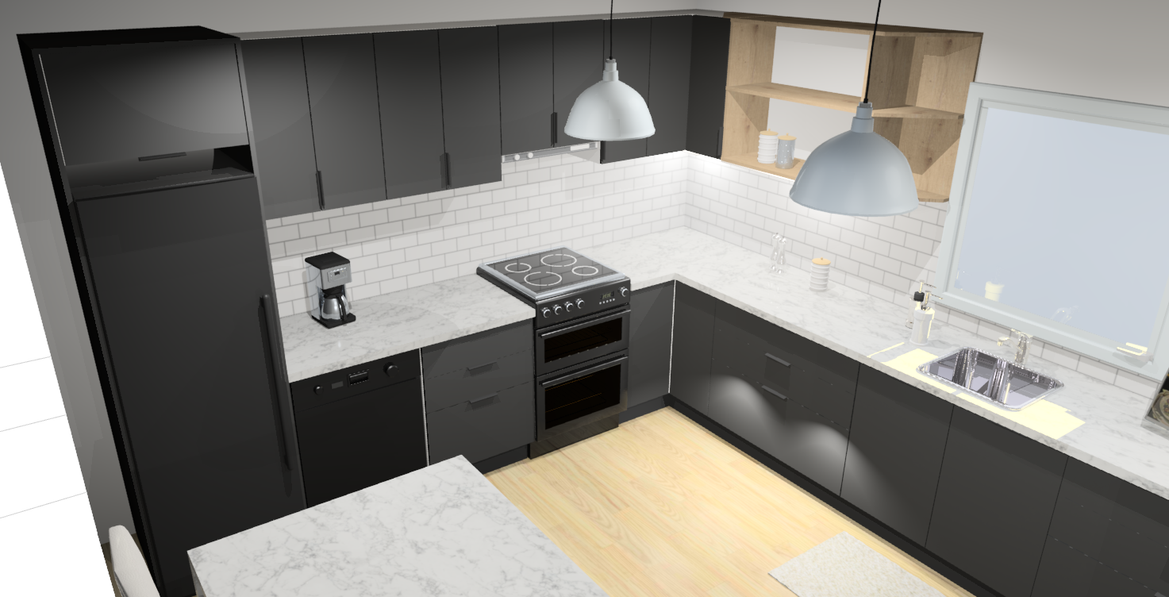

For me, the Kaboodle planner suits best, and with a little creative license, you can create some beautiful layouts. Here's something I've been working on, just for practice.

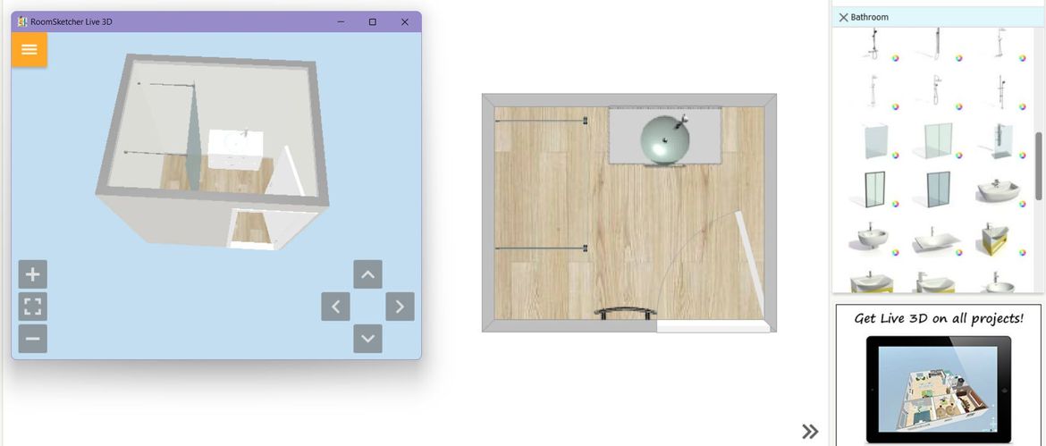

RoomSketcher is not too bad - 2D is free, 3D is 20 USD. Again, you're limited by the stock images, but there is a reasonable range, and it doesn't take too long to make progress. You can get a reasonable idea of how it looks pretty fast.
** whoa I have just realised that the 20 USD for 3D is only for the single "Project" not for the account, and you only get 5 free "projects" then it's 10 USD for another 5. I guess the trick is to make the whole house = a single project (as shown in the bottom right of the image below) whereas I was going room by room.
I have also tried SmartDraw but it is more expensive.
Here is an image from RoomSketcher fyi (that's my microscopic bathroom 1.7m x 2.3m in planning).
