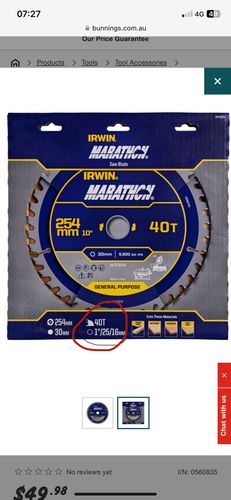

Hello, I need to replace the blade on my Ozito 254mm mitre saw.
will the Irwin 254mm marathon 40T fit? I think it will but struggling to find specs of the blade width?
what are the measurements 1”/25mm/16mm on the box refer to? See attached.
