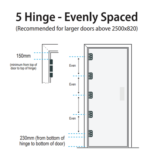

I'm looking at installing the 1200 wide entrance door, what hinges are recommended?

For anything over 900mm wide, you'd need at least four hinges. Here's the Hume doors hinge installation guide. Since your door is so wide, I'd recommend you go for the five-hinge evenly spaced layout. Pinnacle 100mm Fixed Pin Butt Hinges would be suitable for your installation. Here's a helpful step-by-step guide: How to hang a door.

Great thank you I wasn't sure if I'd need something more substantial or just go with more hinges!👍
