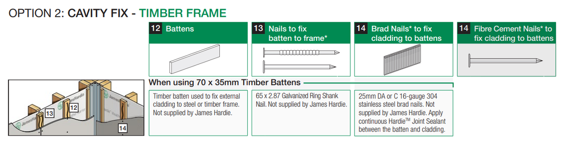

The information required for the installation of Hardie Fine Texture Cladding can be found in the Hardie Fine Texture and Hardie Brushed Concrete Cladding Installation Guide and supplementary documents found on the James Hardie page here - Hardie™ Fine Texture Cladding.

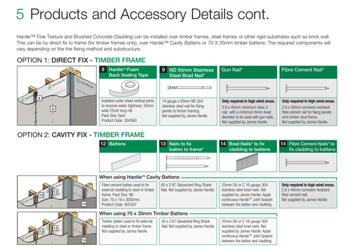

The specific fixings are relative to the type of installation. This can be found on page 6 of the installation guide.
It looks like you are using the cavity fix installation method which means you can use Paslode 25 x 1.6mm Stainless Steel Pneumatic Brads with Hardie™ Joint Sealant between the batten and cladding. Both of these products would need to be special ordered, so speak with the team at your Special Orders desk to get pricing and place an order.

Here's the link to their installation guide and application guide to joints and junctions. All the information you need will be within those guides.
These Paslode 25 x 1.6mm Stainless Steel Pneumatic Brad - 2000 Pack would be suitable for a bradder nail gun. Note that if it is a high-wind area, there's a requirement to use fibre-cement nails instead of brads.
Hardie's joint sealant is to be applied to your battens and the edge of the shiplap prior to installing the sheets.

It's best to use stainless steel as it won't rust. Galvanised brads only have a protective coating on them, which can be scraped off when they are shot into the cladding. Since water can get behind the cladding, it can rust out the very thin brads. Using brads to install cladding is already pushing boundaries, so it's best to use the specified products, especially if you wish to keep the warranty on the boards.
