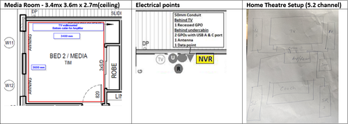

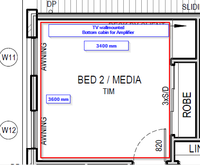

below plan is my media room (3400mm x 3600mm) (excluding desk & Robes) and ceiling height is 2.7mm

small media room 3.4mx 3.6m x 2.7m(ceiling). Sorry for the long list of Questions as still not clear on this ☹
1) i am planning to wall mount the rear speakers as i dont have spacing on floor level as i will place couch opp to TV.
2) Front Speakers can be placed on top of bottom cabin or floor as i have to decide the cabin work yet.
3) this is how i thought to go for 5.2 channel. so please correct me if this is wrong and add or modify for 7.2 channel.
4) I asked electrician to do wiring points as above and advise me if any changes required here.
5) Do I need to select the home theatre package first in order to do this wiring. Which is the better way to buy like buying whole package from home theatre shop or buying speakers, amplifiers, TV or Projects separately from shops
6)What configuration for speaker or amplifier setup to buy and Which is best place or shop to buy these speakers, amplifiers in Sydney.

Since all your speakers and Rec / Amp are all going to be on the front wall, you will only need a few metres of wiring to cover all that...approx. 10M.
The biggest problems are going to be..
How the surround speakers are going to be wired..ie where and how the cables are going to be laid..
Where the surround are going to be positioned in the room..
And how the surround speakers are going to be mounted.!!
All these measurements will be for a 5.1 system...
Before any of that can be sorted..I would need to see photos of the robe and the space to the right of where the cabinet will be..
Those images will show me what the best way will be to run the cables to the surround speakers..and it will determine what length of cabling you will need..
