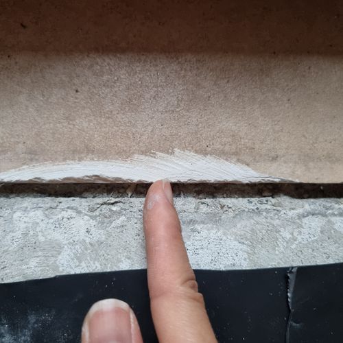

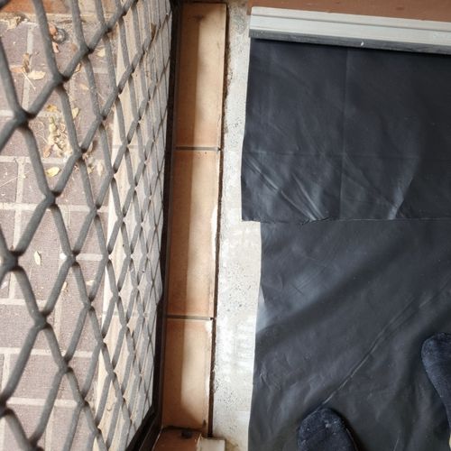

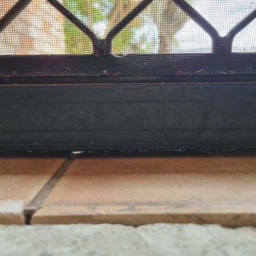

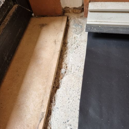

Hi, what kind of trim would you recommend between tiles and hybrid floor. The hybrid floor will be slightly higher. The tile is outside the entrance door and exposed to the elements. There is a gap about 8 mm wide between the concrete subfloor and the tile. If anyone knows the reason, please let me know.

I can't say I'm sure why there is a gap between the tile and the concrete, but it could be that the concrete rebated, so the face of the tiles sit level with the inside.

Hi @JacobZ, thank you for your suggestion. I'm reluctant to drill in the concrete subfloor as it looks already fragilised. Is there an alternative ?
Also there is a gap where I suppose I would drill and install the magic plug in, wouldn't it make the plugs sit too deep in the gap to install the trim  securely on top ?

You will need to fix the trim in place @Karellu, which means attaching it to the concrete. I'd suggest filling the area with Earl's 500g Concremate Expanding Cement. Once it has set, you'll have stabilised the edge and can drill into the patched cement to insert the plugs to fix the trim.
