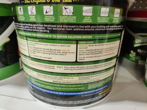

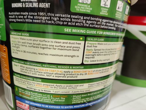

I am going to use the mortar mix with the cement additive. (I have 6 meters of ridge capping to rebed.) But I just found the use directions of BondCrete cement additive (at the back of the product bucket)are not clear enough for me. Can you please give me some more advice?
1. Do I need to apply sealer coat or/and bond coat before I do rebedding?

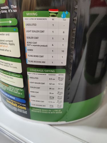

2. Which use guide in the use directions do I need to follow? Admix guide or tiling screeding guide?
3. How do I prepare the mortar mix? If I follow the admix guide, I need 10L of water to dilute 1L of BondCrete(I will get 11L of mixture), which can be used for 20kg of cement(from the coverage table at the back of bucket). I assume 20kg of cement can make 100kg of mortar mix. So for a bag of 20kg mortar mix, I need 2.2L of BondCrete mixture. However the mortar mix you recommended in the post need about 3L of water for one bag. So I am confuaed...Do I add another 0.8L of water into mortar mix after I add BondCrete mixture into the mortar mix?

The sealer coat method is when you brush the BondCrete onto the concrete surface. This is one way to use the product, but if you are doing the Admix, the BondCrete gets mixed in with the mortar.
The bucket guide says that 1 litre of BondCrete is to be mixed with 10 litres of water if you are doing the Admix. The 20kg bag of mortar mix only requires 3.3 litres of water. Therefore, for every litre of water you will need an equivalent of 100 millilitres of BondCrete.
Since the 20kg mortar mix requires 3.3 litres of water, you'll need to mix 330 millilitres of BondCrete with 3.3 litres of water. I've spoken with the technical department of BondCrete and they recommend that if the mix is too viscous to add water so that you get a more manageable mix.
