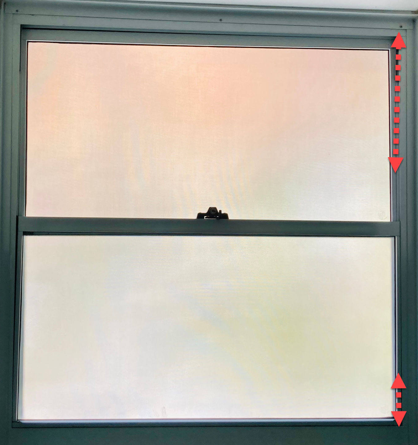

I’d like to install a window lock to open/secure my double-hung aluminium windows by a few cms if I'm out or asleep.
At the moment the window only locks if it’s completely closed.
Which of these would be ok? I'd like sth small, discreet & easy to use

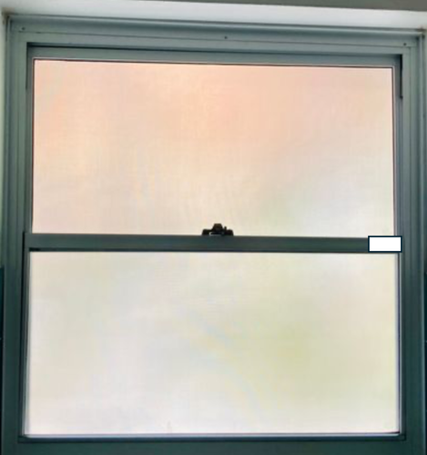

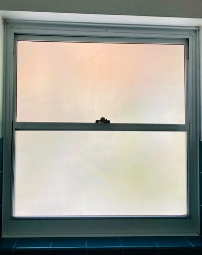

Would it be possible for you to post a few photos of your window? It will give our members a better idea of its construction, we'll then be able to offer recommendations on how to mount the locks to your window frame.

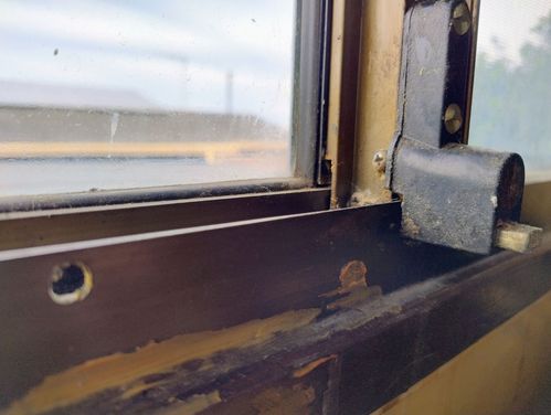

With aging memory took a while to recall I have done this before with Stegbar aluminum sliding windows using the standard Whitco bolts.
As mentioned by @JacobZ that window (one of many in that double story house) used wood dowel for the ground floor windows.
Note the drilled hole in the frame that allows the window to be locked in the open position.
Wondering how we can turn that horizontal solution into a vertical one to suit your window(s).
Maybe this?
Raise the window to the desired open position and drill a hole to accept some sort of lock pin like a machine bolt.
