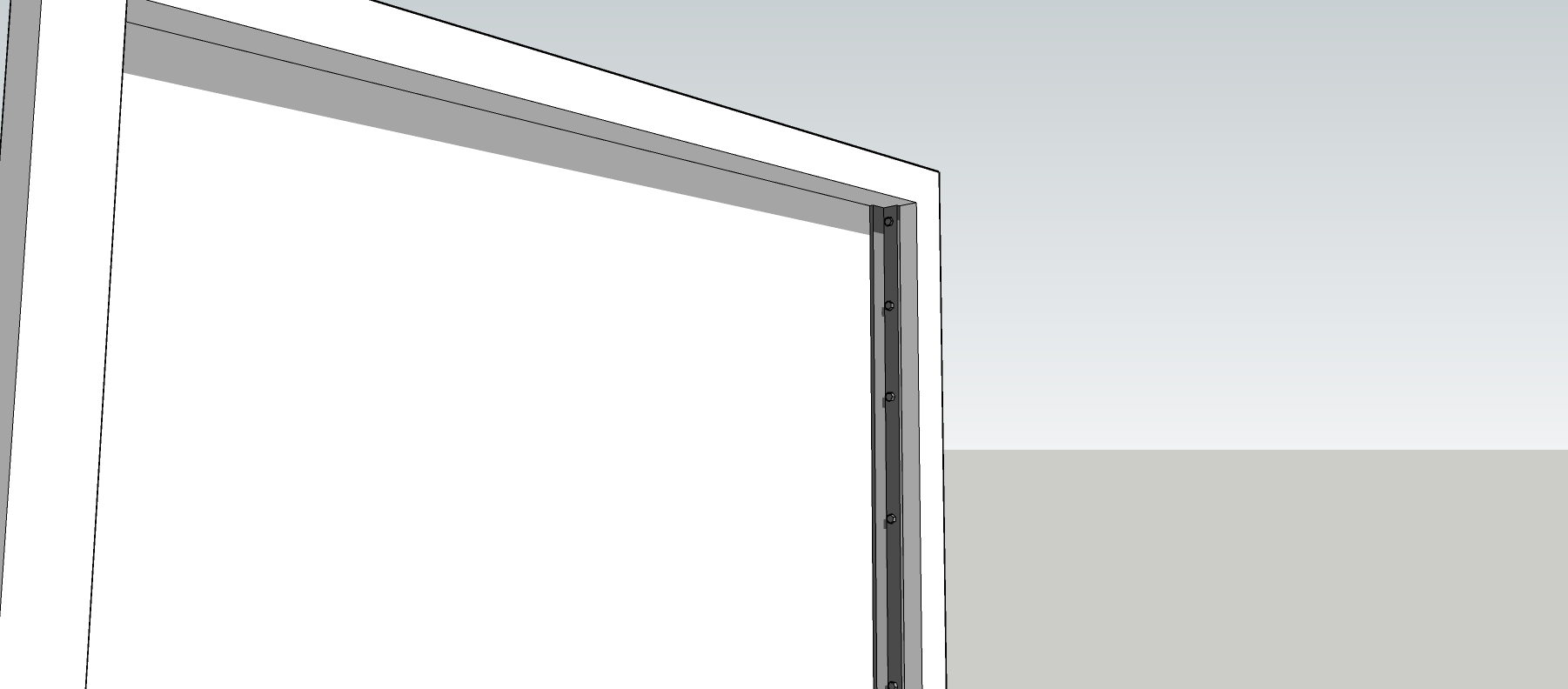

May I ask how I would install the metal mate as the door jamb? I’m sorry if it’s a stupid question but I just can’t see how it would go on.
Cheers
Re: Will a non-mortise door hinge work on an external door?
Hello @BoeingFan
Here is a quick sketch of the jamb. It's basically anchored onto your door frame with really strong screws.
If you have any other questions, please let us know.
@EricL Ah, I see what you mean now. Thank you so much, I’ll discuss it with the war and peace officer
