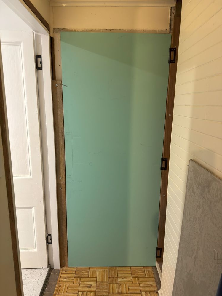

We managed to find some old hardwood 3x2's to put down the left side (looking out) to bulk up the frame and to accommodate the lock, and we used some of the leftover spotted gum behind the hinges. So, my circular saw skills have been confirmed as woeful, but it is what it is.
Question, please... Have I put the hinges on the wrong way? I had one of those self centering jigs for the drill, bit because I was drilling in a cavity which was too small to fit the whole drill, I had to go in on an angle. I have a sneaking suspicion that the hinges need to be flipped top to bottom so that the round pin bit of the hing is on the inside of the house, rather than facing outwards, if that makes sense. Pic's below.

Yep, here it is. Not bad eh?
Does this need to be flipped over?
Hi @BoeingFan,
Unfortunately, yes, you have put the hinges on the wrong way.
You can tell that the screws are not installed in the right face of the hinge because they are not sitting in the countersinks on the hinge plate.
They are supposed to sit on the inside face of the door jamb, not the outside face of the architrave.
You can actually see how they are supposed to be on the door to the left. From the inside of the door, when it is closed, only the hinge pin should be visible.
You'll have to unscrew the hinges and give it another go.
Let me know if you have any issues so I can assist further.

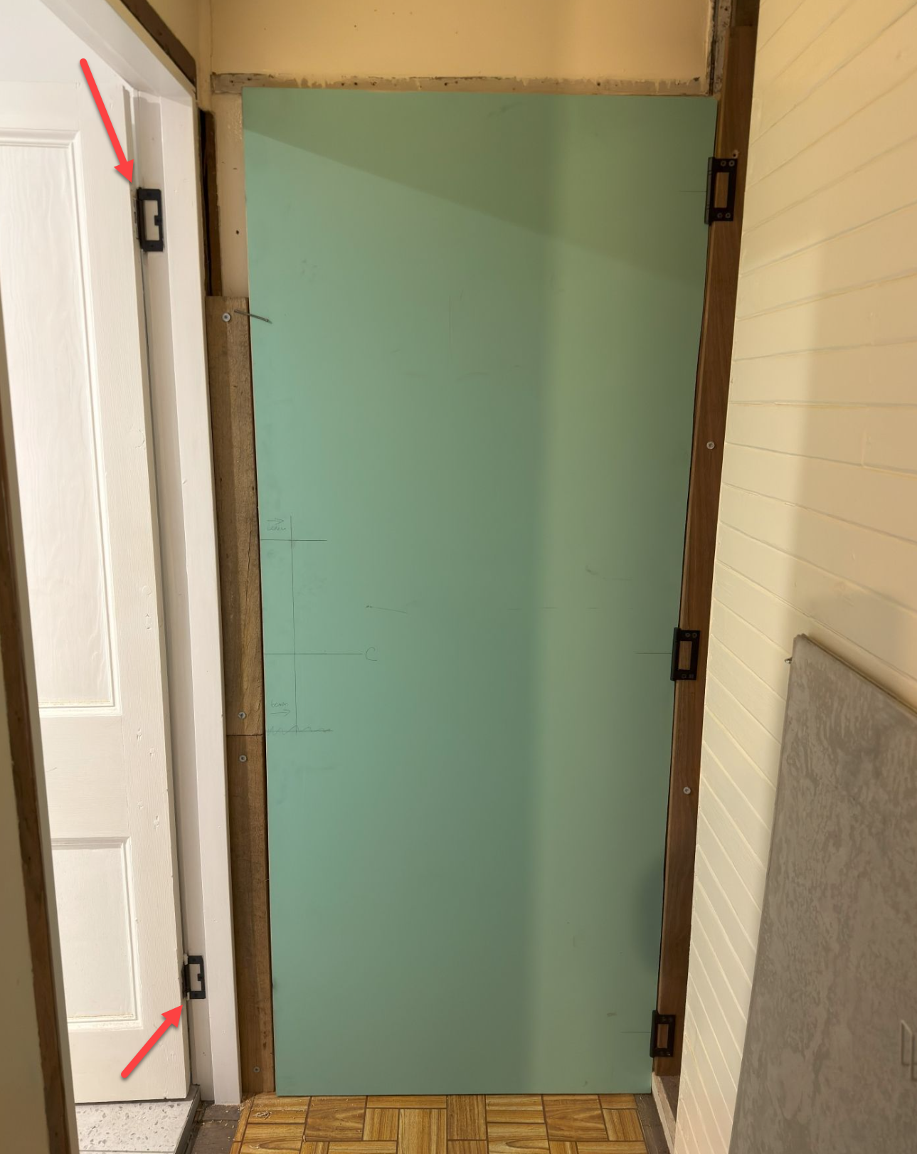

Hi @JacobZ
Thanks for your reply. I know it's not the 'typical' installation; the good news is that the door swung beautifully and freely.
I should have used the term 'horizontal axis' instead of 'horizontal plane' to make my question clearer, however as you can see in the photo below, I'm wondering whether the hinge should be flipped so that the pin is on the other side of it's current position?
Cheers.
which side of the hing plate should the pin be?
Hi @BoeingFan,
Usually, it would be on the other side of the pin, which is evidenced by the location of the countersinks on the hinge plate. If you were to flip it, it would make the door sit further out from the opening, so if you're happy with it how it is, I would just leave it.
