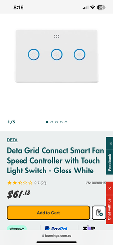

 i bought this two item, but some how the 3 speeds button doesn’t not working ,it show on the button with light blue colour   One dot ,2 dot or 3 dot when I pash it , but doesn’t not show and effects

My apologies for the late reply. The DETA customer service team said that the smart fan AC controller only works with AC fans, it can't directly control another GRID fan. The controller can only be used with a non-smart ceiling fan.
