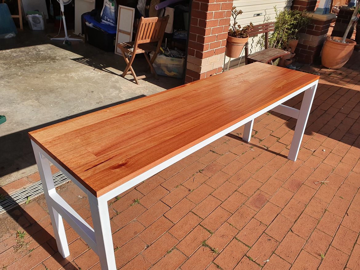

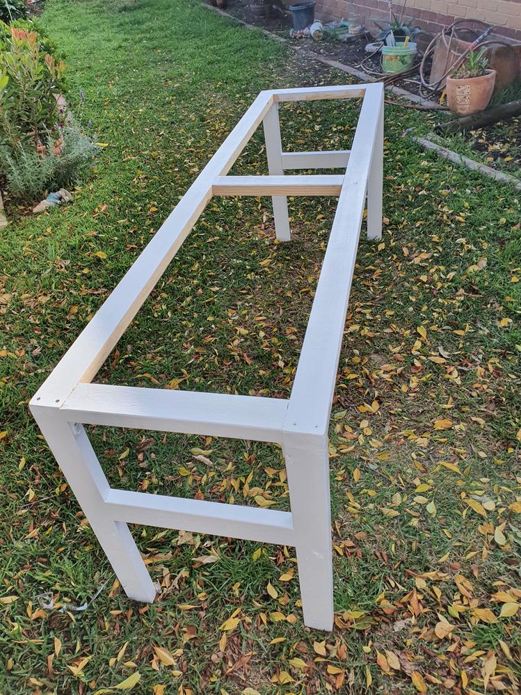

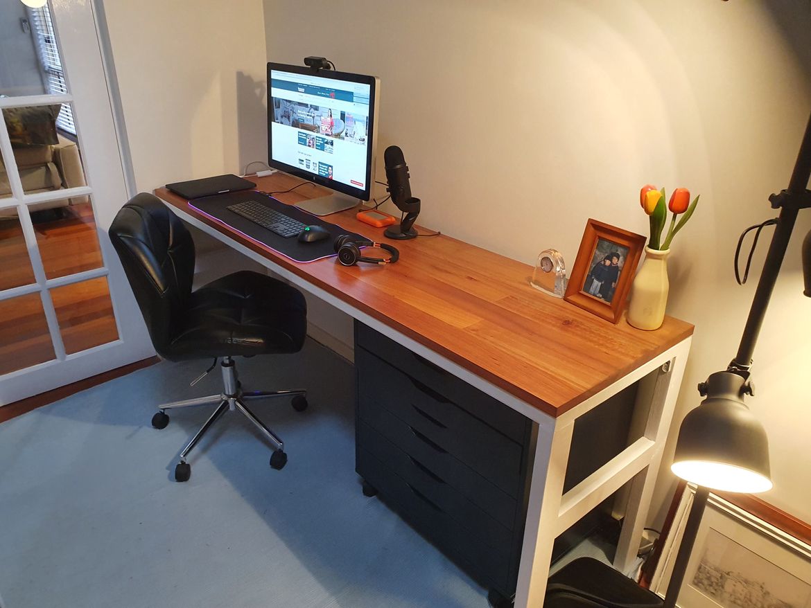

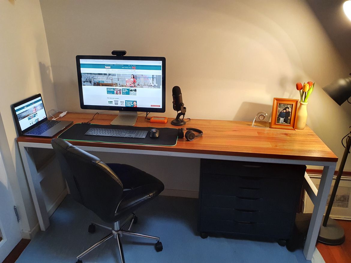

I thought I share my build for an affordable computer desk as most of us are now working from home. I needed an extended desk to fit into the study but couldn't find anything within my budget. My budget was under $150 for a 2-metre long desk. It's a straightforward build, and anyone can do it. It was my first desk that I have made.

Update: It has been six months, and the table is holding up well. I built another computer desk with my son for his room of similar size, and he loves it.
Good job,well done.
What material did you use for the top of the desk? It looks really nice.
Thanks mate..it was the 2200 x 610 x 26mm Oiled Karri Laminated Panel for $129 but sometimes it goes on special for $99. I covered it with linseed oil and tung tree oil from Ikea to bring out the colour.
Thankyou, saves a lot of work in making your own top, again well done.

Hi Noyade,
I used these brackets https://www.bunnings.com.au/carinya-50-x-50-x-20mm-zinc-angle-bracket_p2760244 and fitted eight into the frame. It holds the the frame really well and is a nice design.
What cabinet did you use for under the desk?
