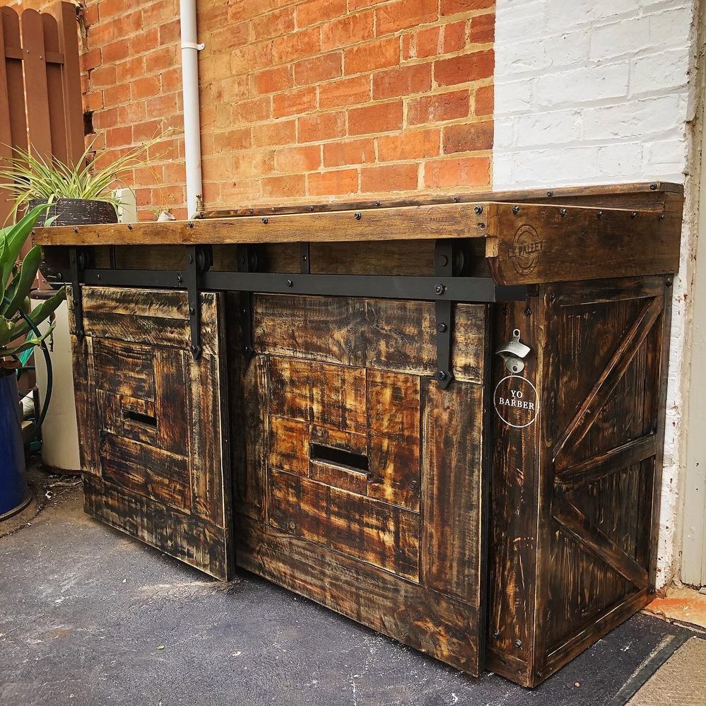

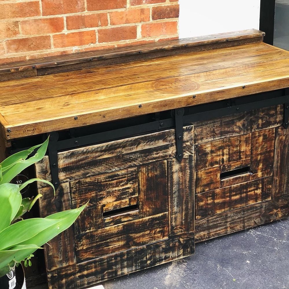

This distressed console table made with recycled pallet timber features barn-style sliding doors on a double railing system.

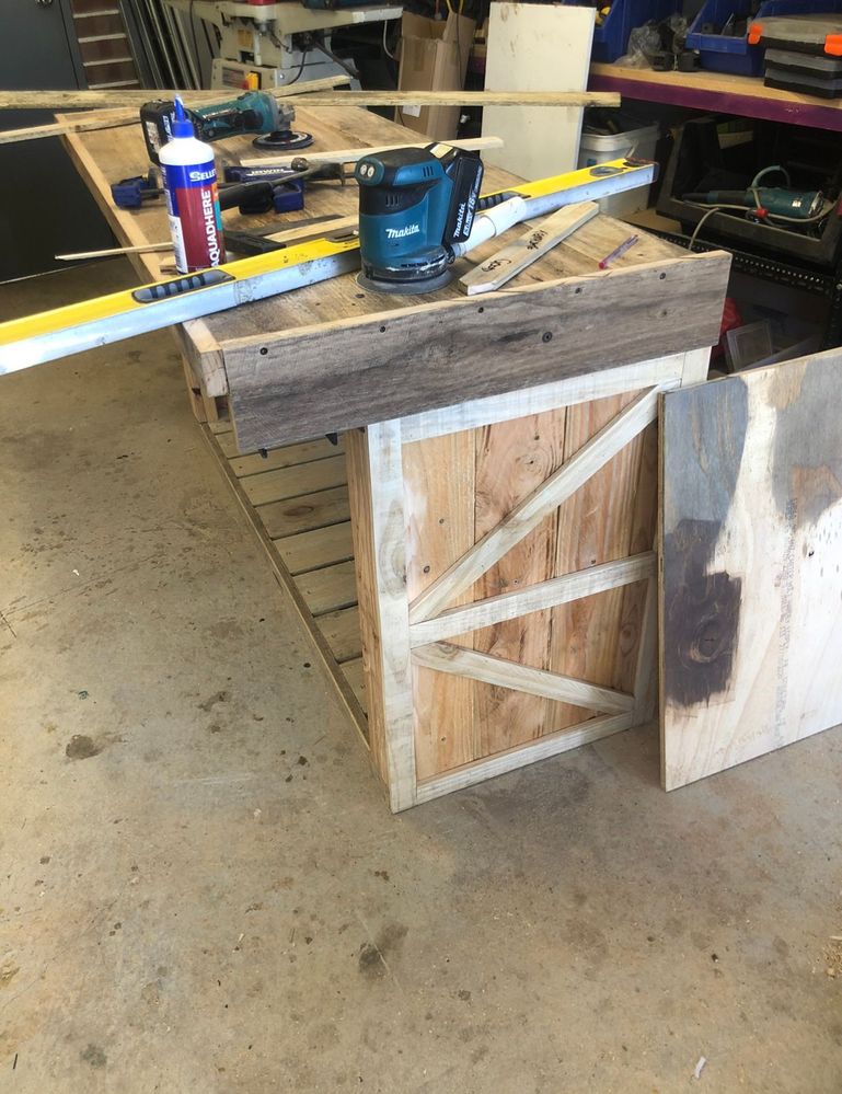

The project

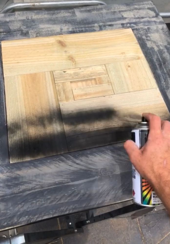

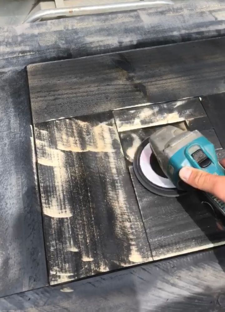

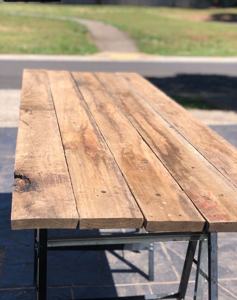

This project was made using recycled pallets, hardwood planks and treated Pine fence palings. I created a rustic-effect on the timber making this console table look distressed.
The main feature is the barn-style sliding doors on a double railing system. The doors are made from 12mm treated Pine fence palings glued to a 17mm plywood panel.
