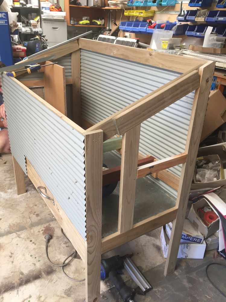

After some research, we found the optimal size for 4 chooks. I drew up a design which I was happy with and got to work. This is basic construction with glue and nails. (Yeah, I know the shed needs a bit of a tidy up).
I decided that a tray under the roosting rails would come in handy when cleaning. This used to be a drip tray from an old supermarket freezer. I think the handle is off an old outdoor gas heater.

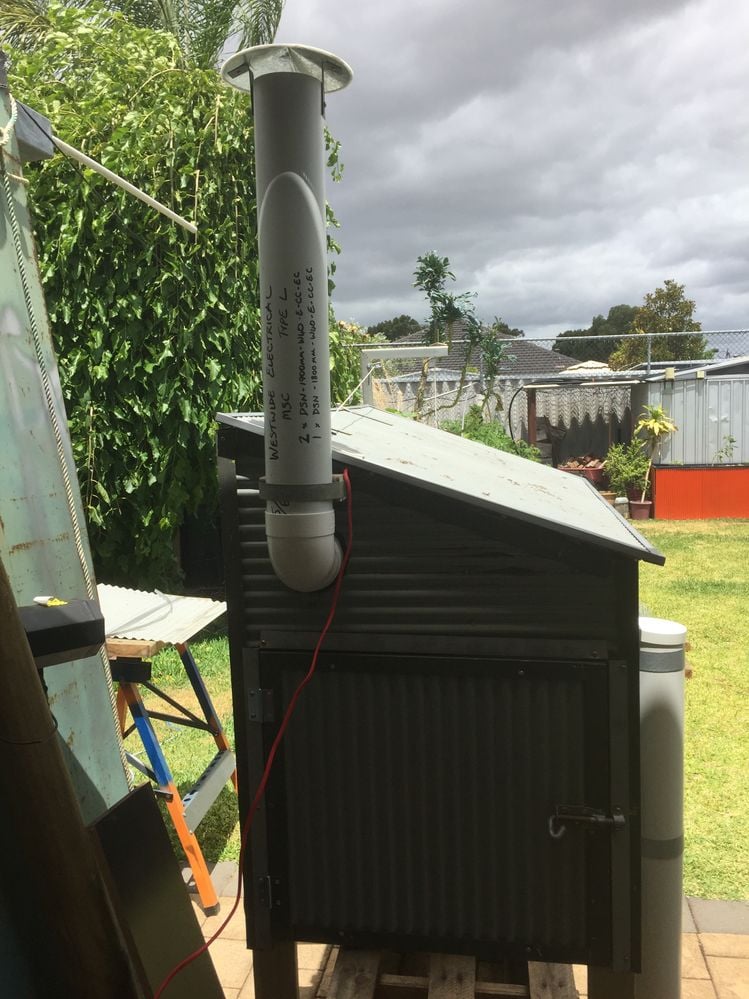

I made up a pvc chimney to allow heat buildup to escape. (The shed is insulated as well). You can see the door to the 2 laying boxes. The lid is also on hinges for easy cleaning.

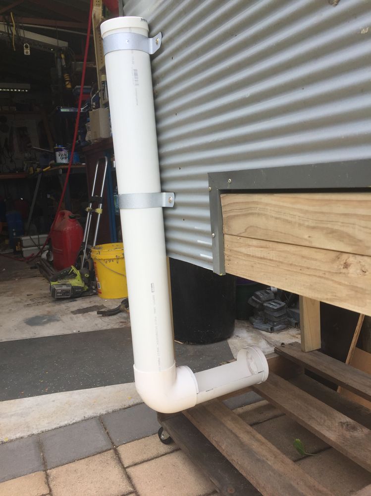

Feeder made out of 90mm pvc downpipe. Just waiting for the water nipples to arrive for the waterer.

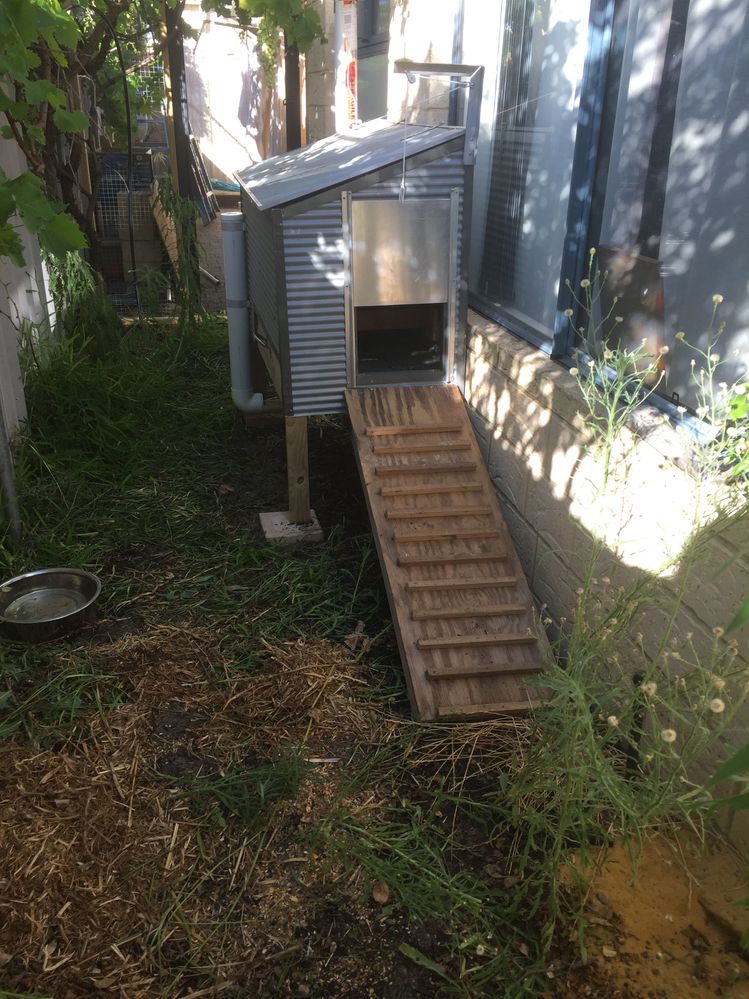

In position and ready to go. The main door slides up and down and can be manually raised/lowered at this stage. I have ordered some electrical parts so I can make this automatic (will cover this in another topic later once complete).
The girls have arrived and only took 2 days to realise where their new home is. They still startle a little but are improving every day.
