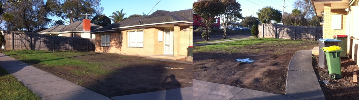

Purchased in 2009 and after the internal paint job was complete (more on this another time) the front yard was attacked. The front was essentially used for parking by previous tenants and quite frankly was wasted space (approx 18 x 9 metres or 160sqm).

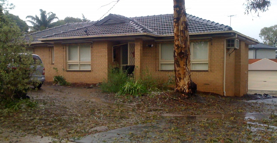

Step 1 - Clearing the canvas - All bushes and the tree were taken down (I am not a fan of cutting down trees - especially a Gummy - but I had Knox council investigate and advise it was a hazard to the structure of the home and the overhead power cables).

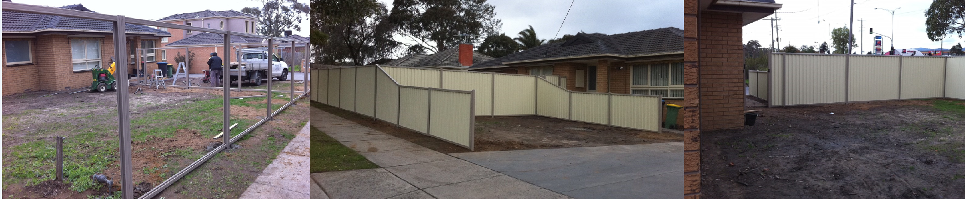

Step 2 - Fence of the area for privacy and security. This was my design and I wanted to ensure there was enough space within the perimeter but also i wanted to add further value to the house by adding space for a double car port (my double garage is actually round the back). I think it came out well!

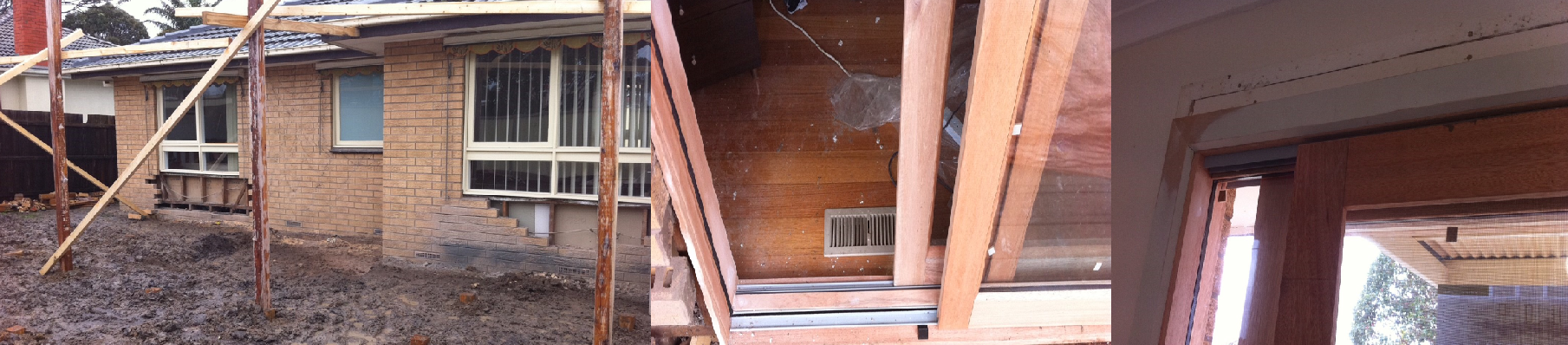

Step 3 - Windows out, doors in. Making bedroom access to what would soon be the front entertaining area was a big decision as it meant more work (and more $$$s). Eventually I decided - "What the hell, may as well!". The front two bedrooms (master and guest) were to have their windows taken out, lower brick work removed then have double sliding, double glazed doors installed. Oh boy!

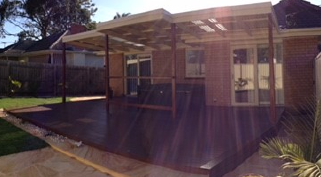

Step 4 - Decking & Pergola. This was the biggest part of the job....yet the one I have the least pictures of due to it being muddy over the 5 week period (we only worked on the weekends for this job). The spa was rolled into place just before we commenced on the the deck and once again this was my design from scratch Once completed it was painted and the deck stained (water based). The end result is below...
And there we have it. A lovely out door area for entertaining! Admittedly this picture is after all the landscaping and paving was completed but I will create a separate section for this and the completion of the double carport.
The entertaining area came to 106sqm and the car port around 45sqm leaving 9sqm extra added onto the pathway to the front door - I will update that project soon.
