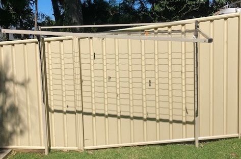

Our son has hung off the right side of the clothesline and it's no longer level. It keeps dropping.
How can I fix this??

Is it possible nothing's damaged? Other then some slight warping of what I presume is thin metal square tube?
Could someone hold the left hand side steady while you push up from the right hand side? May only require a moderate force to re-level?
Hi Jason, the clothesline is still in tact. The right side no longer sits horizontal and slouches down as it seems to have lost its tension. The right side sits a few cms lower.

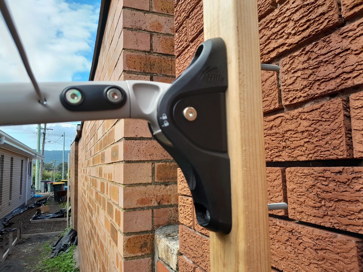

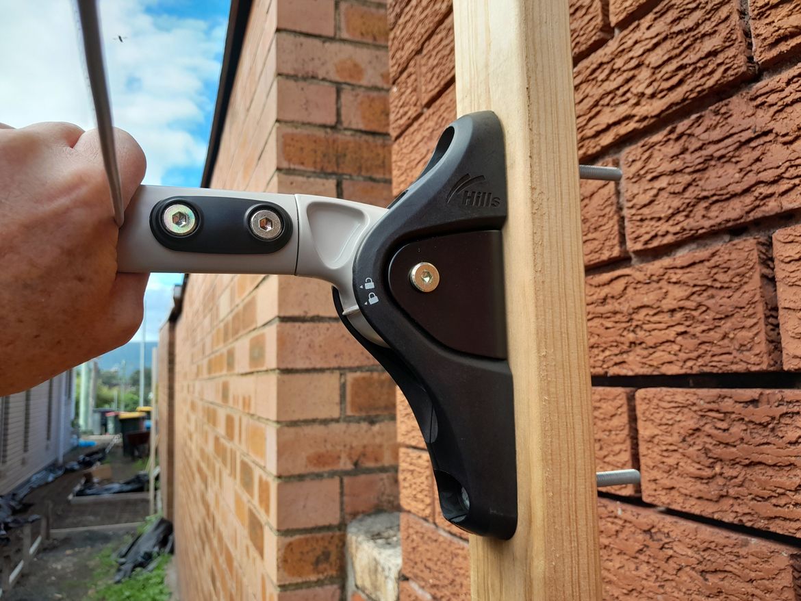

We are in a similar situation. We have a Hills folding clothesline which we bought from Bunnings late last year. On the weekend there was a very high wind which forced the clothesline to fold down. The frame was undamaged but when in the Locked position the left hand side now droops because the hinge seems to have been damaged. These photos show that the marking on the LH arm no longer matches up with the Locked icon. As a consequence the usability of the clothesline is greatly impaired. My question is whether there is a simple fix I could try? If not then I will bring it back to Bunnings because it is under warranty and was not damaged as the result of any misuse.
Thanks!
droopingpushed up into the correct position
Welcome to the Bunnings Workshop community @MatthewH. It's wonderful to have you join us, and many thanks for your question about folding clotheslines.
If the internal mechanism has been damaged, it doesn't appear like there is much you could do yourself to resolve the issue. Was it just the wind that caused it to fold down, or did something heavy strike it? I can see that the installation bolts seemed to have pulled out of the wall, though this might be just a trick of the camera. Are you using Dynabolts or normal bolts, and did this also happen during the high winds?
Even though we had some extreme winds, I suspect that you might have had a faulty mechanism, and the winds were just the straw that broke the camel's back. I'd suggest returning the clothesline to your nearest store and having it swapped over under warranty.Please let us know if you need assistance with installing the new clothesline or have questions.
