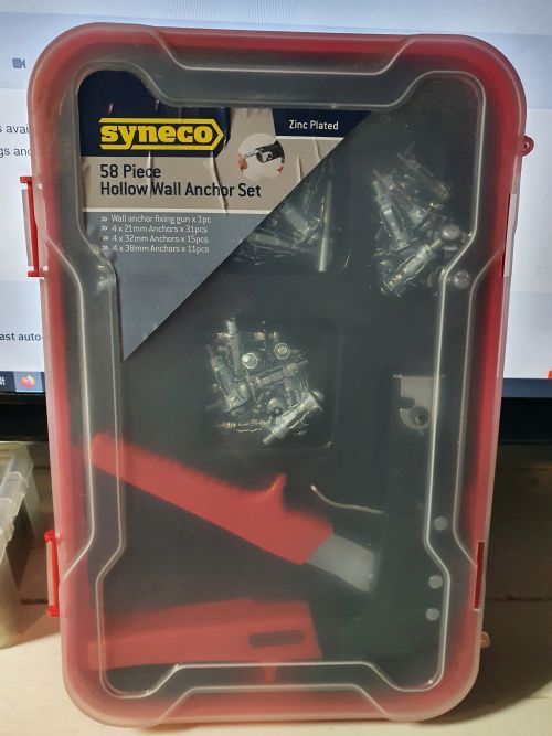

There a plenty of products available to support that weight on gyprock walls.
Just pop down to Bunnings and talk to a staff member in the anchoring hardware section.
Personally, I like the expanding anchorage system. Bunnings were selling this kit for only $15...
Syneco Hollow Wall Anchor Set
