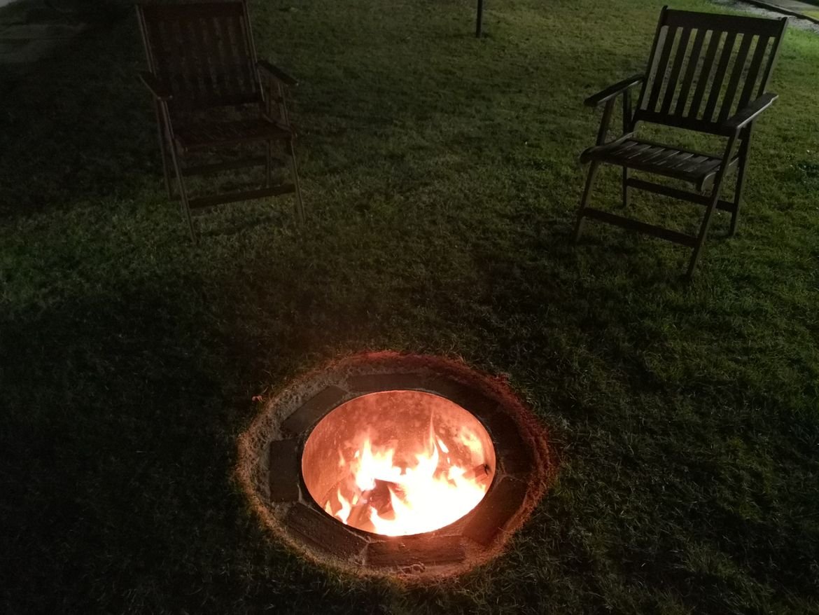

This clever backyard fire pit and barbecue uses an old water mains cutoff to create an outdoor entertaining area you can mow right over.

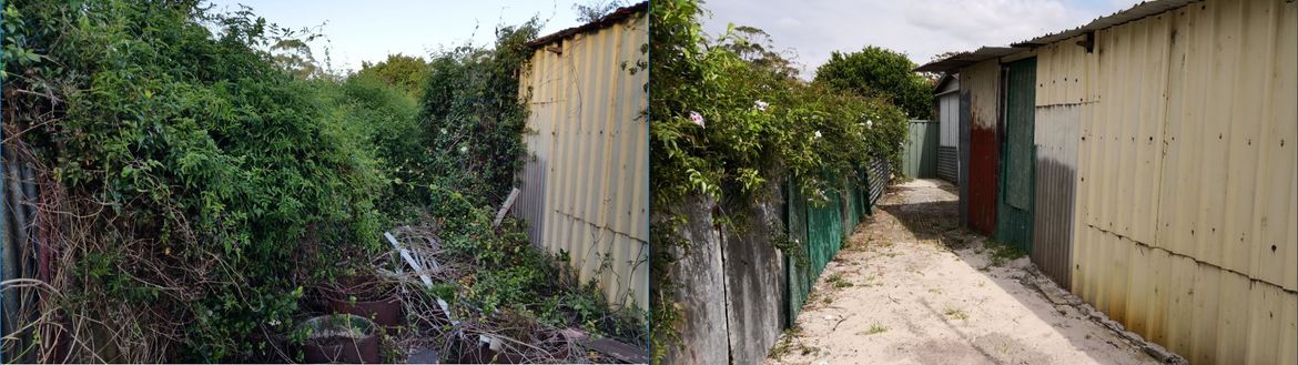

When I bought my first (and probably only) house a few years ago it needed a good yard clean-up, among a lot of other stuff.

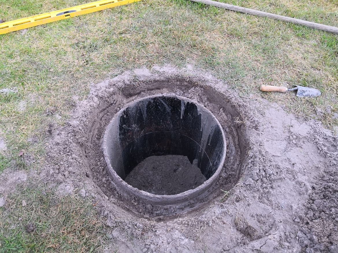

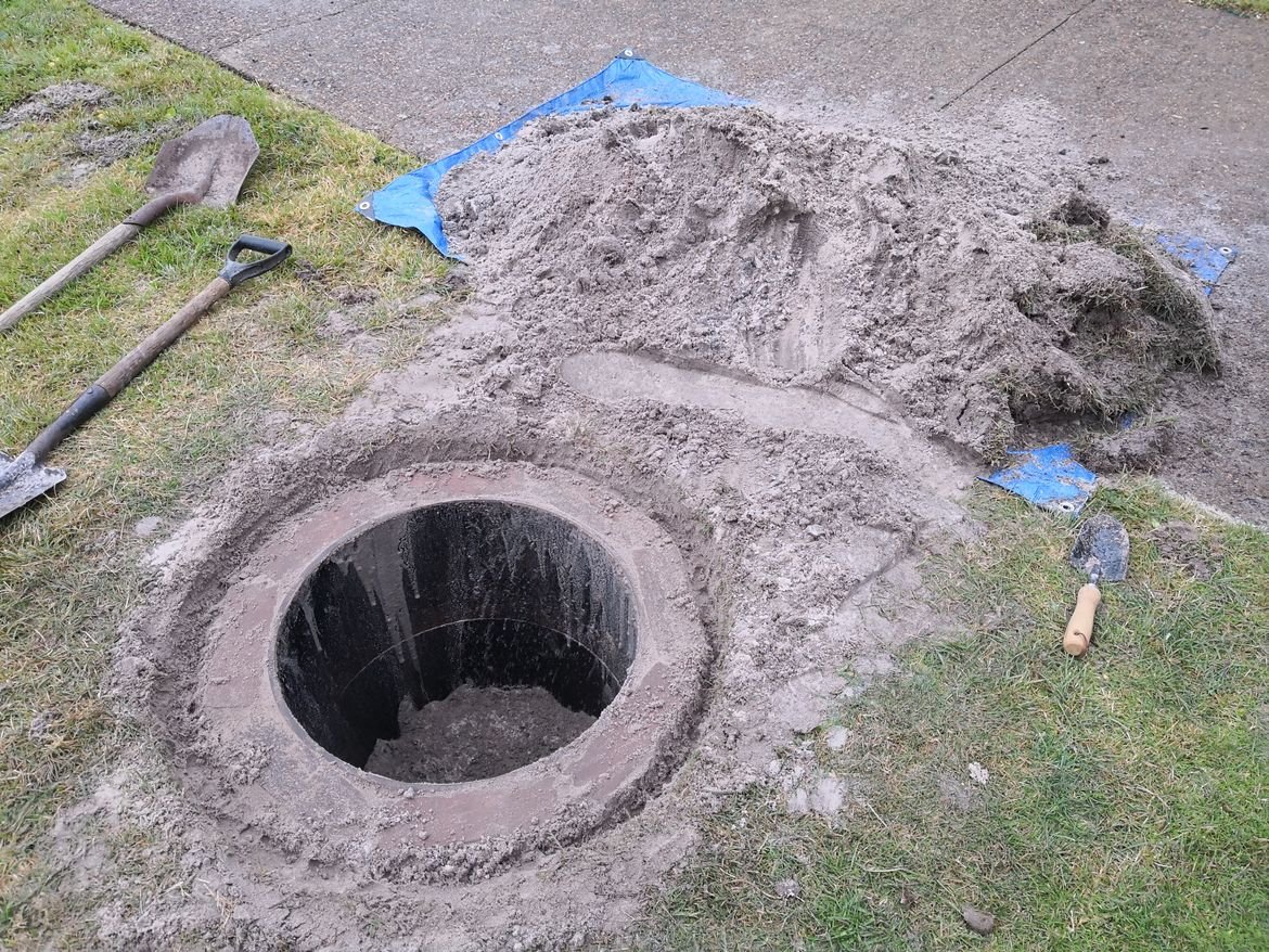

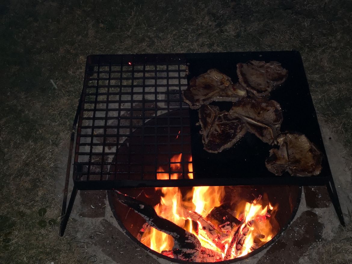

I discovered some old water mains cutoffs underneath the jungle behind the back sheds. I always wanted a fire pit and wood barbecue, so I worked out something just with what I had laying around.

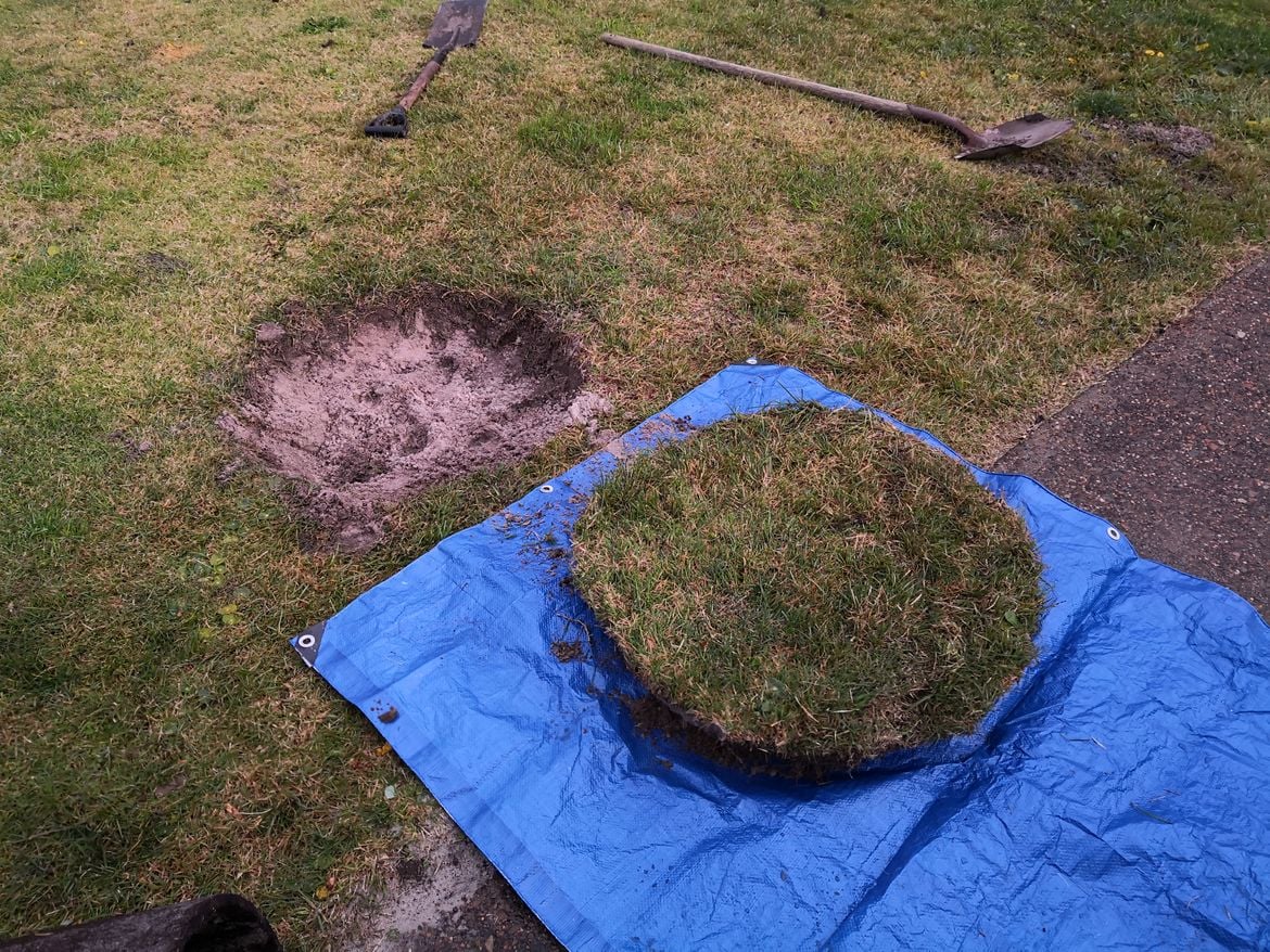

I laid the pipe on the ground sitting upright and started using the shovel around the outside of the pipe to make sure I got a nice circle.

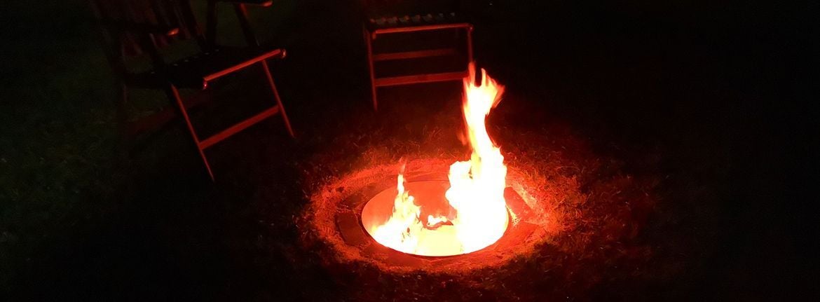

I was a little worried about airflow for the fire (it's 60cm plus below ground) and was prepared to install a metal "breather" pipe from the bottom of the firepit to ground level if it was needed for airflow to the bottom but it wasn't necessary.

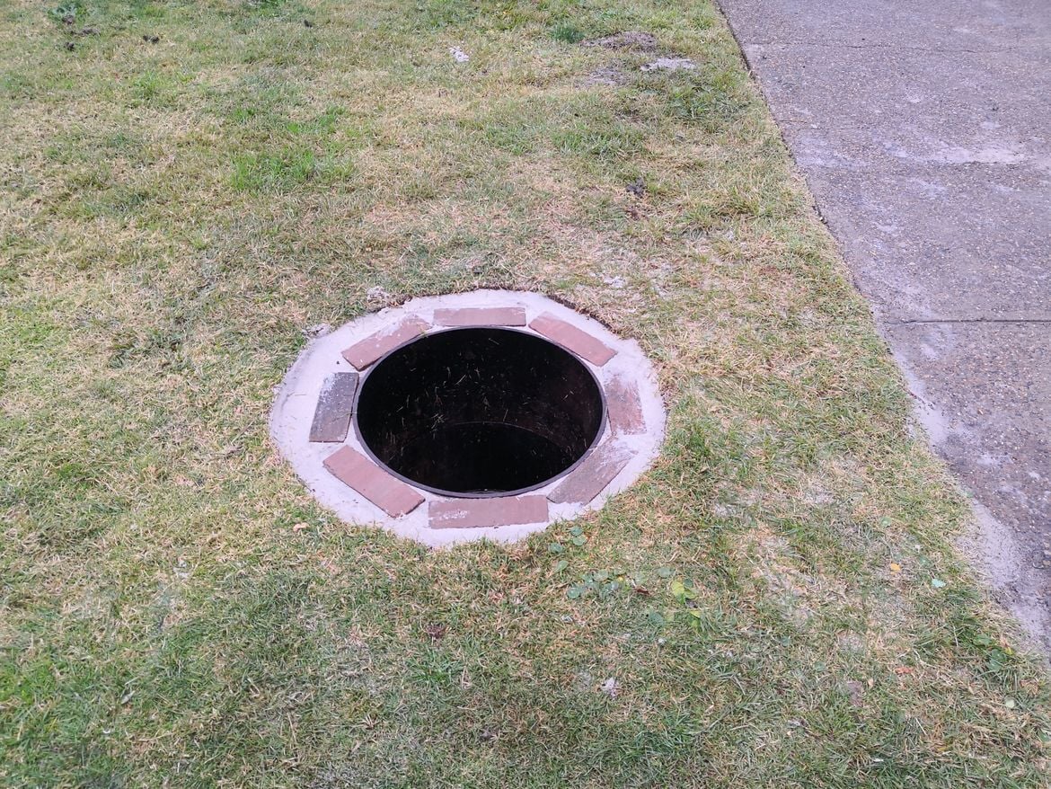

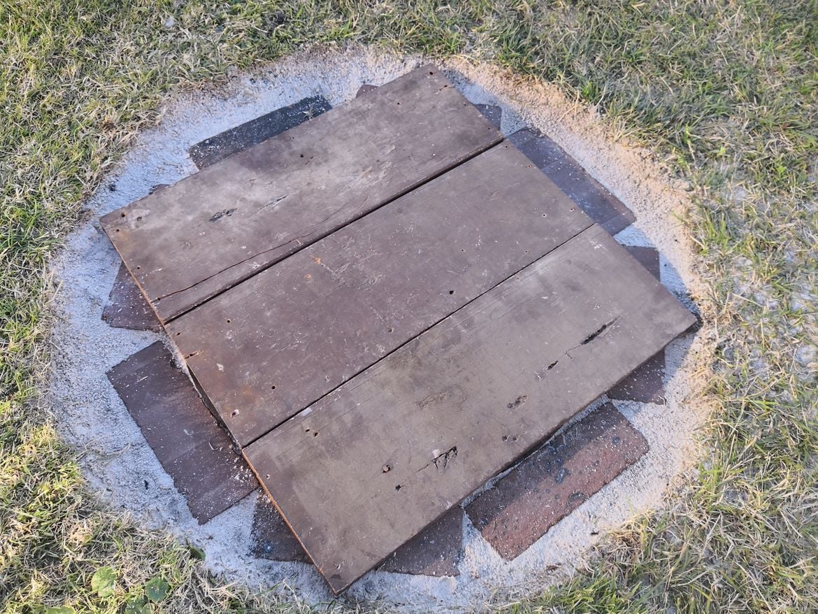

I also made a dodgy wooden cover so nobody falls in and I can just mow over the top.
