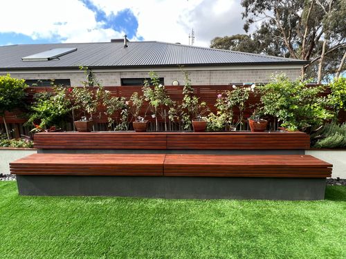

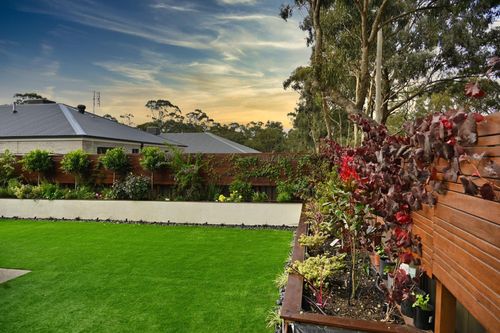

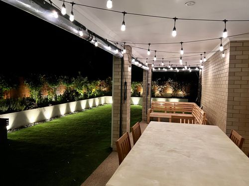

Backyard makeover with fence screening, raised garden beds, water feature and outdoor seating.

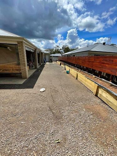

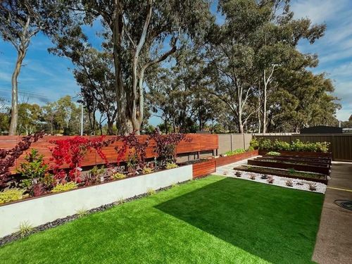

Thank you, Mitchell. Yes, I completed the full project by myself. I followed the following steps:

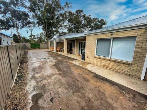

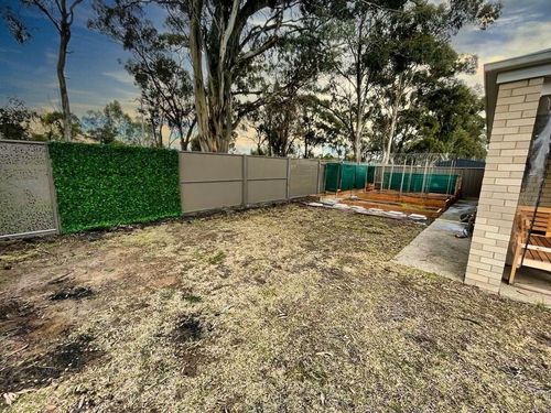

1. Checked with council regarding screening height requirements. Dial Before You Dig enquiry to ensure no utilities are present in the ground.

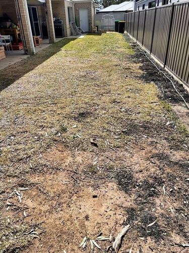

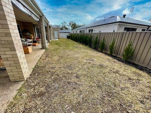

2. Removed old buffalo turf and later used it to fill the bottom half of the raised garden beds. Hired Kanga mini loader to clean up the yard.

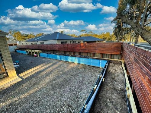

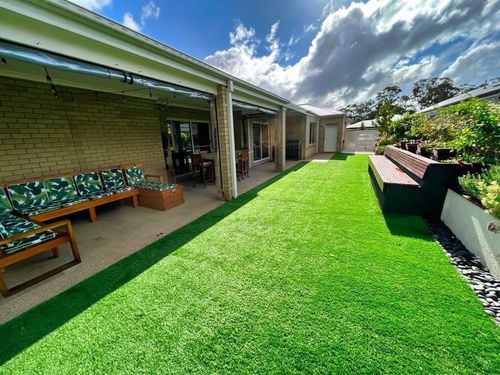

3. Base prepared for artificial turf. 80mm layer using road base and then top 20mm using crusher dust. The ground was graded properly, so I followed it without digging much. Checked ground slope requirements throughout. Used plate compactor 3 times to ensure the base was properly compacted.

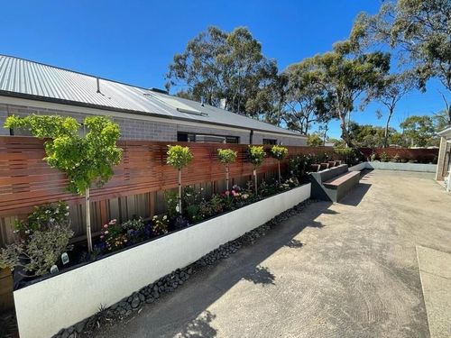

4. Setup H4 treated pine posts using post stirrups. 200 mm from the existing fence. Distance between posts was 2.4Mtr. Used Ryobi post hole digger to dig post holes. https://www.bunnings.com.au/ryobi-18v-one-brushless-planting-and-digging-tool-skin-only_p0090723
5. Connected posts using H3 Fence Rails. https://www.bunnings.com.au/72-x-47mm-5-4m-fence-rail-h3-treated-pine-premium-grade-cca_p0121161
6. Stained posts and fence rails using Merbau stain. https://www.bunnings.com.au/intergrain-4l-merbau-ultradeck-timber-decking-stain_p1520115
7. Fixed Merbau Timber screening using Stainless steel decking screws. https://www.bunnings.com.au/specrite-1800-x-902mm-84-44mm-fence-panel-merbau-slats_p8500281
8. Preparation for staining done using https://www.bunnings.com.au/intergrain-4l-ultraprep-tannin-and-oil-remover_p1560403 and https://www.bunnings.com.au/intergrain-4l-ultraprep-timber-cleaner_p1563243
9. 3 Coats of Merbau stain applied.
10. Raised garden beds made using H4 200x50mm 2.4 mtr sleepers. Used 3 sleepers to get 600mm height. Covered internal sides of garden bed using heavy-duty builders plastic. Cemented approximately 800mm sleeper pieces on the front side to support front wall of beds. Internal cross-support between the front and back wall of the garden bed to prevent bowing of the sleepers.
11. Filled bottom half of garden bed using old buffalo turf with roots upside down to prevent any growth. Covered with biodegradable weed mat. Filled remaining of the garden bed using garden soil and top layer using premium garden soil to give best possible start to the plants.
12. Used blue board to cover the front of the garden bed. Used Dulux texture full cover to get render finish. https://www.bunnings.com.au/dulux-10l-texture-full-cover-exterior-paint_p1371216?store=6174&gclid=CjwKCAjw7IeUBhBbEiwADhiEMctUVQnUxOH1qkZhXTslHSJXGdYkd7tOtTGEnCBm8QF1drqSvsqNMhoC9osQAvD_BwE&gclsrc=aw.ds
13. Setup irrigation with Orbit B Hyve wireless controller
14. Setup garden lighting using low voltage outdoor lights.

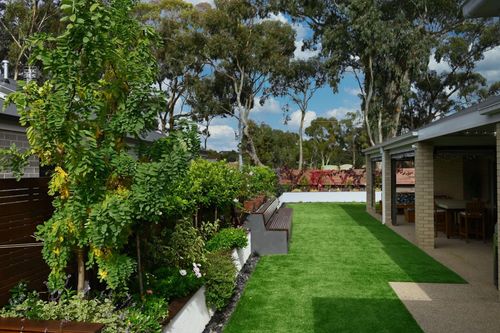

15. Artificial turf installed as per manufacturer's instruction.

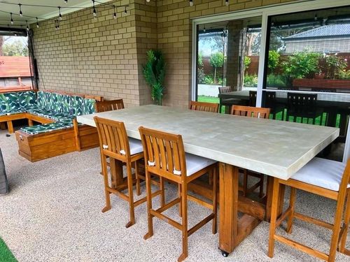

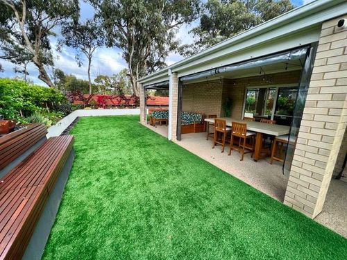

16. Outdoor dining table made from leftover blue boards. Frame made using timber battens, blue board on top and bottom side. Expanding foam to fill empty spaces to prevent hollow noise. Covered blue board using fine coat render to achieve polished concrete finish. Bought outdoor bar stools https://www.bunnings.com.au/mimosa-malibu-bar-stool-with-cushion_p0256329
I hope it helps!

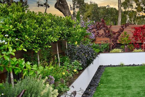

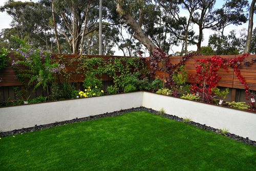

Looks amazing! Do you have a list of the plants used? I love them all

that's a stellar effort, well done. I too love the garden bed, the variety of plant textures and colours, of ground covers and creepers. You certainly have an eye for harmony.
I also like the idea of screening the H4 sleepers, that's a great idea. My only points of thought are the artificial turf (putting aside the reasons for it), as it might introduce micro-plastics into the environment, and the lonely bench sitting in full sun without shade. Do you have any plans of maybe adding a pergola around it?

PlectranthusA few that jump out at me are what looks like a Dahlia with purple foliage and yellow flowers; a variegated Plectranthus; and a Duranta "Geisha girl". I also noticed what looks like a Cycas revoluta or "sago palm" in there.
I think the standard trees (the ones with the lower limbs removed) are some sort of Ficus, but they might be a citrus.
Duranta "Geisha girl"I wonder if one of those red climbers is a Virginia creeper (Parthenocissus).

Hi @staceybe , these are some of the name I can recall. Starting from front to back.
1. Robinia Lace Lady
2. Plectranthus parviflorus ‘Blue Spires’
3. Star Jasmine Climber
4. Variegated Star Jasmine(Sunlover) climber
5. Ficus Emerald in Standard Topiary form.
6. Petunias
7. Daisy
8. Standard Roses with some climbing roses
9. Cordylines
10. Campanula takesimana (BellFlowers)
11. Lilies
12. Lavenders
13. Variegated Lavenders
14. Sea Lavenders
15. Dahlias
16. Cyclamen
17. Duranta repens white & purple (Geisha Girl)
18. Sago Palm
19. Natives with purple flowers ( Couldn't remember the name)
20. Magnolia figo
21. Teddy Bear Magnolia
22. Leonard Messel (Magnolia)
23. Ornamental grape vine
24. Japanese Maple
25. Pink Cordylines
26. Black and Variegated Mondo Grass
27. Mandeville Climbers ( Red and white)

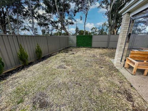

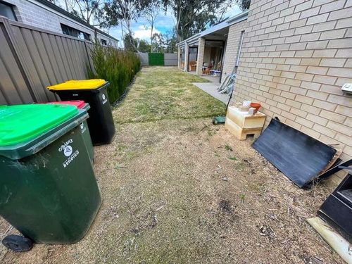

Thanks @TheHandySqirrel for kind words. We had buffalo grass before and it was not growing as it should be. Soil preparation wasnt great underneath and big gum trees next to the boundary was not letting it grow. Spent almost a year to revive the grass and in the end decided to go with artificial turf.
We have good covered space for entertainment and wished to make open outdoor seating so did not covered it with pergola.

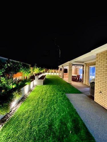

Thank you so much for sharing that plant list you used in your backyard makeover. I'm sure @staceybe and our community members will find it very useful. Your garden makeover is truly awesome and looks fantastic even at night. I'm sure your family and friends will enjoy this relaxing environment you've created.

I have a newbie question if I may, for your steps below, I am assuming this is to put up the Merbau Timber screening. Can you elaborate on these two steps please? I can't see any pictures from the back near the fence, so just want to see what you have done here. Could it be possible to screw the H3 fence rails to the garden bed treated pines?
Welcome to the Bunnings Workshop community @mainb. It's splendid to have you join us, and many thanks for your question about this wonderful project.
Let me mention @SmileDesigner to alert them to your questions, and hopefully, they can provide more details.
It does appear that they've installed posts along the fence line, and the screening was fixed to them. You could screw H3-treated framing timber to the garden bed sleepers instead. However, it would be a little difficult to do as the framing timber would be behind the garden bed, and you wouldn't have access to fix it into the back of the sleeper.
