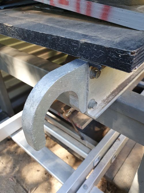

I have a plank with hooks.

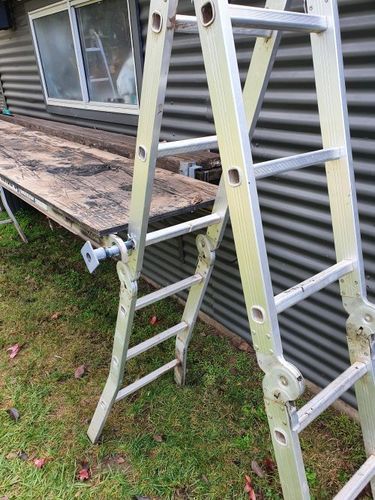

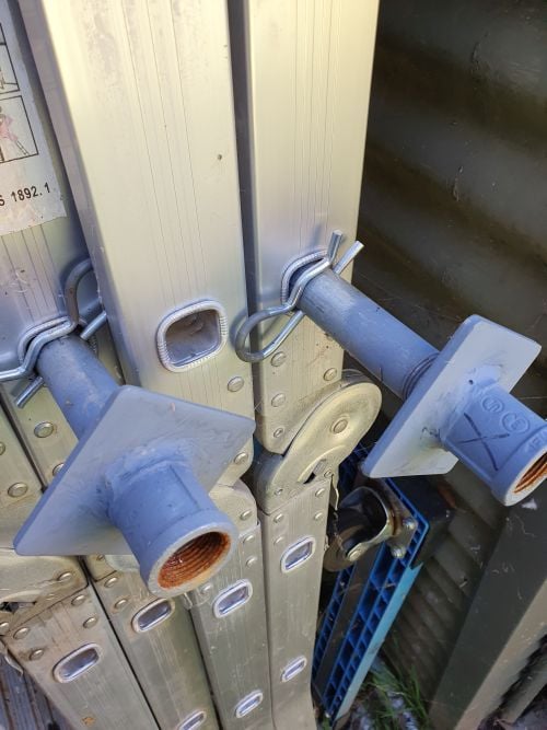

I then found pipe which fits perfectly within the A-frame aluminium ladder rungs.
Insert clips to keep them in position.
And then add ends - which with the clips can be removed and the pipe moved to whatever height rung you want.
Hope that makes sense.
It works. 😉
