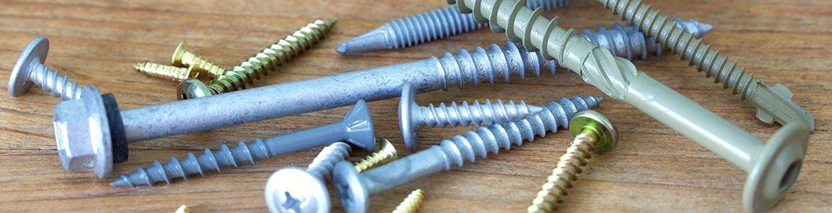

Durability and appearance
Screws come in many different kinds of metals and finishes. In most cases the finish is not merely cosmetic: it is determined by the kind of metal the screw is made from and the type of surface treatment it has received. This determines what the screw can be used for, and how durable and resistant to corrosion it will be.
It is important to be aware of material compatibility issues, too. Some galvanised screws will be rapidly corroded by certain types of treated pine, while stainless-steel screws create a reaction when used in Colorbond metals, causing accelerated rusting of the metal sheet. If in doubt whether your screw is compatible, please don't hesitate to ask the Bunnings Workshop community. We're here to help.
Here are some common types of screws you will encounter:
Plain steel
Indoor use only. Not often seen today, these screws were used indoors for hinges and cabinetry and would typically be painted over to protect them. They corrode very easily.
Zinc plate
A zince plate screwIndoor use only. Zinc provides a shiny silver finish but little corrosion resistance. Zinc plate screws are often used in flat-pack type products. Avoid use in humid areas such as bathrooms and laundries.
Gold passivated (gold zinc)
Indoor use only. A special treatment gives the zinc a gold finish, making it a little more corrosion-resistant. Gold passivated screws are more suitable for cabinets in bathrooms and laundries than plain zinc screws.
Galvanised
Indoor and outdoor use. Galvanised screws are silver-grey, often with a slightly rough textured appearance. High level of corrosion resistance. Can be used anywhere outdoors and ideal for wet areas indoors. May be unsuitable for use in some treated Pine.
Coated
Indoor and outdoor use. Climacoat is the most common of these treatments. The coatings give the screws a grey or dark brown colour and better corrosion resistance. Most coated screws are ideal for treated Pine as they resist chemical corrosion. The coating also makes them easier to drive.
Stainless steel
A stainless steel screwIndoor and outdoor use. Stainless steel screws have a shiny silver finish. Maximum corrosion resistance, even in marine environments. Ideal for use in decks near salt-water swimming pools. Take care when driving as they can snap if overdriven. Don’t use them with Colorbond-type metals as they will cause rapid corrosion.
Coloured finish
Use varies with product. There is a range of painted and powder-coated screws for various situations, including coloured head gold passivated screws. Some are simply painted-over zinc intended for indoor cabinetry. Others are powder-coated over a galvanised finish to match Colorbond metal sheeting products for outdoor use. Ensure that your screws suit your application (ie, indoors or outdoors), and drive them carefully to protect the coloured finish.
Bronze
Specialised uses, most often boating or traditional cabinetry. Highly corrosion resistant. Rarely used in the home unless needed around swimming pools or in furniture restoration. Examples include bronze hinge screws.
Bronze and brass plated
Indoor use only. Low corrosion resistance. Generally only used for a vintage look, for example when securing exposed hinges in a rustic-look kitchen, or where the colour matches the timber.
