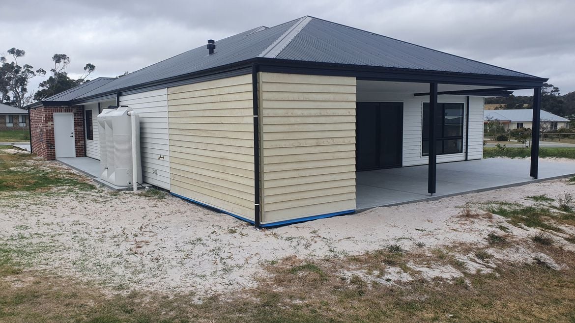

Here is another project at the new house.

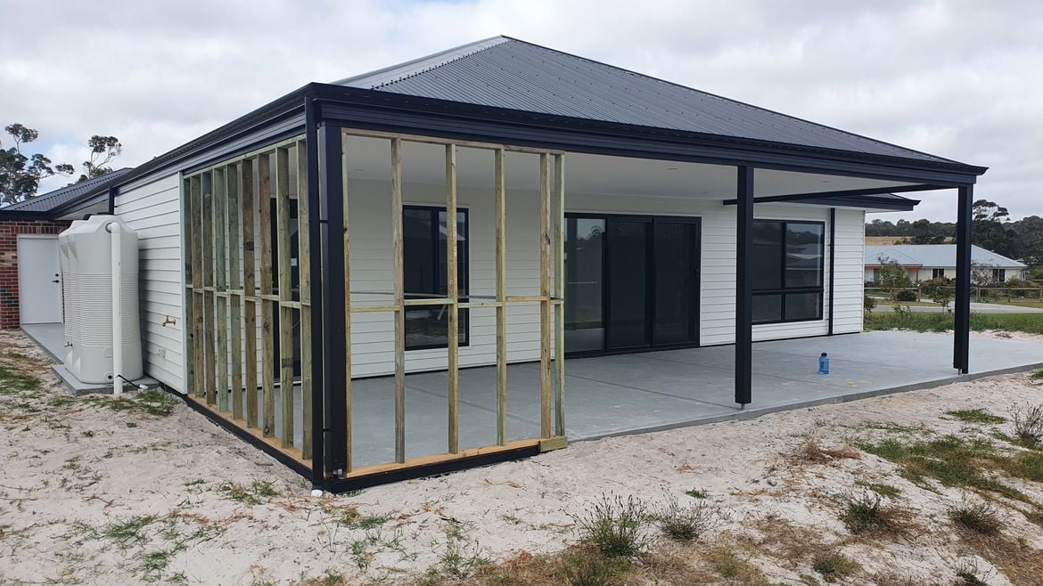

We have enclosed a corner of our alfresco to help keep the weather out and make it a bit more private plus we will be putting cupboards and bench through here too a bit later.

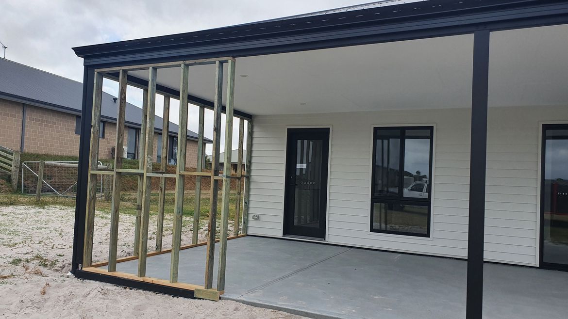

I made the frame out of 90x35 treated pine. If you are doing something like tis make sure you use H4 pine for the bottom plate of the wall frame.
Once the frames were made I stood them up and bolted them into the concrete the bugle screwed them into the wall/posts/beams.

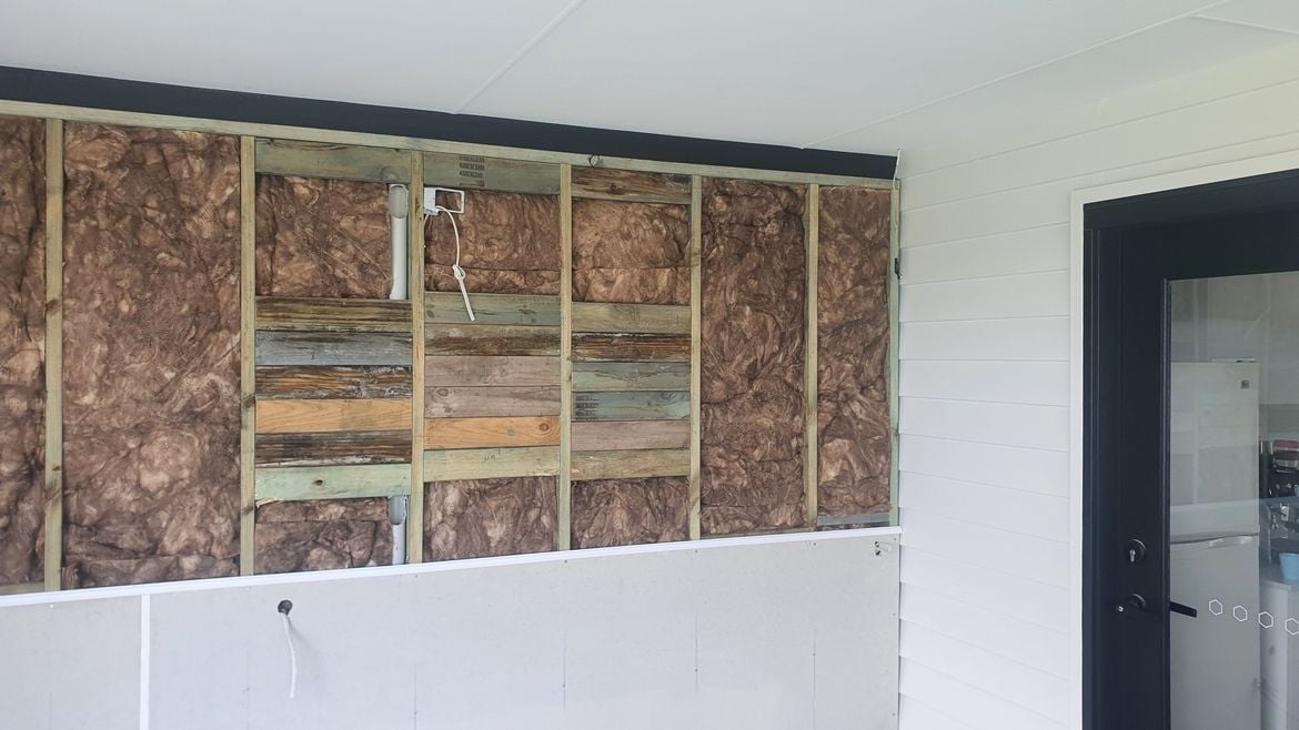

I then wrapped the frame with the blue builders wrap and began cladding. I used the same cladding as the rest of the house to match it all in.

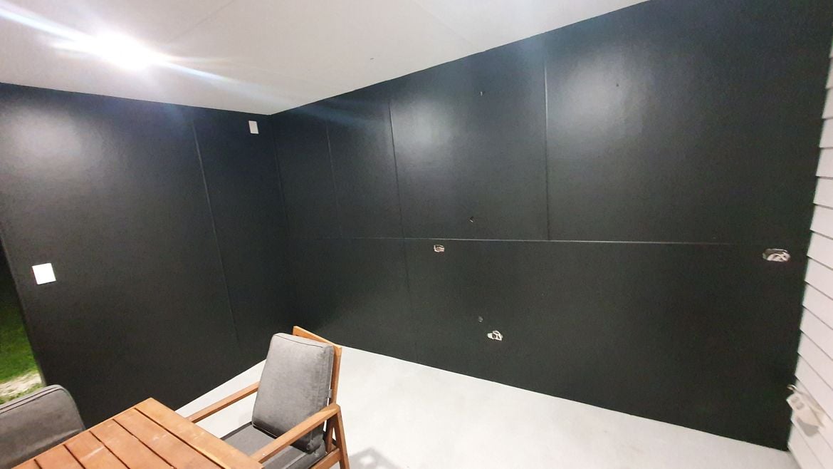

This side of the house gets all the afternoon sun so I also insulated this wall before lining the inside plus put some blocking and wiring in for a TV/sound bar. All I used to line the wall was 4.5mm fiber cement sheeting.
And lastly was paint.

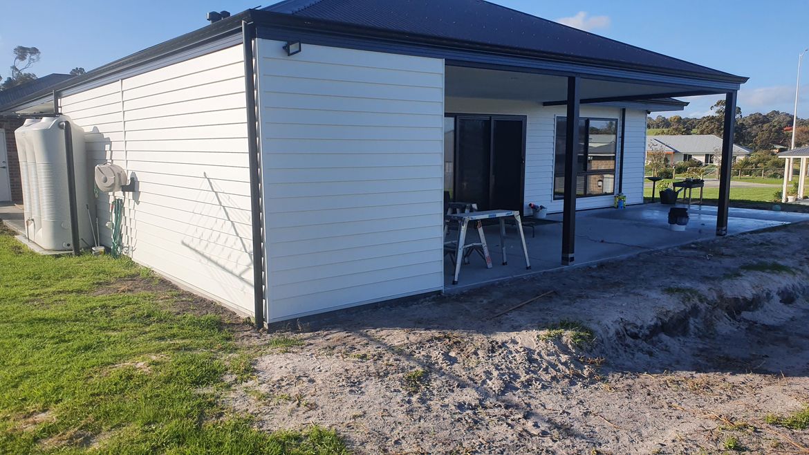

To look at it you would never know it was added on.
Cheers
