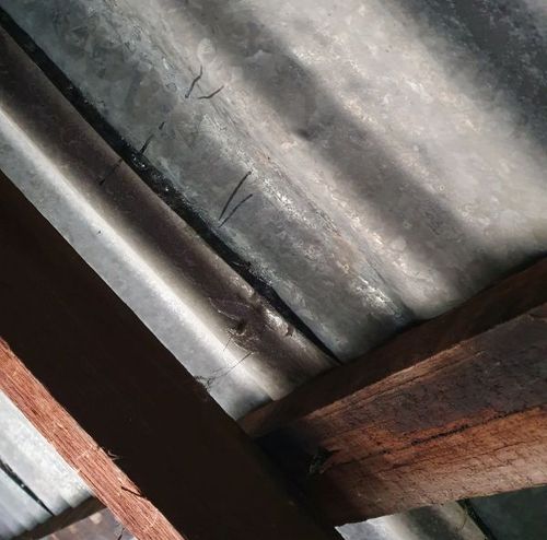

Morning Michael. I'm with Eric here - sorry to hear your roof is leaking.
My corrugated iron is very old. I wish I could replace it - but financially this will never happen.
Over the years we have had leaks. Discovering where the rain is leaking from exactly, is very difficult.
Water is incredibly elusive and where it drips in the house/shed is not always where it's entering the roof in an imagined vertical line.
Ridiculous as it sounds - when it rained I climbed into the roof with a torch - and tried to locate the entry point.
Tough going.
I would mark areas with a pen where I saw water.
When the weather improved I got onto the roof above where I had marked the internal area.
What I found was most leaks were occurring in the length wise overlap of the sheet (one and a half corrugations?)
One of the reasons for this was past humans walking on areas where the iron is not supported.
I blame myself (hand painting the roof in the past), my children and an inept electrician.
I siliconed the area inside the roof - then quickly got onto the roof and pop-riveted the damaged edges down before the silicone could dry.
I also siliconed suspect areas around screws. Over the years I replaced all the roofing nails with Tek screws.
I'm not a professional roofer or plumber.
But so far it's been successful.
Suspect areas marked.
Crumpled areas pop-riveted down.
