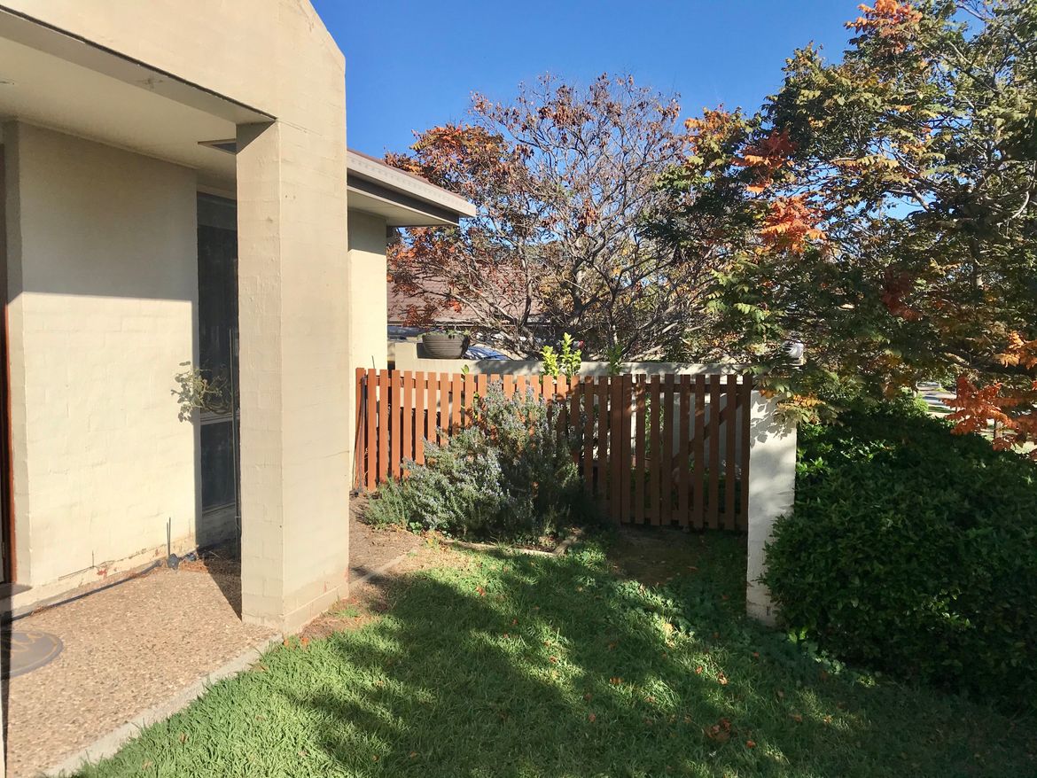

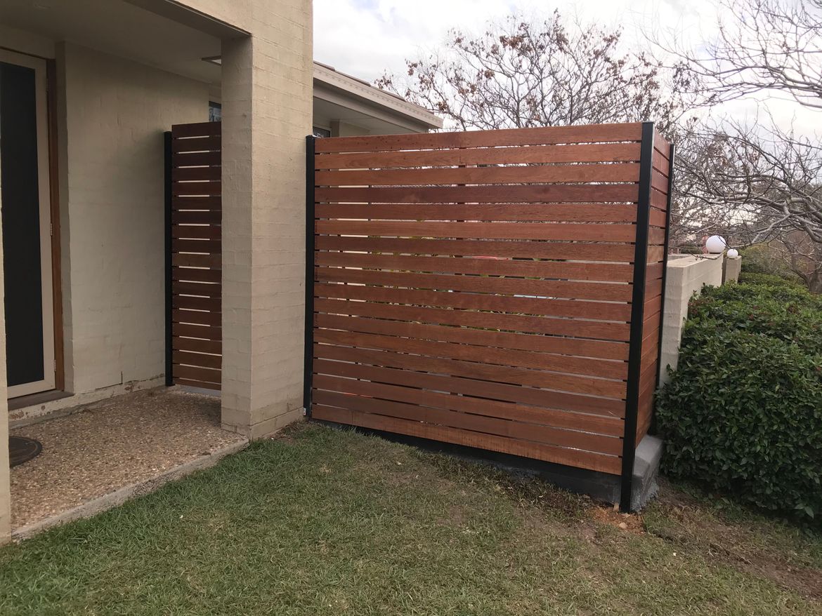

For my first ever building task I tackled a Merbau slat fence around this new slab I just had laid. The purpose was to increase the usability of our courtyard, and so far I am pretty happy.

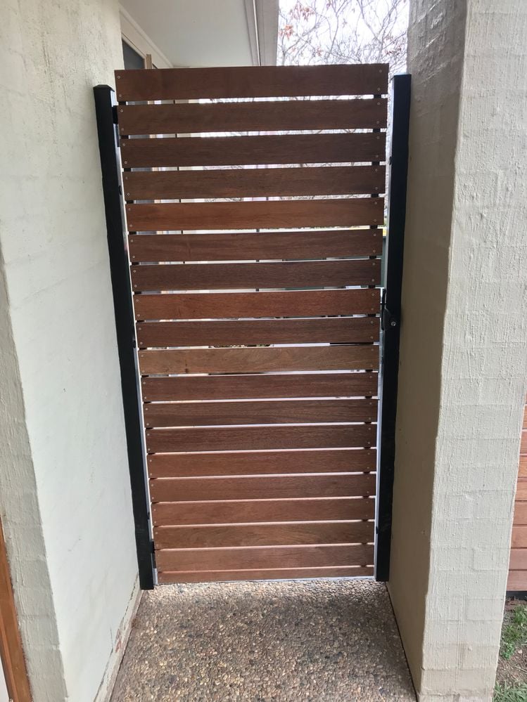

There were a couple of rookie errors with the fence, like not measuring correctly and the top slat being 10mm above the top of the post (a post cap has hidden that somewhat). The gate wasn't level so I had to adjust the slats to level them.
But on first glance it looks good and hopefully most people won't notice unless I point things out. I also want to continue a screen along the front wall for some added privacy.

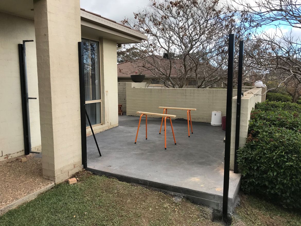

Here's the courtyard before I started.
Slab and posts put in.

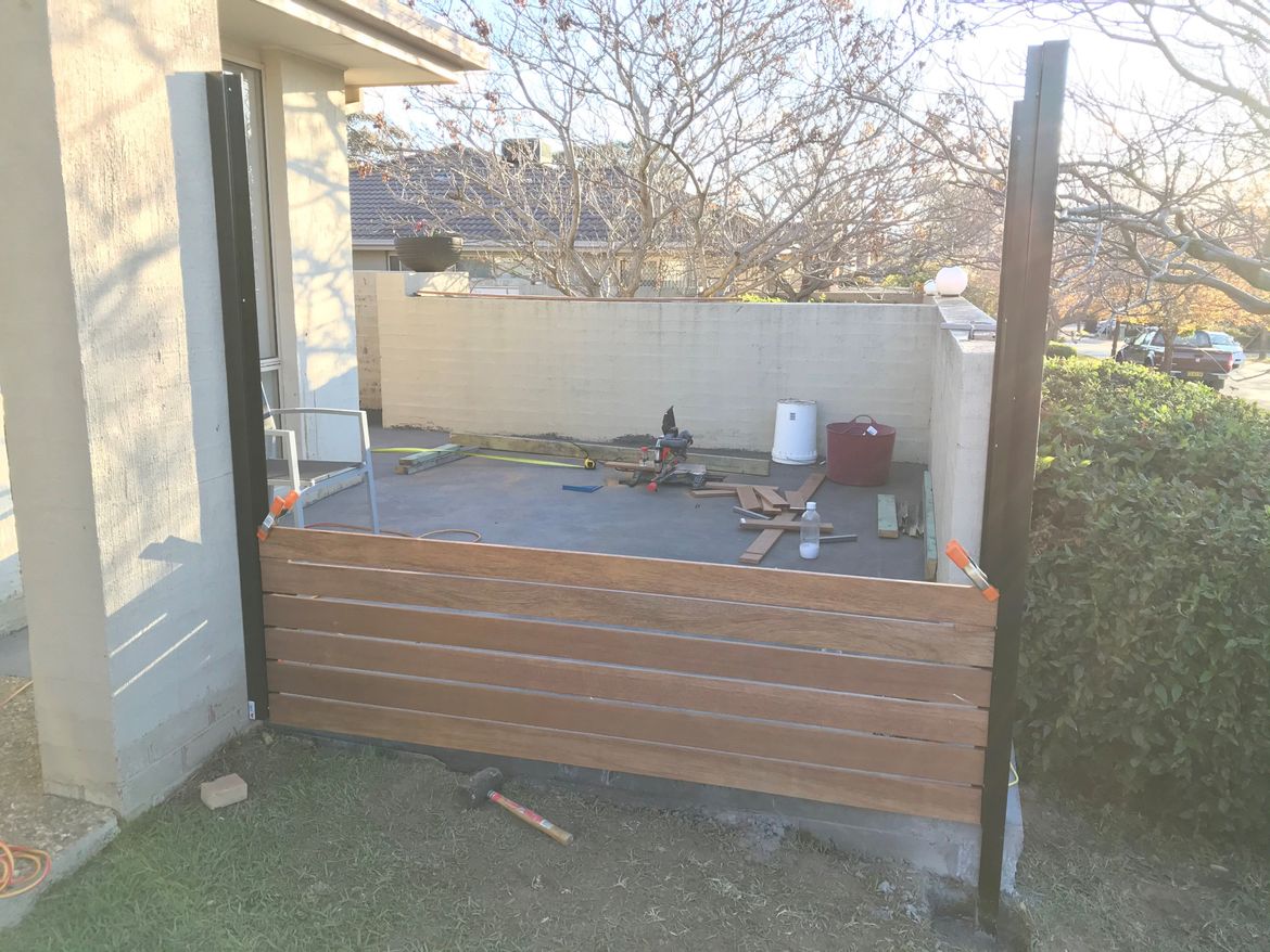

Happy I got to buy a drop saw.
The side gate.
I used 50mm steel posts. I was going to use aluminium but they didn't have enough in stock. I just tacked some 20mm angle on each post so I could secure the slats from the rear so you wouldn't see exposed screws on the outside.
