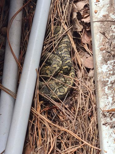

First off before anything you want to have a good walk around your yard and look for anything they could be hiding under or making a nest under, they are very quick to make new nests where they can. Carefully lift items for 2 reasons 1. You don't really want to disturb them and make them run rather come back with some bait and place it near the nest so that you wipe them out. 2. There might also be a visitor of the snake kind there and yep it happened to me right beside a rats nest luckily only a 3ft python with a rat in its belly already.

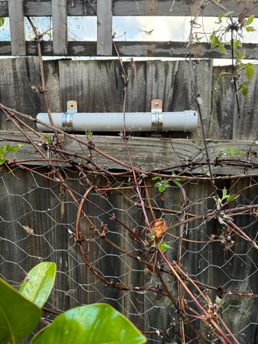

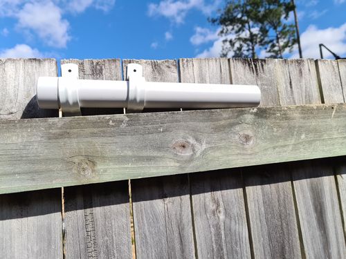

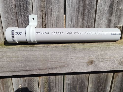

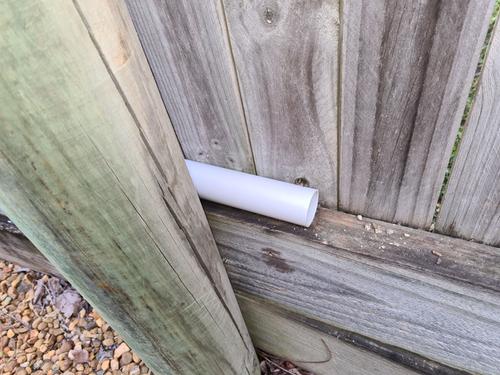

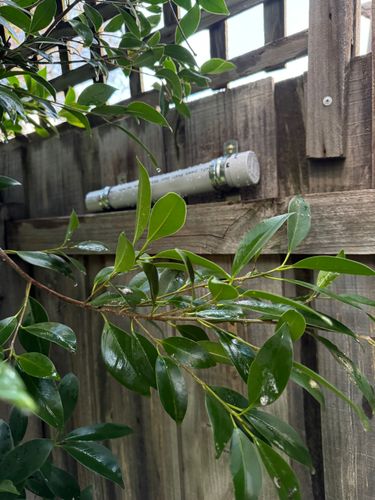

I used a 1m piece of 40mm pvc plumbing pipe which I cut in thirds using a hack saw.
I capped 1 end of each pipe with a 40mm pvc end cap per pipe
I then purchased some 40mm full saddles though I used 1 or 2 per pipe depending on if I could slip it behind the rail or not.
I put some pet friendly rat poison in each tube not filling it up just enough for a small meal for a rat.

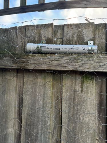

I then found the best place on the rail where the saddle would slip behind and hold the pipe in place with a slight downward angle as pictured.
This method works I have picked up a few rats from it and I have no other baits set.
