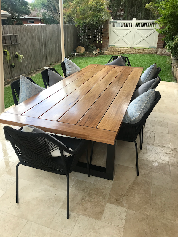

Was in the market for an outdoor table, was unimpressed by recent non-deliveries from larger furniture stores, and thought I'd have a go myself. Took 2 months of research and 4 months to build, but went all in on the Bunnings stack. Did try my local small timber dealer, but they weren't interested in dealing with me for a small order. Had a great experience with Bunnings special orders to get the F27 Boral Hardwood for the top.

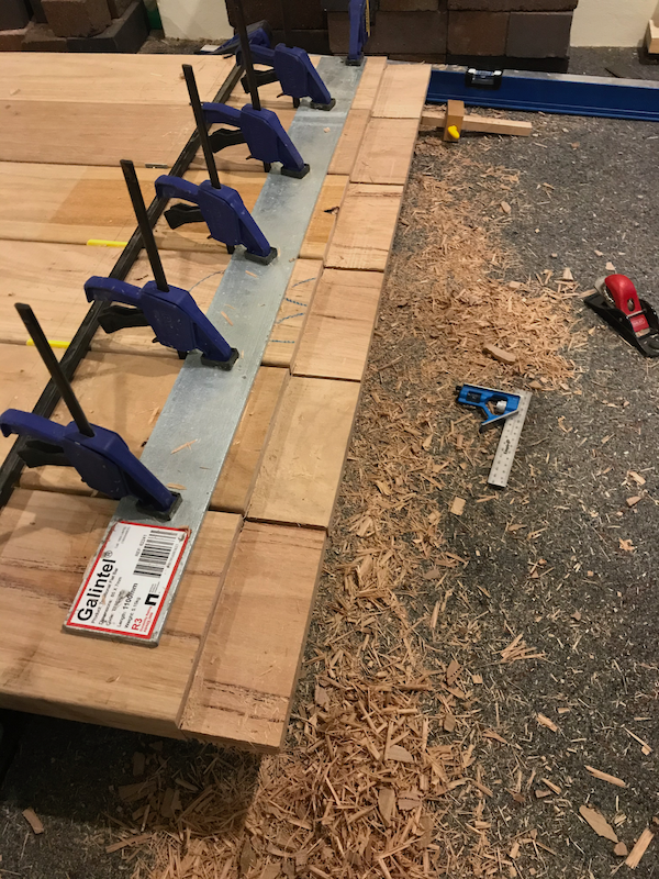

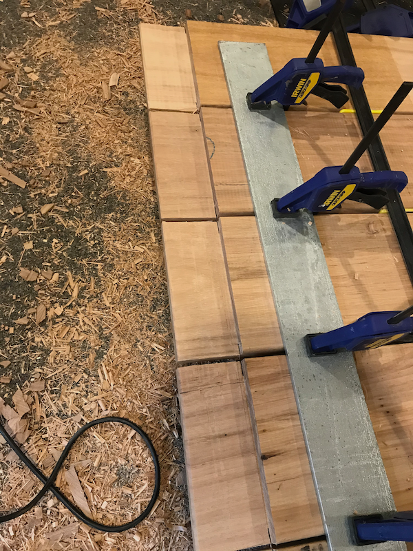

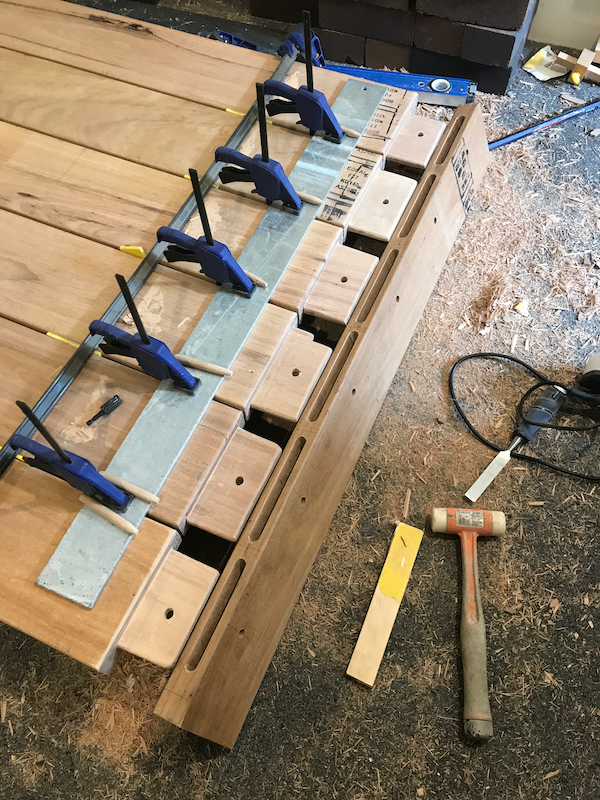

Definitely my largest project to date, but wanted something that would last, to learn some new skills, and to try out some traditional joinery and avoid using any screws (and maybe save some money - lol). Didn't have the greatest workshop, spent a LOT of time on the ground using hand tools (each length of hardwood weighed ~30kgs, total weight for the table is around 220kg), but happy with the result.
It has been outside for a year now, holding up extremely well.

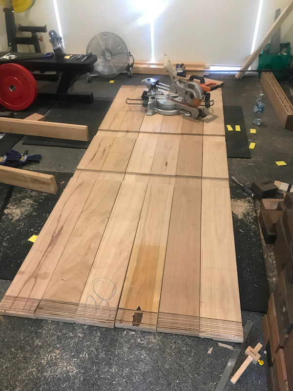

3m x 190mm x 45mm F27 Boral blackbutt (x6) - for the top
