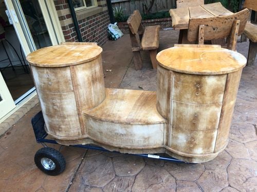

I wanted some new bedside tables, and when I saw this ratty old dressing table for sale online, I knew that it had the potential to become just what I wanted.
The first step was separating the parts, the base skirting was very damaged, so I completely removed it, salvaging as much of the useable veneer as possible. The centre unit was tricky, having been glued and nailed in place, but with a lot of patient prising it eventually came away leaving me with 3 separate pieces.
Where the centre piece joined the two banks of drawers, there was no side, just a big gap. On both drawer units there was also a slit in the veneer about a third from the top towards the back. I had some salvaged old plywood that was a similar colour to the veneer, and was flexible enough to be bent to fit the sides. It took a bit of time and fiddling to get it all lined up, but it was worth it. To cover the join between the old and new pieces and also to cover the slits, I made some detail pieces from the salvaged skirting veneer and glued them in place.
I found some vintage Bakelite handles online, they are a little larger than the original holes, so I filled the old holes and drilled new ones.
Both units had loose and lifting veneer, so before I could sand them, I had to spend a considerable amount of time glueing down lifted pieces and replacing damaged or lost pieces, luckily the salvaged skirting had enough useable material to do this.
Finally I could start carefully sanding, using 240 grit. Just enough to clean off the old finish, but not damage the fragile veneer.
The drawers themselves were in good solid condition and just needed cleaning up.

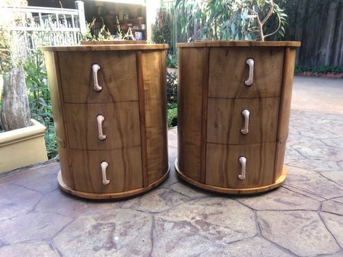

I’ve finished the units with 2 coats of oil based varnish for a tough wearing finish and then installed the new/old handles.
I was pretty happy with how my new bedsides look 😊
