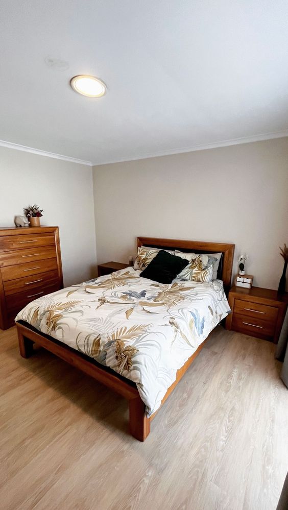

Simple to build and made with materials all sourced from my local Bunnings.
See below for the before photo of this project and keep reading to find out how you can achieve this result for a surprisingly low cost.
I'm going to walk you through step by step from the start to finish of this DIY project.

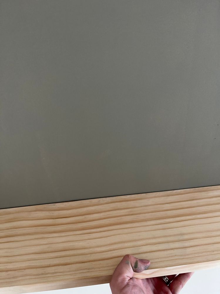

Before I fully committed to this depth and timber type I tested it by holding it up against my paint colour in the room.

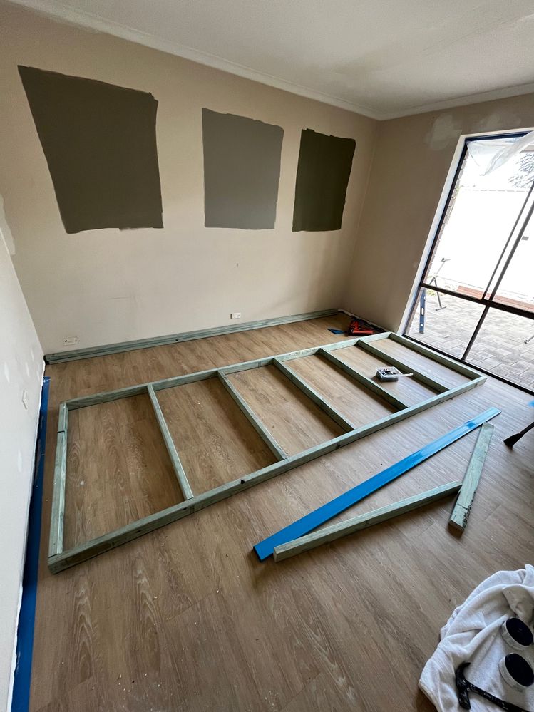

I started by building the first frame on the floor to make it easier to nail in the studs.

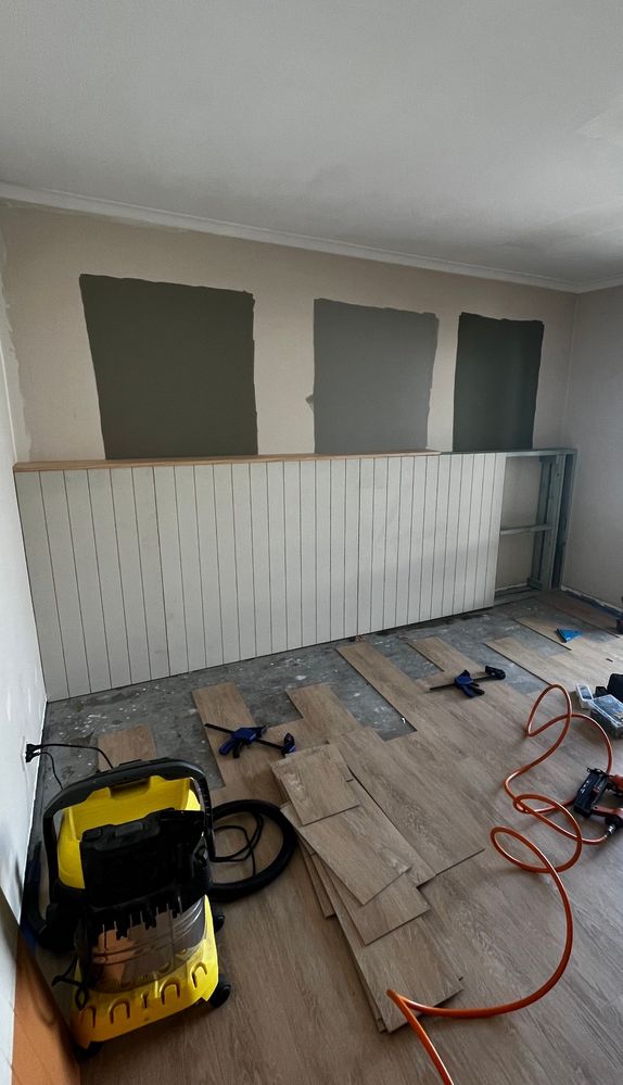

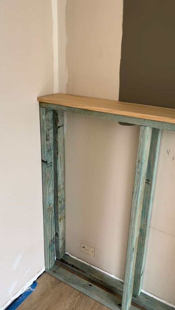

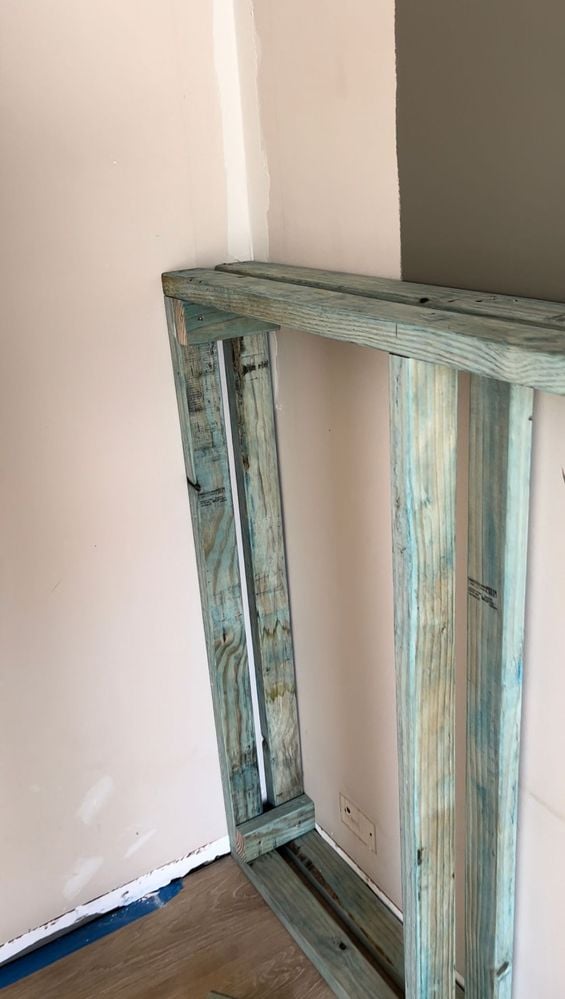

This is what the two frames looked like against the wall before adding the block spacers and noggins.
You can see how I tested my timber piece by placing it on the ledge top to check I was on the right track with the frame.
I also had a scrap piece of VJ panel which I checked on the front to ensure I would achieve the 5mm lip.
Next I cut my blocks at the depth that I wanted my frame to be which was 170mm.
I then nailed the blocks in on the top and bottom to join the two frames and maintain the correct depth as below.
I then added in the noggins as per the recommended 450mm height/distance.
With noggins its best to offset them so that you can still nail from the other side.
The noggin is a horizontal timber between the studs to support the space behind the panel.

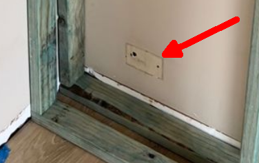

Extra tip: Before bolting my frame to the wall I removed my flooring around it, so that the frame would sit on the concrete. You can skip removing the flooring if you want the project to be easier.
I bolted my frame to the wall using the easy Ramset AnkaScrews
You can also see how I nailed a stud in that would sit flat against the wall, one on either side and one in the middle. This was to allow for a point where I can put my fixings from the frame, through to the wall.

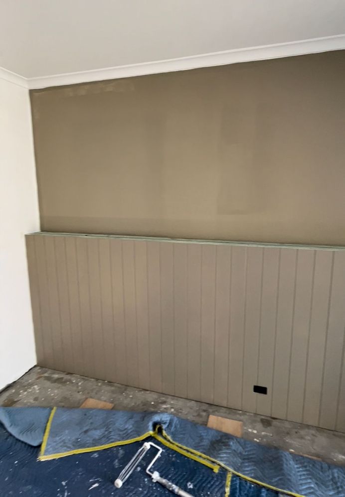

Now its time to paint!
I painted my panel and the wall behind it before putting my timber top on to get those nice crisp lines.
You can see below that the top hasn't been installed yet, keep scrolling to see the result of installing it after painting.

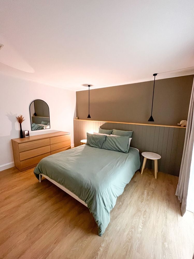

The result:

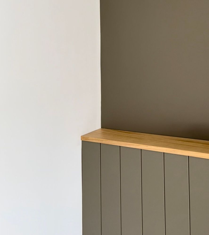

Now with the top, I had a long distance to cover at 3900mm wide.
Dressed timber in the 184mm does not reach that distance. So I purchased one of the longest lengths and then a shorter one to make the difference. I cut a 35 degree angle on the flat face of both pieces to make the join and it worked out well.
I simply adhered the top on using Selleys Liquid Nails and put some weights on top while it dried.
For an extra precaution I also put some Gorilla Wood Glue on the join to ensure it didn't seperate over time.
I didn't want to nail or screw the top because I wanted that extra clean look. Its holding up well and isn't going anywhere anytime soon.
