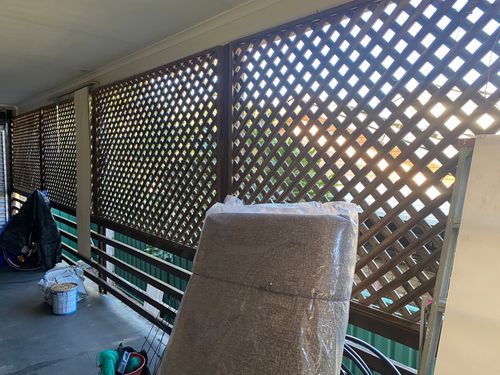

I’d like to know how I can enclose one side of my carport. So I can store things in it without it getting destroyed by the wind, dust etc.
