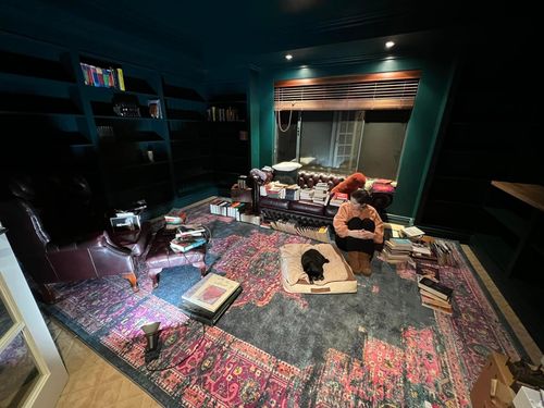

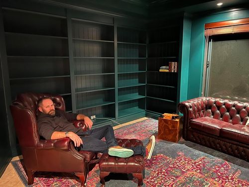

My wife asked me to build her private library room for her 40th Birthday. I think I nailed the brief.

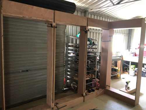

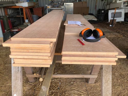

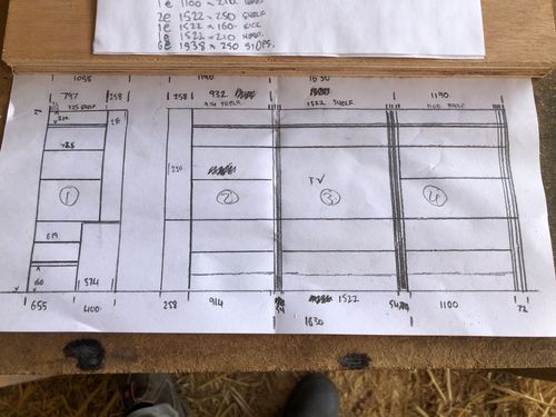

I don’t use fancy computer systems to draw up anything I build, I find it easy to just draw it with a pencil on paper. I always workout a “cut list” to work from to purchase the correct amount of materials and minimise wastage when cutting.I used a Ryobi table saw purchased from Bunnings a few years ago to cut the 2400x1200 18mm sheets of plywood, this was a bit tricky to manoeuvre the sheets on but it did the job.

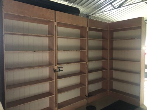

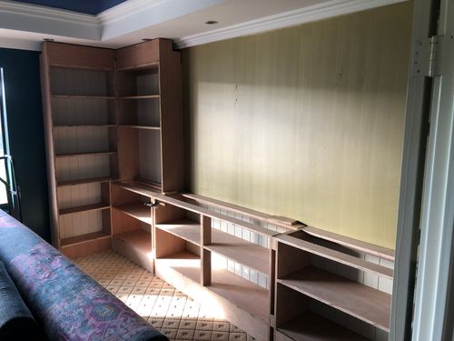

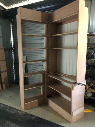

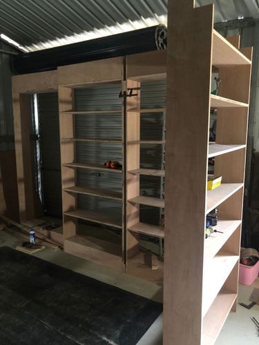

I also purchased a Ryobi slide mitre saw so that it could cut the full depth of the shelves. It is easier to cut them on the mitre saw than trying to do it on the table saw. The carcass of the shelves where built first and the Vgrooved back sheets where pre square cut so I could use them to square up the carcass when fixing them on.

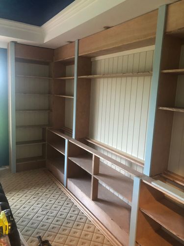

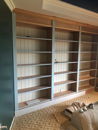

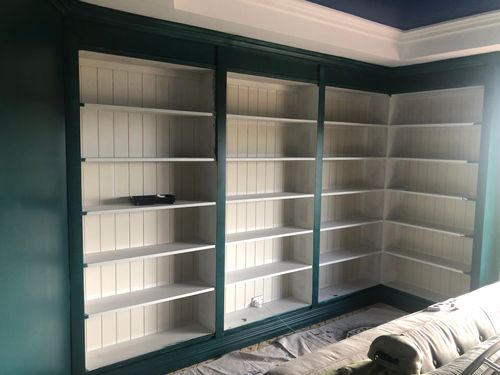

I put in a 50x18 rail at the top to use for fixing them to the wall when installing.Drilling straight through the rail and into the brick with a masonry drill bit and knock in the green wall plug.

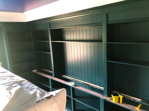

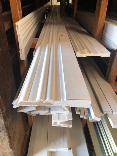

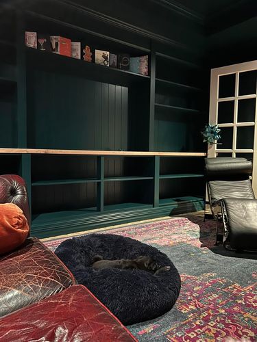

Once all the units were screwed in I used design pine on the front edges to cover the cut plywood. Easy pva glue and nail them on once cut to size. The skirting is colonial 130mm preprimed mdf. The crown mould (cornice) is colonial pine.All the cupboards were primed with simple water based Dulux wood primer and finished with Dulux Licorice Green. They were painted once installed. I purchased a Ryobi Thicknesser from Bunnings to machine down the slabs of Blackbutt, this was used on the bench top and window sill. The slabs were cut to approx size prior to machining using a power saw to minimise machining time. Then cut to finish size and installed. I used rub on Polyurethane to seal the timber. Doors for the one of the units are yet to be ordered aswell as some picture lights and a library ladder. Thanks for looking at my project. Dan

Definently you nailed the brief. That has come out so nice. Love the plans and the way you have put it together.
