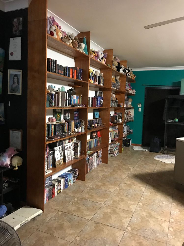

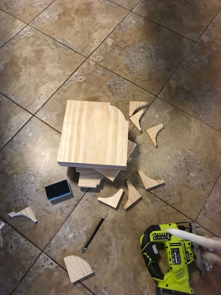

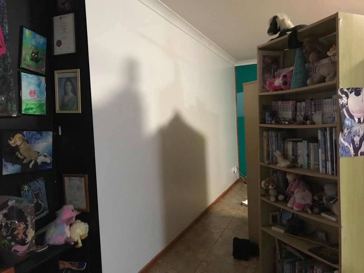

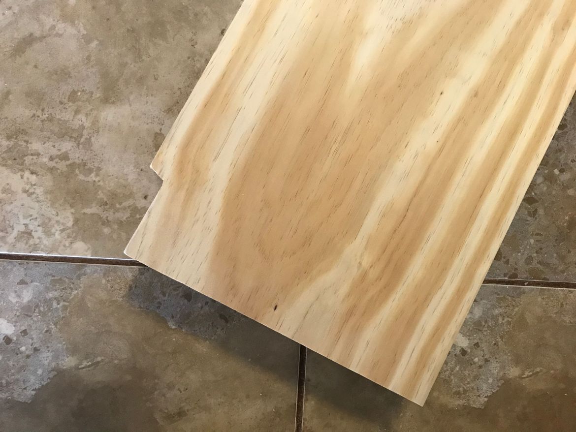

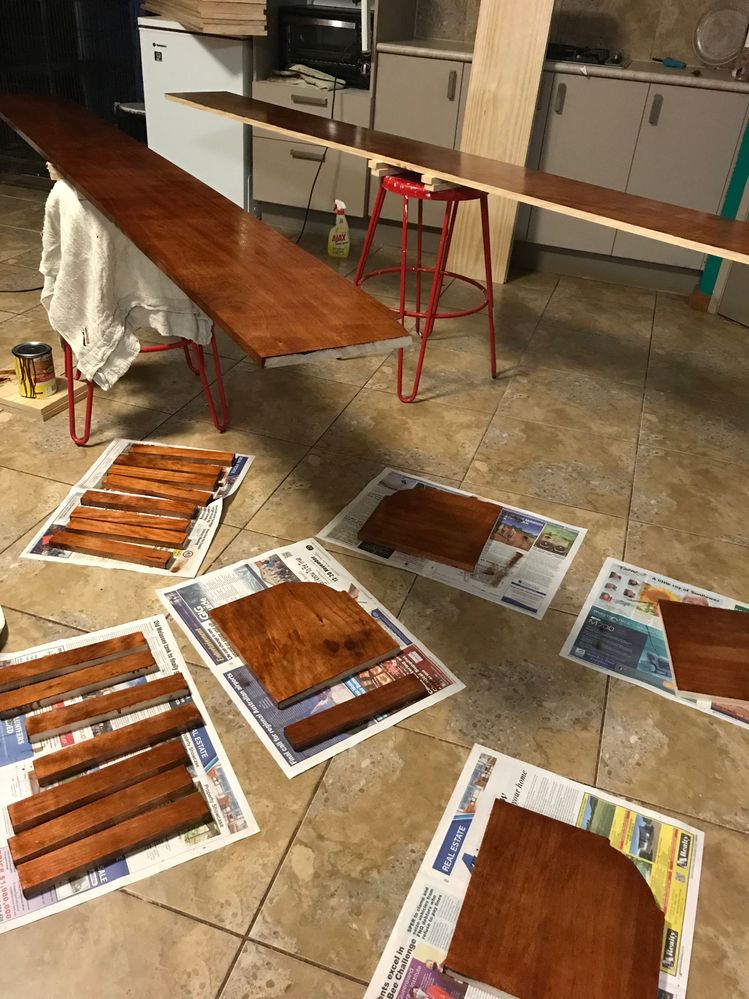

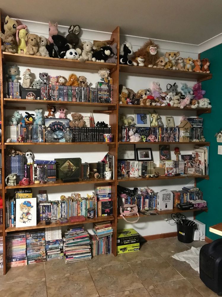

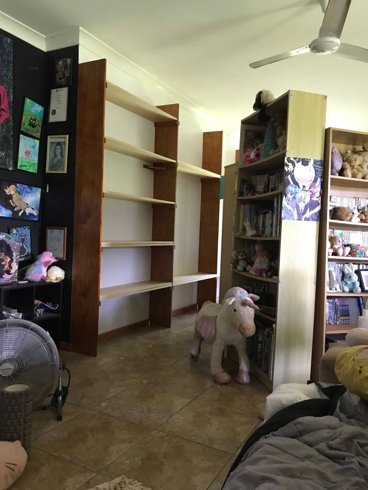

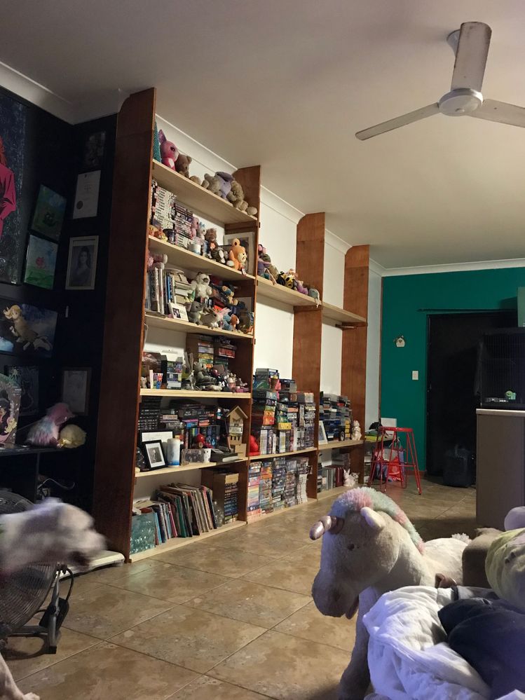

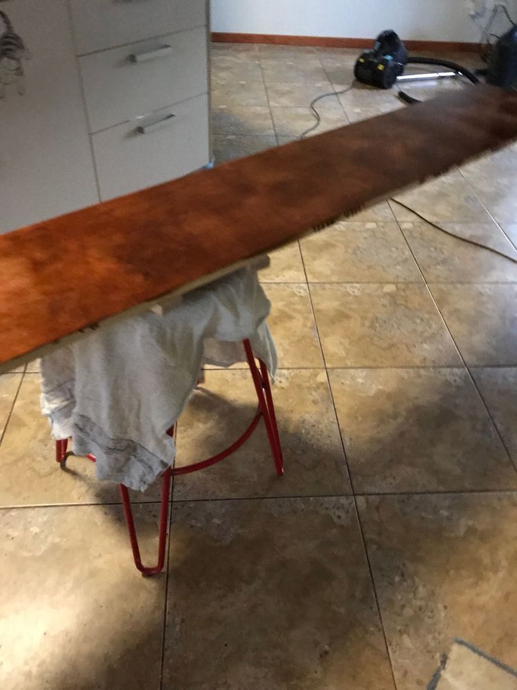

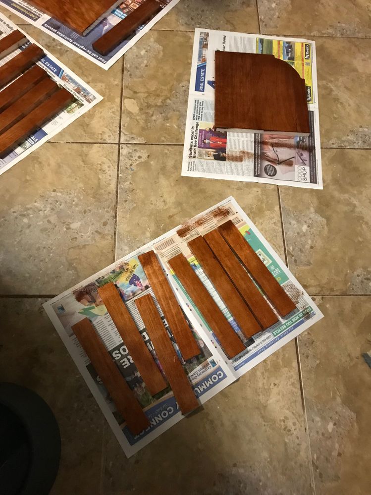

Full shotIn progressSides attached to wallAdding shelf holdersStaining wall the piecesShelf holdersJigsaw used to cut out ceiling pieceStainBottom skirting board shape cut outFloor to ceiling bookcase across 5 m wall. Built onto the wall. Sliding ladder to come at a later time. Purchased the pine pieces, stain, tools and fixtures from Bunnings. Start with cutting pieces to size, use jigsaw to cut out ceiling and floor skirting so that sides attach flat to wall. Stain all pieces. Attach shelf holders using spirit level. Then attach sides to wall with fixtures. Then sit shelves on holders.

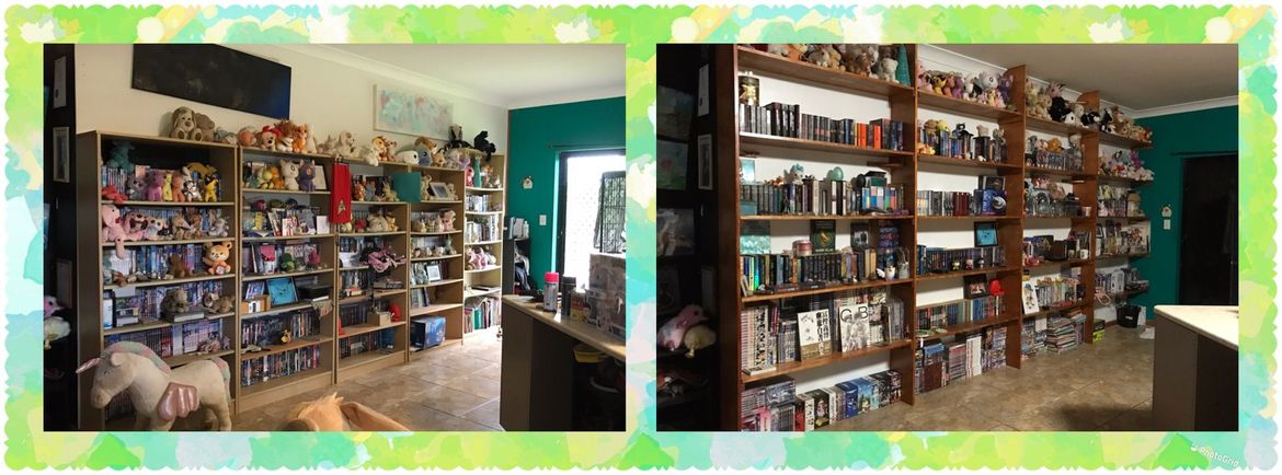

Before and after

Your custom-built shelf has made the storage of the items on your shelves much more relaxed. When you compare it to the old shelving system, it looked so crowded and there is definitely no more room for extra items. The open gaps between shelves now make it so much easier to identify the items on the shelf.

I did most of the construction work in a few hours each day over three days. That was affixing the pieces to the wall and the shelving holders. The longest time was staining and letting dry all the pieces. Which I did over a week for the shelving. I would then furnish once a shelf was complete. Everything thing was quite simple, though using the jigsaw to make cuts outs for the skirting and cornice was trial and error. Especially the Cornice as I didn’t have a mould. I had to practice on spare wood to get the right shape. It isn’t perfect as I’m not a carpenter lol, but it looks good. Bunnings cairns helped a lot with efficiency as I measured what I needed first and then got the cut shop to cut the pine to the lengths I wanted.
Lol so true. I used these timber pieces screwed to the wall and sides. Bag of fixtured
