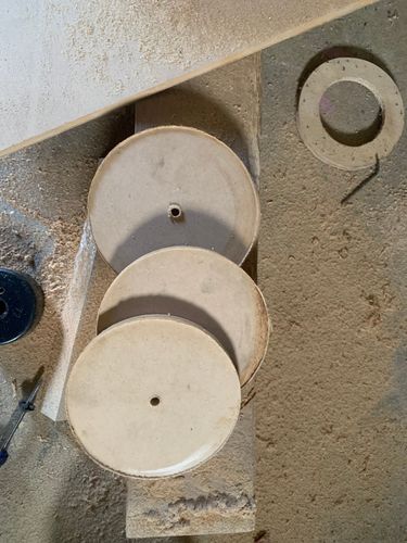

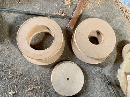

To start, I looked at all off cut Timbers I had and decided to make the top and bottom ring plate with MDF ( I definitely would use Ply in the future or pine). I used a 120mm hole saw and cut 4 pieces. The MDF was 12mm

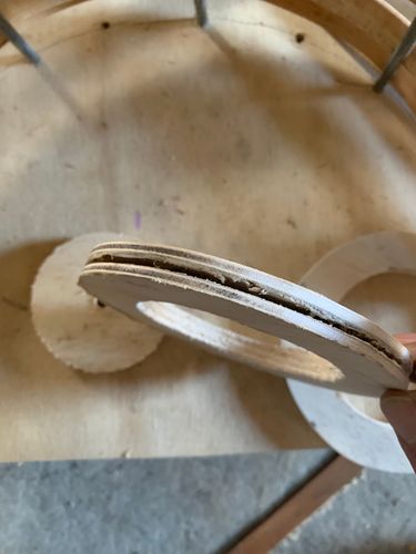

I then used a 100mm hole saw to cut 2 disks which I used 3mm ply.

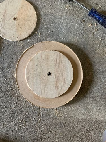

Take 2 large disks and the smaller disk. Glue both sides of the small disk and place it in the centre of the large. The 2 larger disks will sandwich the smaller one.
This above picture shows the larger disks made from ply. I did scrap this as it wasn’t strong enough. The picture shows the gap you will have between the 3 circles. This gap will later be used in insert your wood to create the pendant.
Place a heavy weight in the disks and Allow the glue to dry overnight.

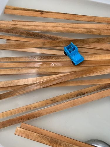

I soaked the timber for 1 hour in the bath in hot water. My son thought it made a great car ramp!

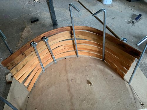

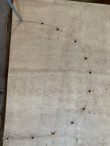

While the timber soaked, I made a jig that would allow me to bend the strips so they had to extra flex when putting the pendant together.
I used anything I had around and placed them in the holes I drilled. The wood strips were wiped down and carefully bent around the supports as below.
I allowed half to dry overnight and then the other half bent in the morning. Or 2 jigs could be made to dry all at once.

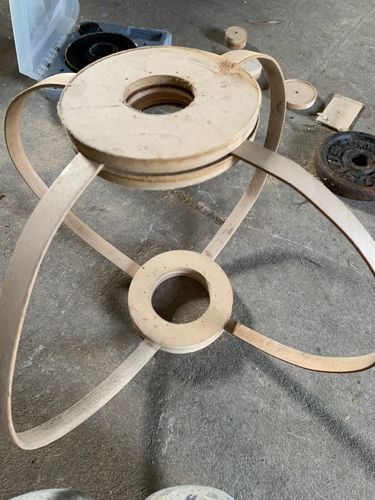

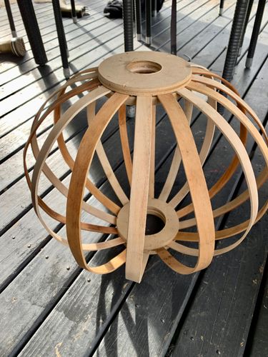

I inserted 4 strips in equal distance. Then attached them to the top disk.
Repeat this process until you have 18 strips inserted.

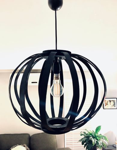

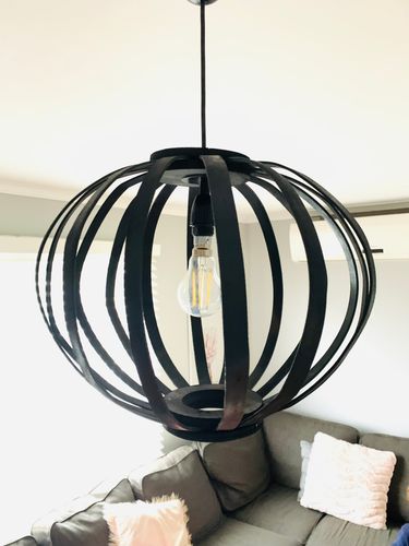

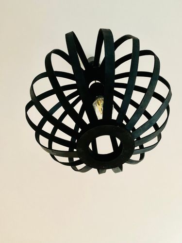

I added some extra nails between the plates for extra support. I sanded and painted and let there be light!!!
