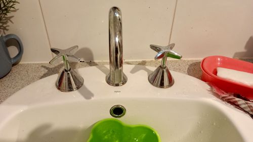

Which tool i can use to open the cone shape tap had as shown in the picture. I need to replace the washer to stop the drip water.

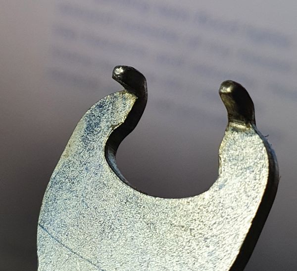

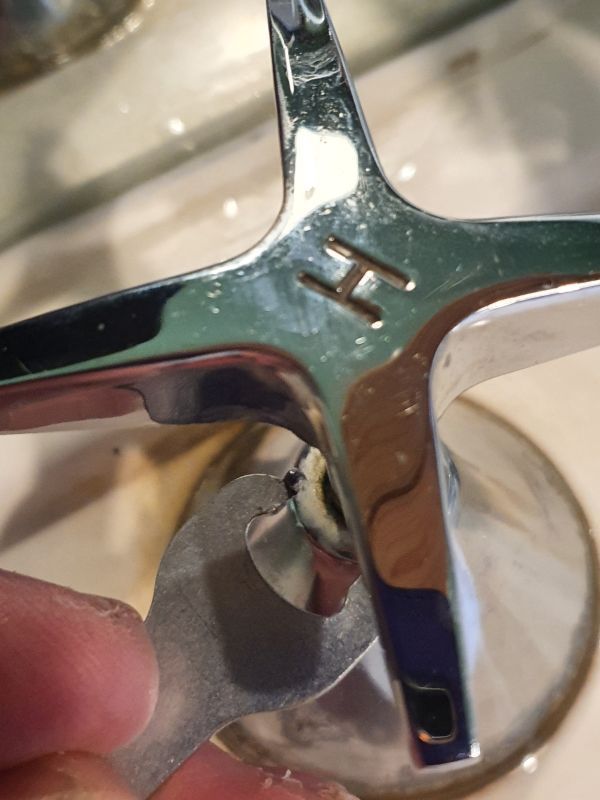

For the tap handle to be removed you'll need a small plumbing tool. Available from plumbing retailers and Bunnings - it's a rather fragile tool that looks like a miniature angle-grinder spanner...
By trial and error - those two pins fit into a nut - beneath the handle - into corresponding holes. Hold the handle tightly and looking down at the tap - I believe turning the spanner clockwise should undo the handle...
Notice my tap - hence I'm extremely keen to hear how you get on. 😁

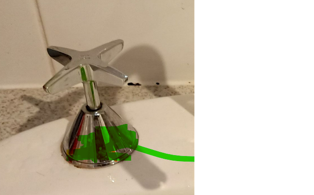

Thanks for the reply. Appreciate. I need to open the lower part cone shape cover as highlighted below. Does this tool help to open it? I saw a video where people just use their hands to open it.

"Does this tool help to open it?"
No. It just undoes the nut which releases the handle. Never worked for me. Once the handle is off you SHOULD be able to - by hand - remove that conical shaped piece which you've indicated in green. Once that is removed the tap working is revealed where with a spanner or shifter you can remove the top half of the tap revealing the washer - which you wanna replace.
But over time (and this is just my theory), water, soap, dirt and oxidation has made that very large area of thread - bind. It's impossible for me to undo it by hand. I was reduced to the below photo.
Unbelievably, even when I use the multi-grips - it takes off both the cone AND the top half of the tap!
You can insulate the jaws on the multi grips to reduce damage.
So sincere best wishes and good luck! Please came back with your progress - I am very interested! 🤔

It's great that you've already received excellent advice from the knowledgeable @Noyade. As he's mentioned, due to build-up in the thread, removing conical-shaped flanges can be difficult as there is no flat surface to grip onto.
Here are a couple of previous discussions you might like to read through: Plumbing issue - unable to unscrew faucet flange by @AndrewL and Tap Bonnet dramas by @timjeffries. Our members make several great suggestions within those topics. Ultimately, if you can't undo the flange, you might need to turn to more destructive methods. Often these involved scratching the flange or crushing it entirely. As @Noyade mentioned, wrapping tape around the tool's teeth or the flange itself can prevent some damage.
