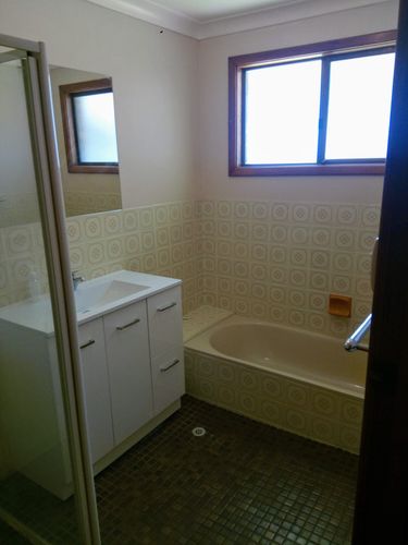

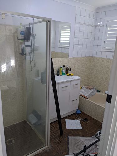

My wife and I purchased our first home in 2019 and moved in early 2020. Old home (1979) but super close to the beach in the Southwest of WA which we loved. Since then, we have knocked off every room in the home, bar two - the bathroom and master room. Both working full time, it’s been a slog, but as a teacher the two week holidays gives me a chunk of time to get stuck in…and so these July holidays the bathroom was finally completed. Here are the ‘before’ pics…

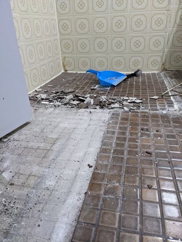

The floor tiles are London Black and was my first time laying floor tiles - messier job than I thought!! Originally there were those ghastly brown mosaic tiles…took a full day with the Ozito hammer drill but got them all up in the end.

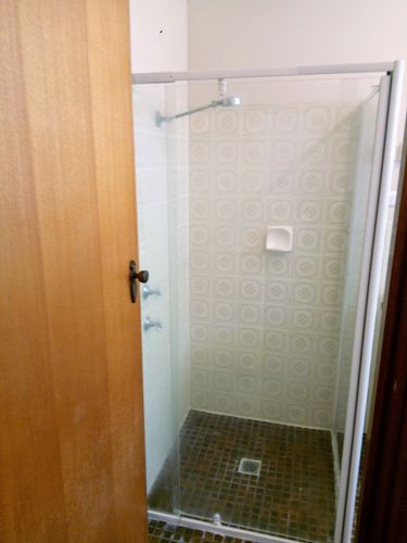

The original shower area was ripped out and filled in with screed before the new tiles went down.

Dulux white gloss tile paint over the shower area to cover the unsightly 1979 yellow tile colour theme was a blessing! 4 coats got rid of it.

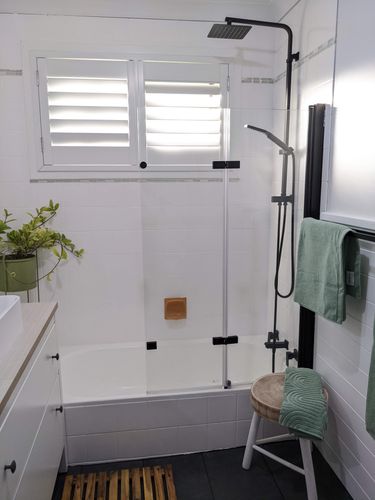

We chose a folding floating shower screen which can be folded right back to the wall if needed. While the shower head now has the option of rain shower as well as a handheld and the bath tap also.

The tub itself was a gross pinkish Color …so we tossed up whether or not to paint or get a new one installed. We opted to paint with white knight epoxy tub paint and worked out really well - took four coats but was worth it.

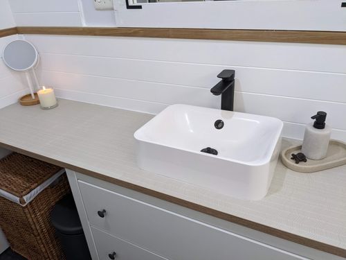

The caroma long head mixer combined with the above bench basin has given the vanity a modern fresh look, I’ve always loved the look of the above bench basins and finally had the chance to install one here. We originally picked a mixer that was too low - so that one went to the kitchen which worked out well.
