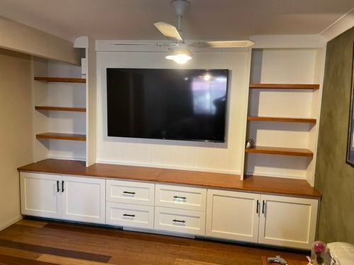

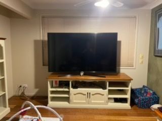

After watching YouTube and Pinterest for inspiration I decided to take this huge project of building from scratch a new TV unit in my home…
From frosting and encasing the window then covering in gyprock my blank canvas was ready…..

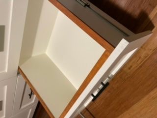

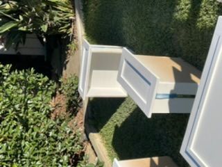

base units constructed from 17mm ply sheets, 4 draws from same material fixed together with pocket screws Shaker style
doors and draw faces also made with pocket screws with mdf inserts
Painted with Ozito spray gun then installed in to place
