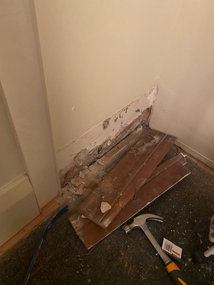

Hi there.I have just pull out the skirting board and found that the wall is damaged (there are aslo some nail holes).
How can I fix it? I would like to fix it and then apply the new skirting board.Cheers,

Hi Ian @Ian0403
Two boards visible - but only one exposed space? Do they join together somehow?
I'm guessing the rendering doesn't have to be perfect - as it's gonna be covered.

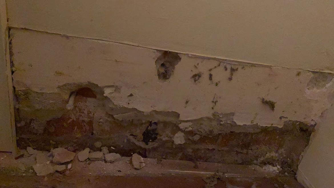

Thanks Mitchell, I also want to patch the small hole as well. Can I use render as well. I want to paint after the render.

Thanks for replying Noyade. There was a wardrobe door between them. I uninstalled the wardrobe. I also want to patch the small hole as well(on the image as well). Can I use render as well. I want to paint after the render.

You can definitely use the render to cover the holes in your wall. Just keep in mind that once you've done the render, make sure to give it enough time to cure. Painting or drilling into the surface too soon will create fissures and compromise the strength of the render.
