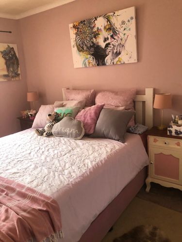

With these bedsides I removed the 2 bottom drawers and runners and cut to size some plywood for a bottom shelf, I glued and nailed the Ply after it was sanded and then filled over the top and joins for a smooth finish, I sanded the top to expose the beautiful woodgrain and applied a liming white and polyacrylic to the top for a buttery smooth finish. I applied a primer, 3 coats of mineral furniture paint and finished with a wax to the painted areas, and installed new gold hexagon shaped hardware. I absolutely love the satisfaction of completing a flip.
