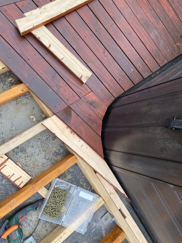

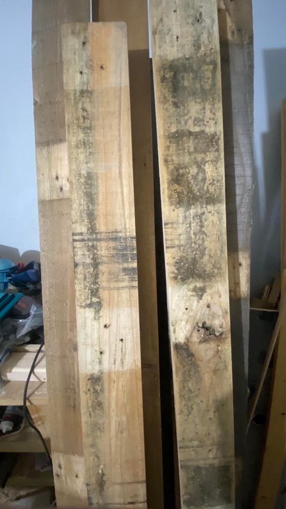

All the decking boards and noggins in these photos are reclaimed treated pallet or crate wood that has been sanded and thicknessed and then stained to match other wooden features around the house.

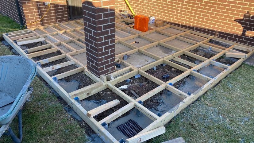

The wooden joists are treated timber from Bunnings that were perfect structural foundations for the decking that followed.

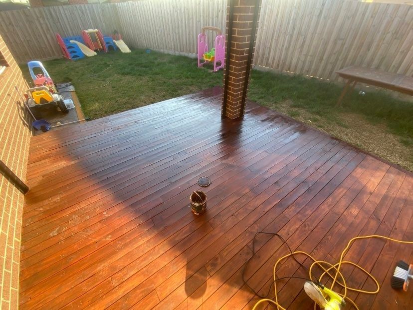

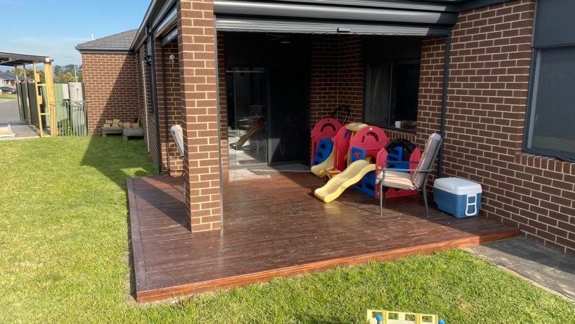

Deck 1: Courtyard

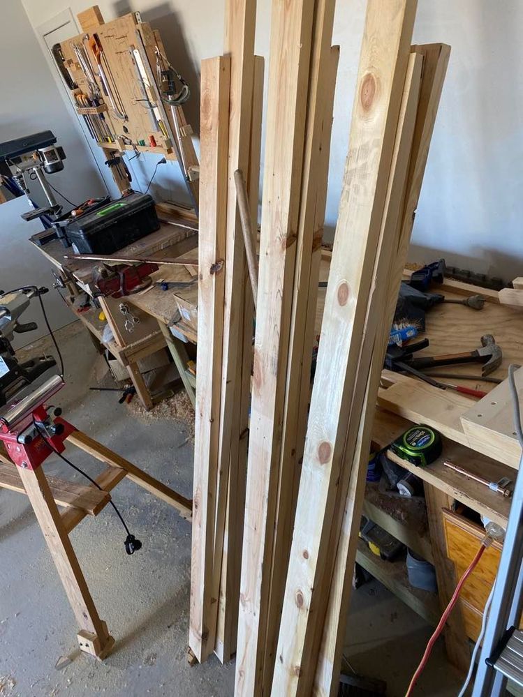

Raw boards.

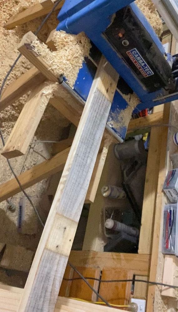

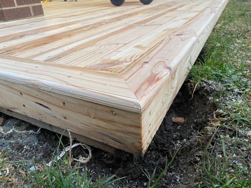

Cleaning and thicknessing boards.
Timber prepared.

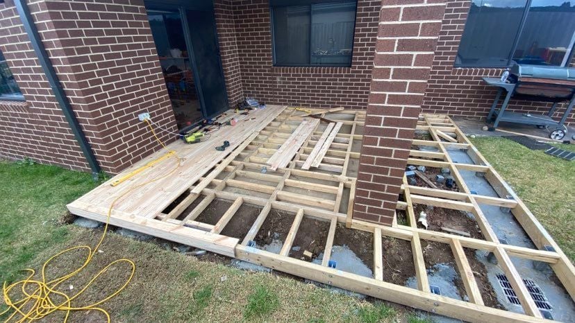

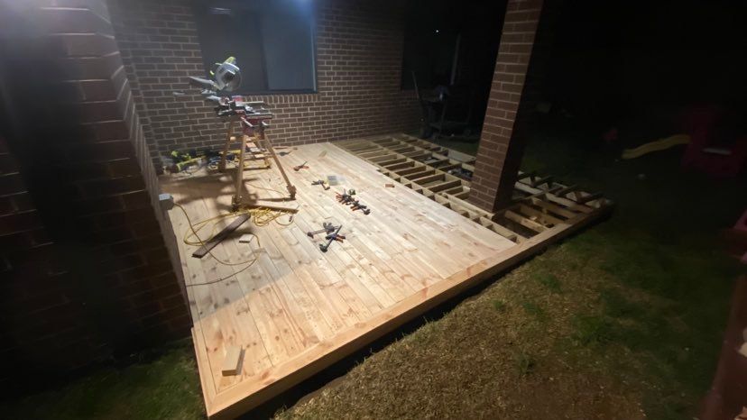

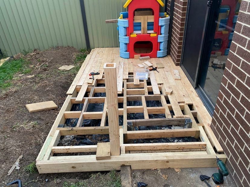

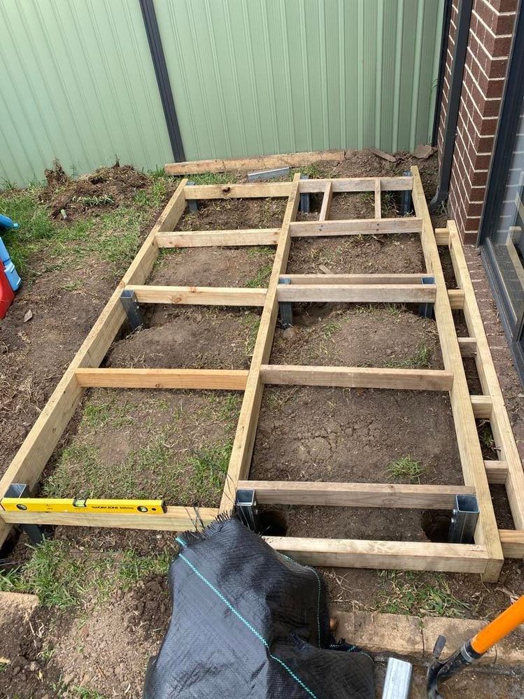

Placing the frame and bolting to house.

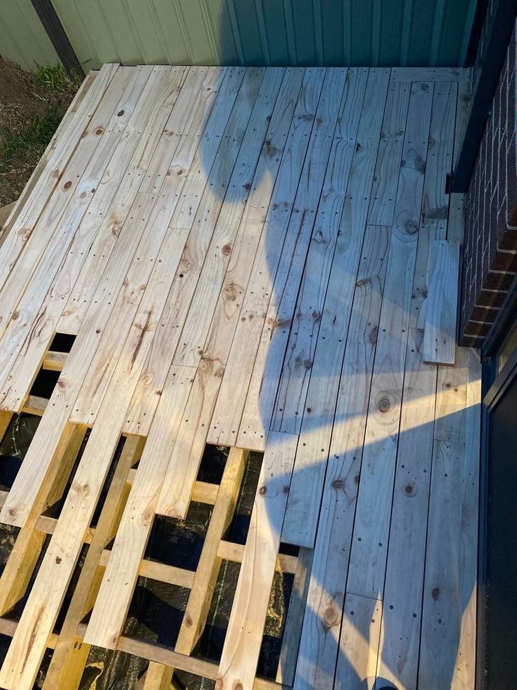

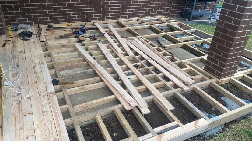

Placing decking boards

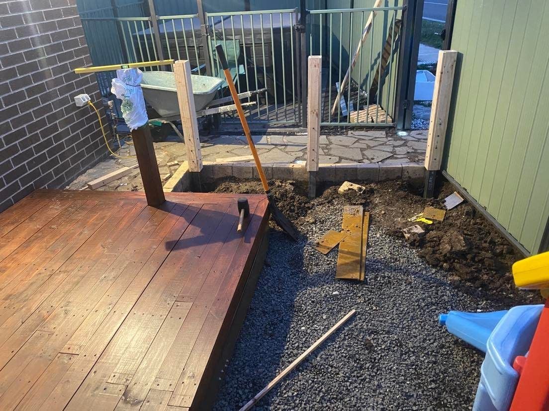

Preparing the ground for landscaping.

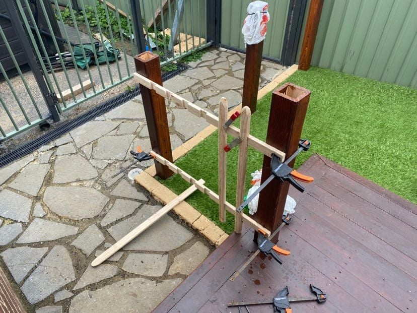

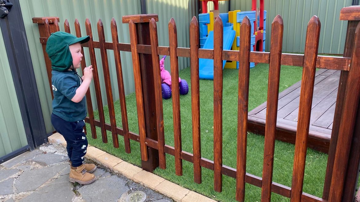

Starting the fence.

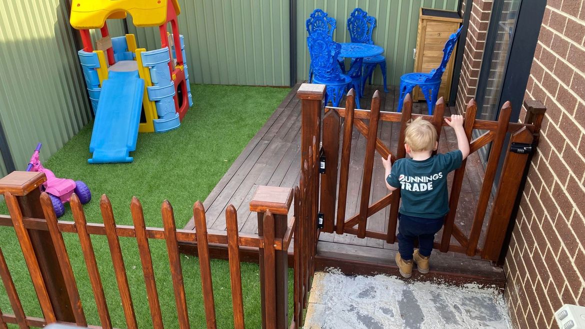

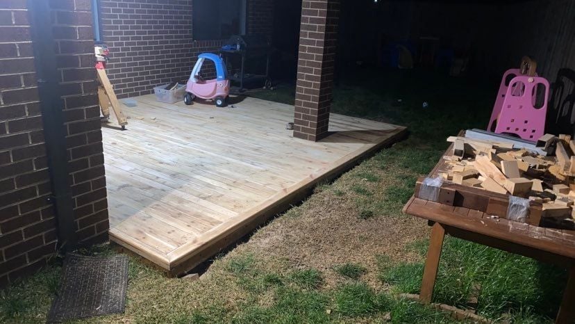

The finished deck has been well used.

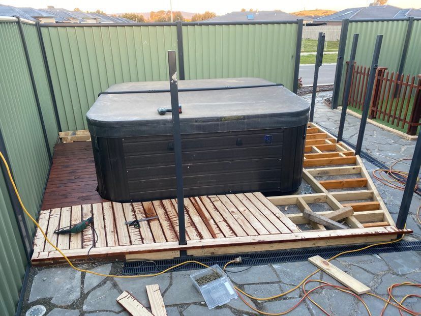

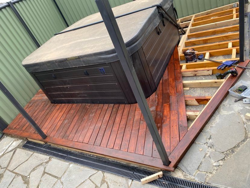

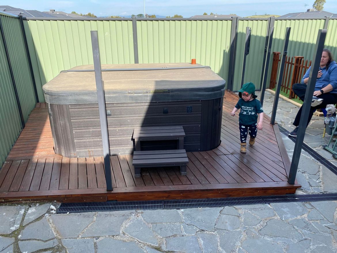

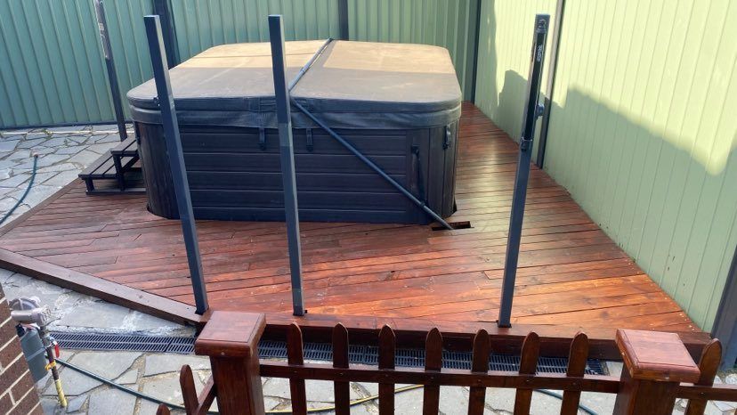

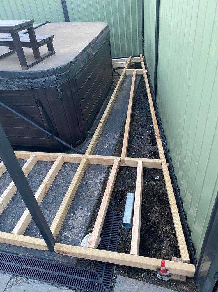

Deck 2: Spa

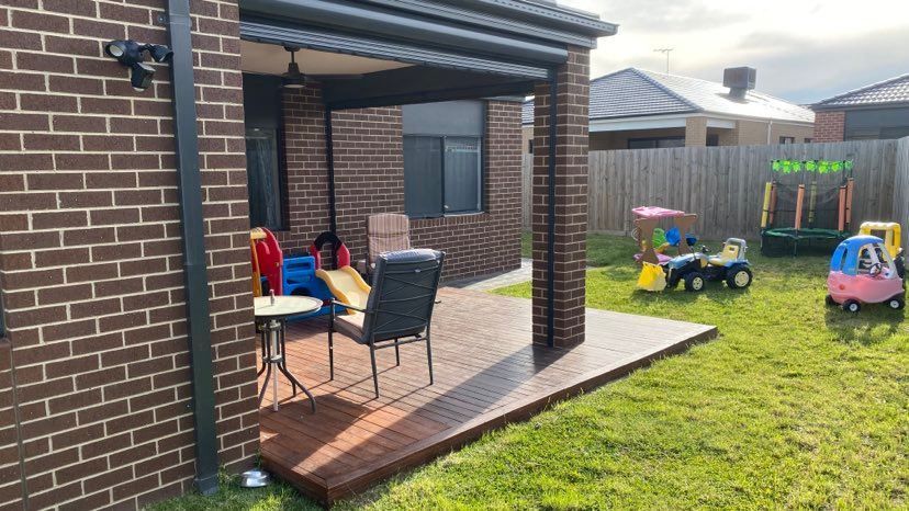

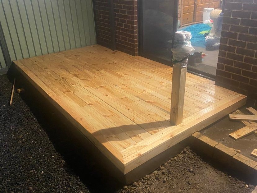

Deck 3: Backyard

A deck can cost upwards of $3000 to $4000, so I decided to try to mitigate the cost by making do with what I could. The 65mm x 65mm RHS steel posts I got from work free, and I got the pallet wood free from the business next door.
I then just needed to buy all the timber joists and screws from Bunnings, spending about $250 on each of the three decks. Two 4L cans of stain managed to cover all three decks with at least two coats. All up I spent under $1000 and I know that I probably saved $8000, or more.
The stain is Intergrain UltraDeck Merbau. I love it but it was not an easy decision to make because I also loved the natural colour of the wood. But with the deck getting so much use the natural colour wood not have held up for very long, even when sealed.
