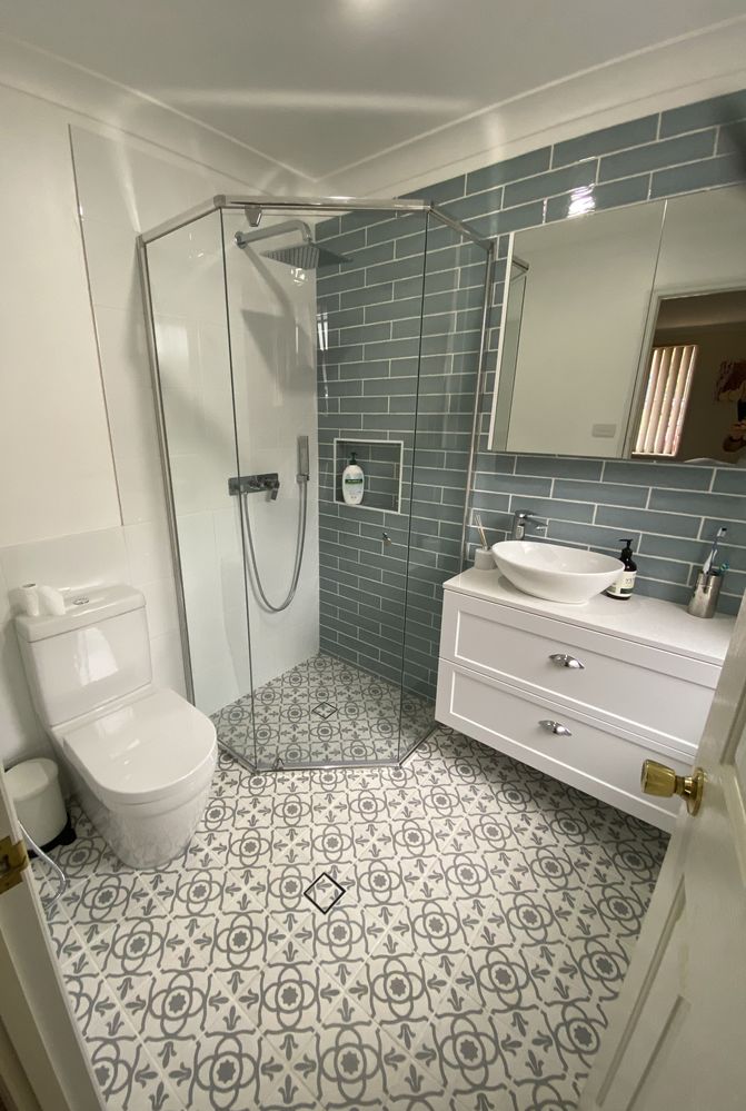

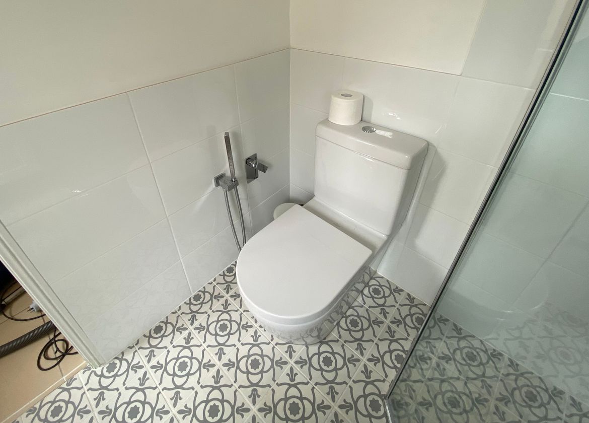

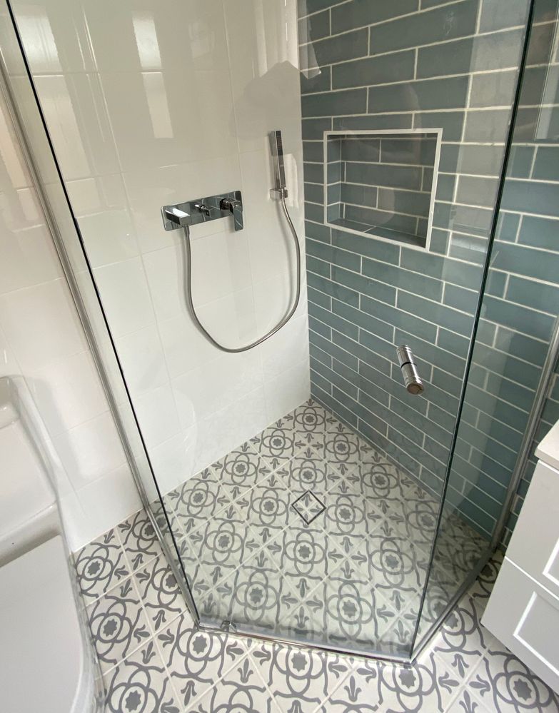

This was my first DIY project. The idea was to replace the old tiles and shower screen to have a feeling of cleanness. While removing the tiles I punched so many holes into the walls that I've decided to remove them completely. This opened new possibilities such as adding water pipe for bidet, recess in the shower and recessed shaving cabinet. Ultimately, I ended up redoing the entire bathroom which took me several months but we ended up being quiet happy with the result.

The Result
After

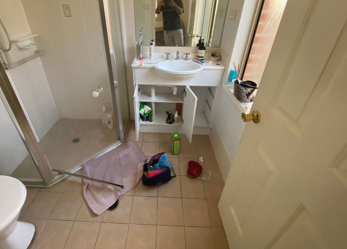

Before

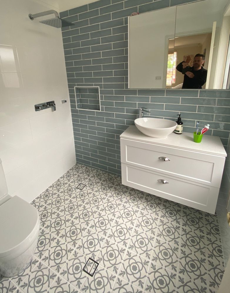

After

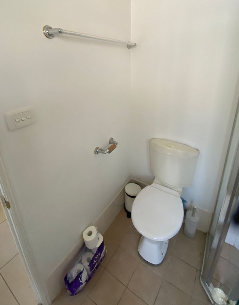

Before - toilet
Shower detail
