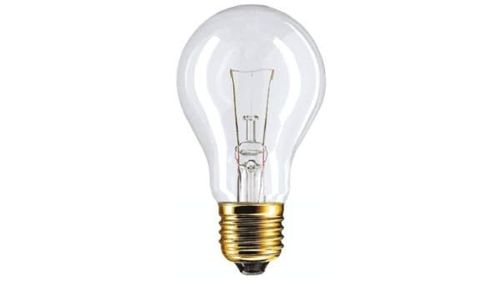

Screw in globes . E27 and E14 are your most common these are the large and small screw type globes.

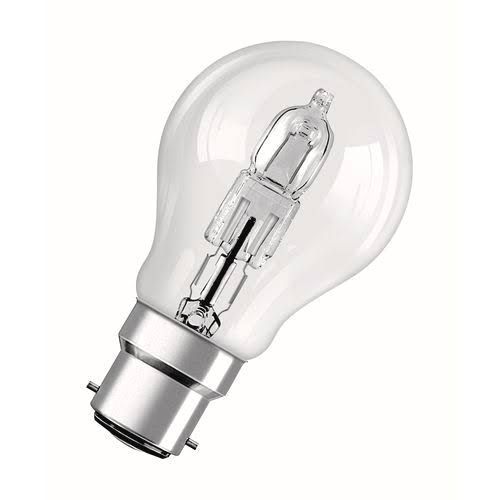

Push and turn globes. B22 and B15 are your most common these are the large and small push turn type globes.

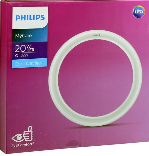

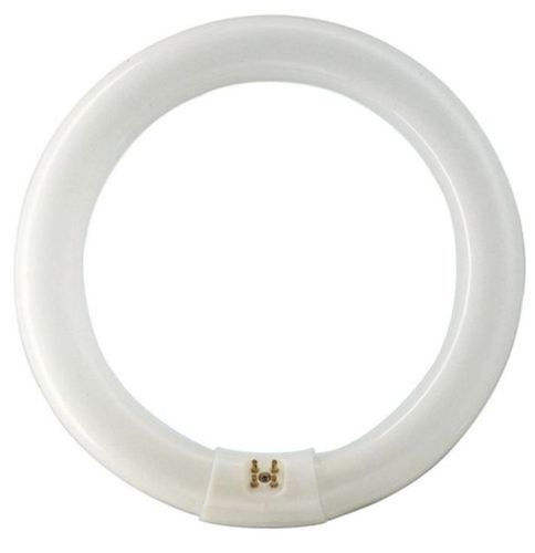

Fluoro circular tubes. T9 and T5 are your 2 common tubes these are the thick ones and the thin ones.

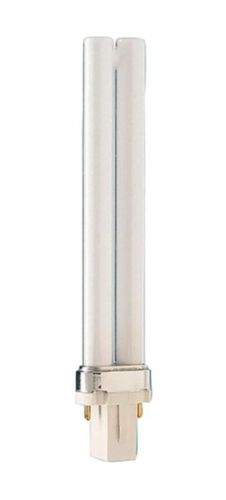

Push in Fluoro tubes. PL tubes these are either 2 pin or 4 pin

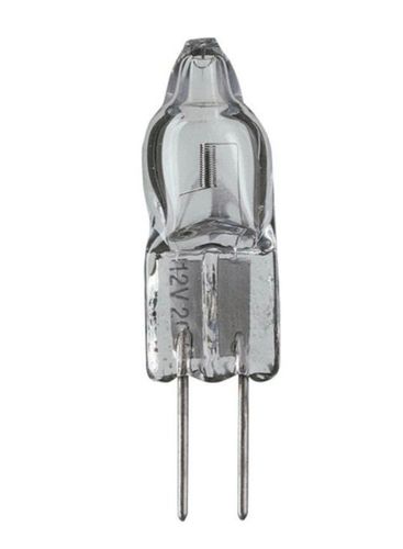

G4 bi pin low voltage halogen globes often used in range hoods or low profile downlights, these also come in a LED option

Incandescent the original technology been around since Thomas Edison invented it. It's the act of passing voltage over a thin wire that heats up and glows then emits that as a light.
Halogen is an advancement on Incandescents but uses similar technology.

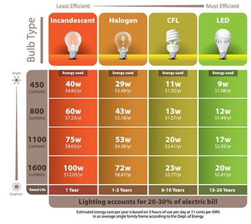

So what is better?
The latest technology LED has the greatest energy saving for the same light output as seen in the chart below, there is also no ramping to full brightness it is on or off unlike fluoros, there is less heat output unlike Incandescents/ halogen.
so from that chart you can see the comparison between the watts of the globe required, the cost to run for the desired light output in lumen.
Lumen? What's that you ask?
Lumens is the common measurement across all globes and it is the amount of light output so when you are comparing globes or light fittings the lumens will be your guide to how bright or dull it is.

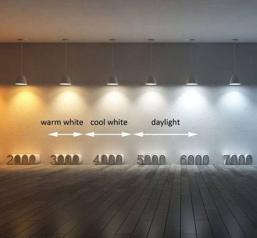

Next up is colour of globes.
There are 3 common terms that is referred to.
Warm White, Cool White, Day Light.
Warm White is that yellow colour typically it is measured at 3000k (kelvin) I usually recommend it for the bedroom and bedside lamps or table lamps as its a soft light.
Cool White it's the in between colour it's not yellow but it's not white white, usually measure at 4000k (kelvin) I typically recommend for general house use.
DayLight this is the hospital bright light typically measures 6500k (kelvins) and is the brightest of them all.
Below is a comparison chart of the colours.

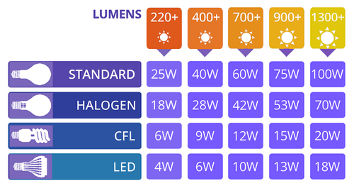

So what about watts?
You've just picked up a new table lamp and it says you require an E27 globe Max 60W and you head to the globe isle and look at the LED globes in the E27 section but none of them go up to 60w so what the??? Alot of the table lamps or fittings are still rating globes based on the old Incandescent globes due to the wiring of the actual fitting.
So below is a guide to choosing a LED against the recommended Incandescent.

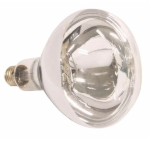

Next are Heat Lamps found in 3 in 1 and 4 in 1 bathroom heaters, these come in 2 wattages 275w and 375w once again it is best practice not to increase the size of the globe due to internal wiring if unsure go with the 275w.

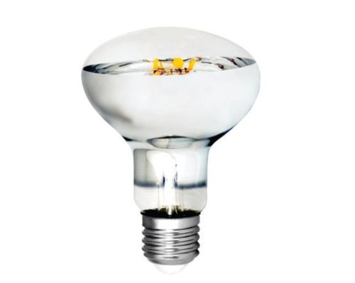

R80, R63, R50 globes these fall under the reflector globe category and are generally used for the centre globe of the 3 in 1 and 4 in 1 bathroom heaters. It is always best to compare your old globe to the new one when replacing unfortunately there are some height differences. The R80s are also used in the older style downlights as well and some flood lights. They can come in halogen and LED.

LED conversions for fluorescent fittings, this is possible for light fittings that have a magnetic iron core ballast and starters, it is possible for newer fittings but requires modification from q qualified electrician. The best way to tell is see if your fitting has a starter as per below, this must be replaced with the one that comes with the LED replacement globe. Benefits are lower power consumption, better light output and even smart light conversion.
