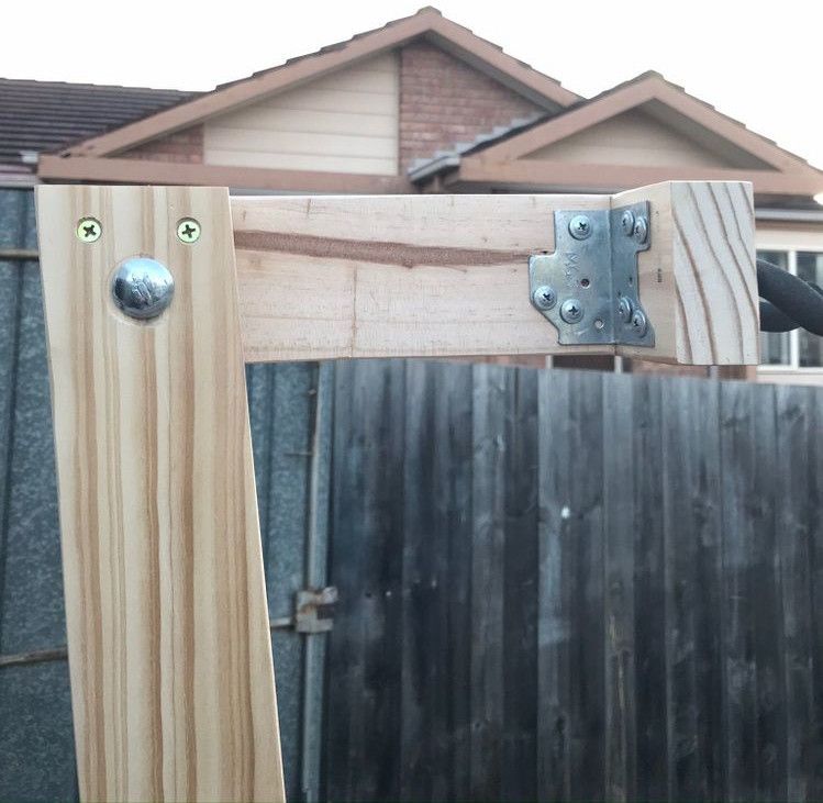

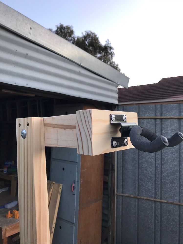

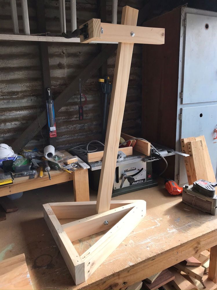

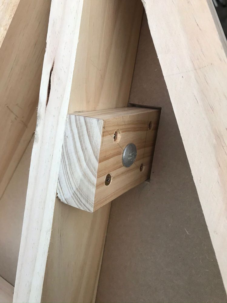

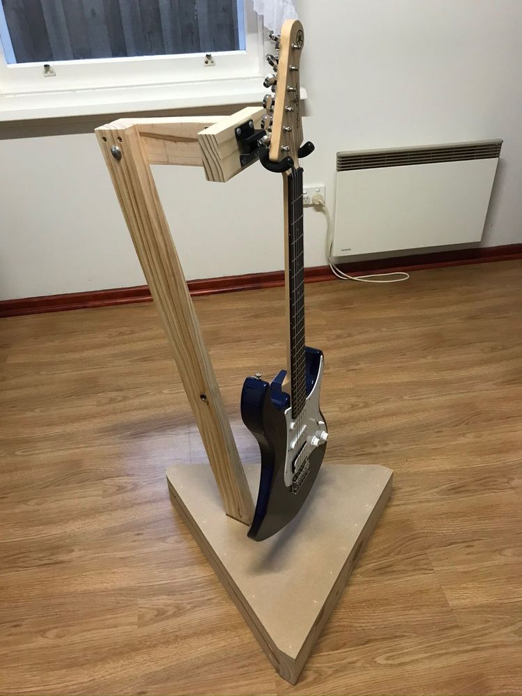

This sturdy guitar stand uses Pine joined at various angles for a striking geometric look.
The project

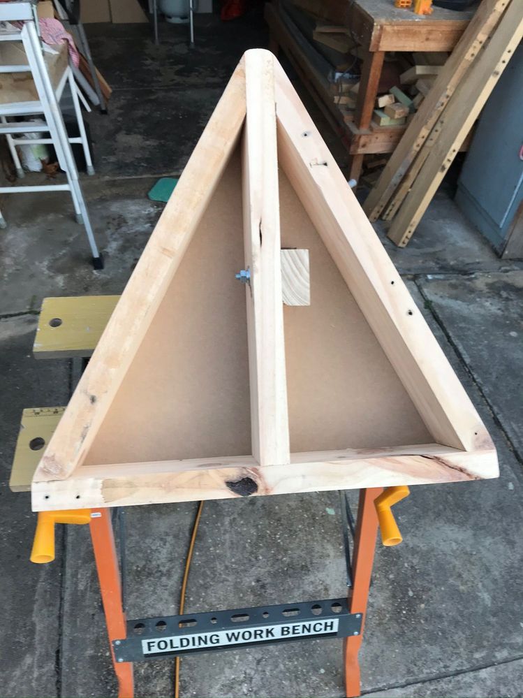

I needed a guitar stand and decided to make it myself. I got some inspiration from looking at guitar stands on the Instructables website. There are ideas there to cover just about everything you could think of.

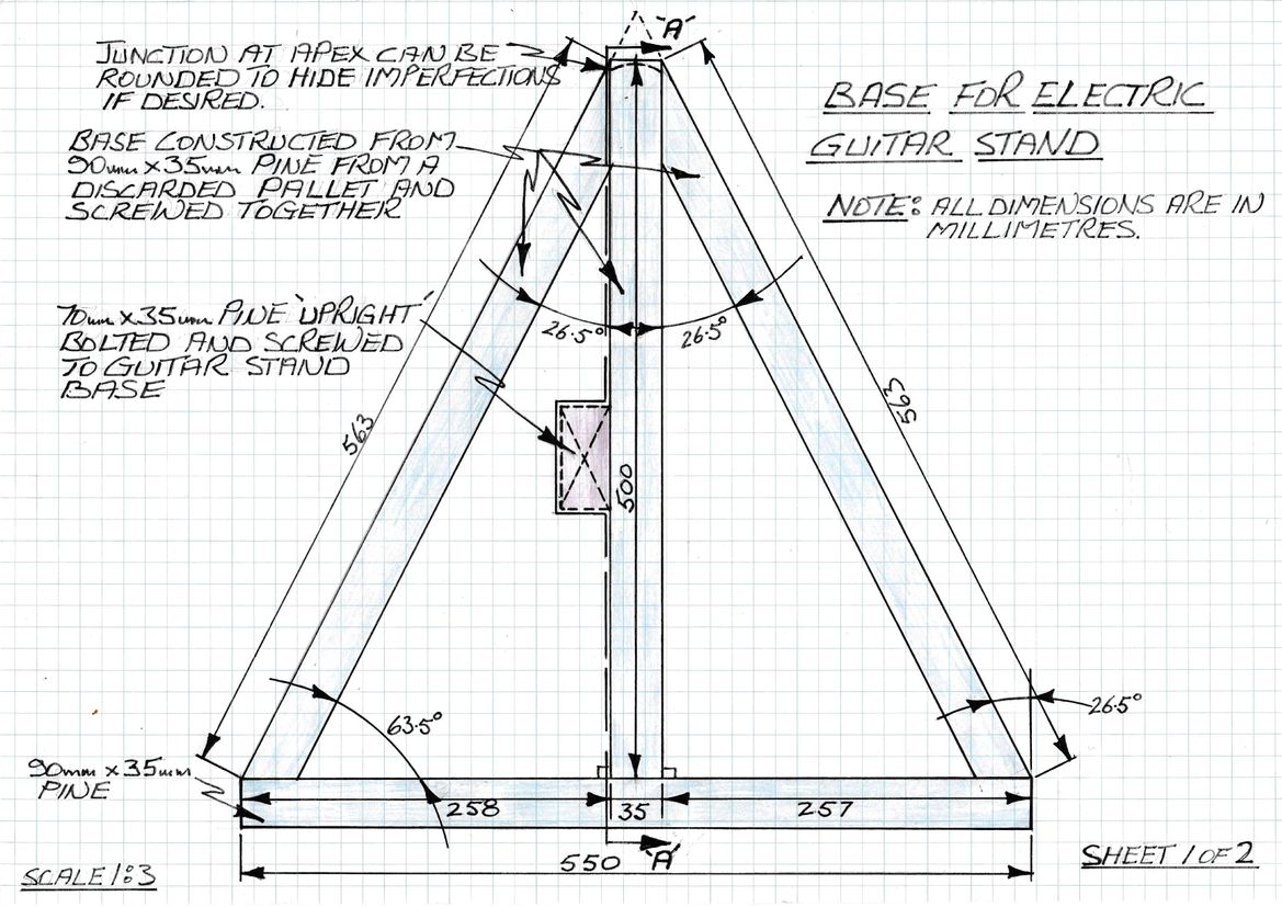

Plan view of guitar stand base with dimensions.

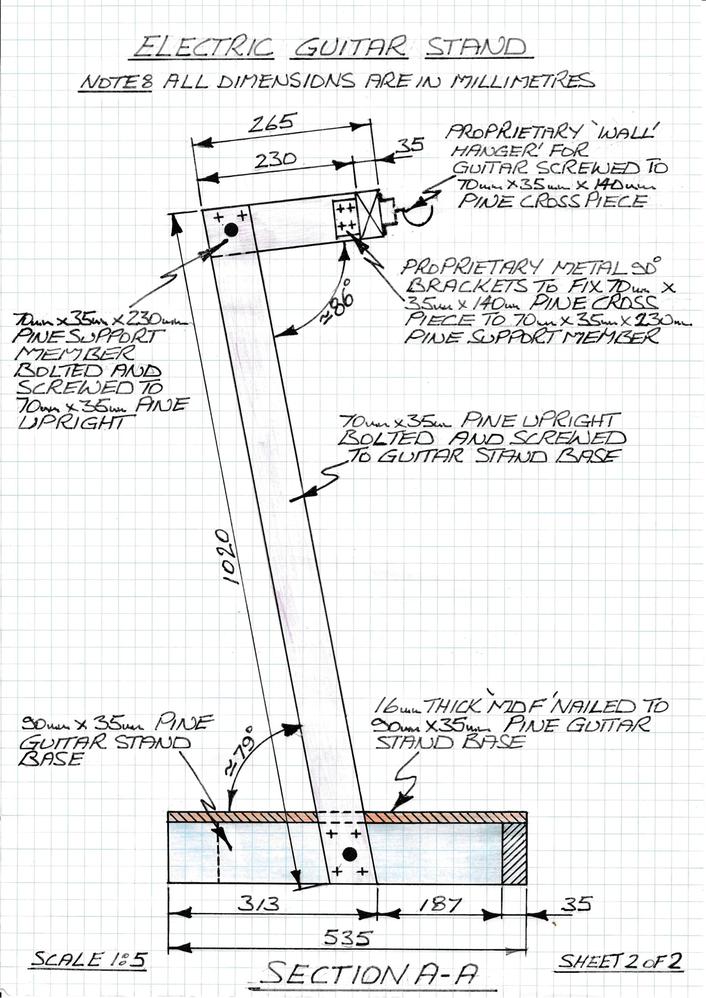

Sectional view of guitar stand with dimensions.
The guitar shown is a Yamaha Pacifica.

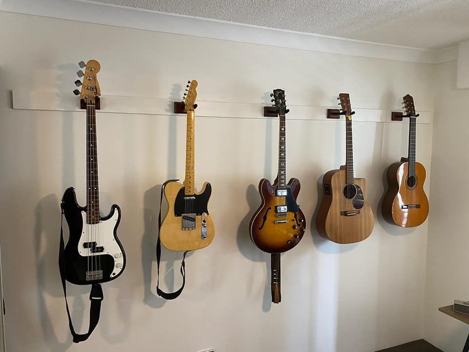

Bunnings Workshop member HireAHubbyMark put up this clever wall-mounted guitar rack for a client.
