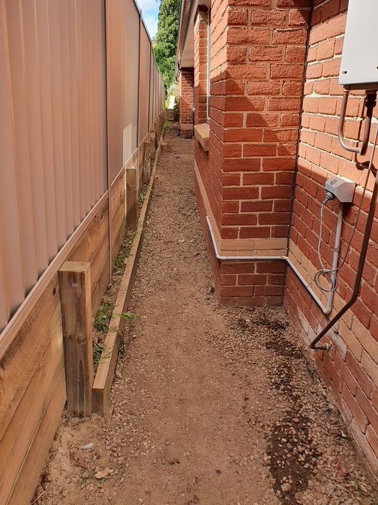

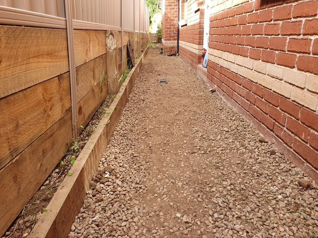

The side path of the house was one of those projects we wanted to do for a long time. It was a very narrow area, overgrown with weeds, and it seemed that the builder had placed the pavers as an afterthought.
We decided to concrete the area as that was the best low-maintenance option. We got some quotes from the concreters, who did the excavation and poured in the cement.

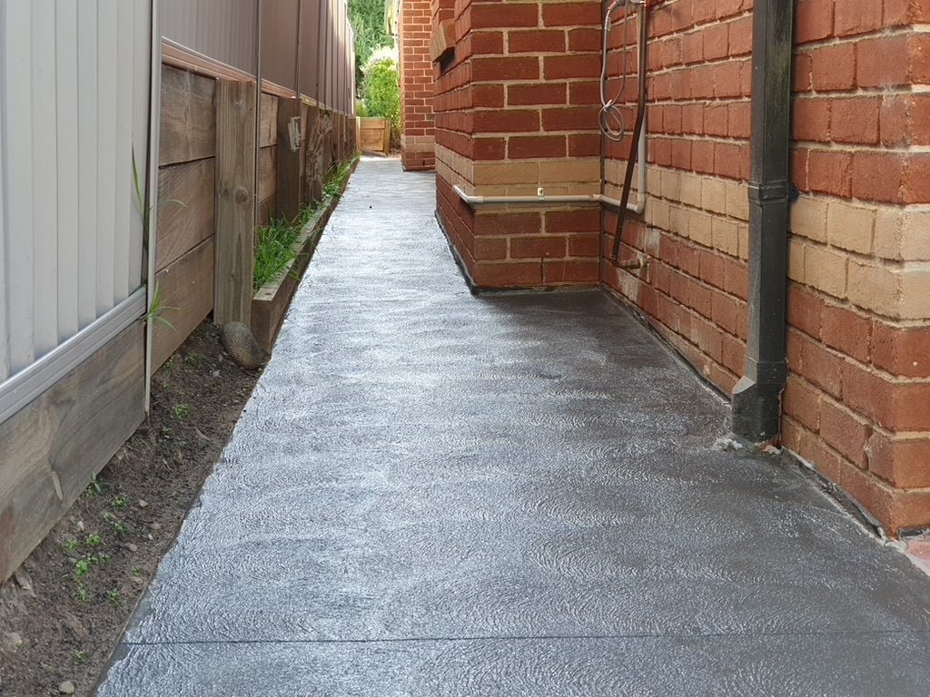

It was suggested to us to seal the concrete surface with a hard-coat polymer. You can tint the sealer to a specific colour. We decided to use the Colourtone sealer system with a charcoal tint (there are more than 20 other colours if you don't like charcoal).
We chose a semi-gloss sealer.
Mixing the tint into the sealer.

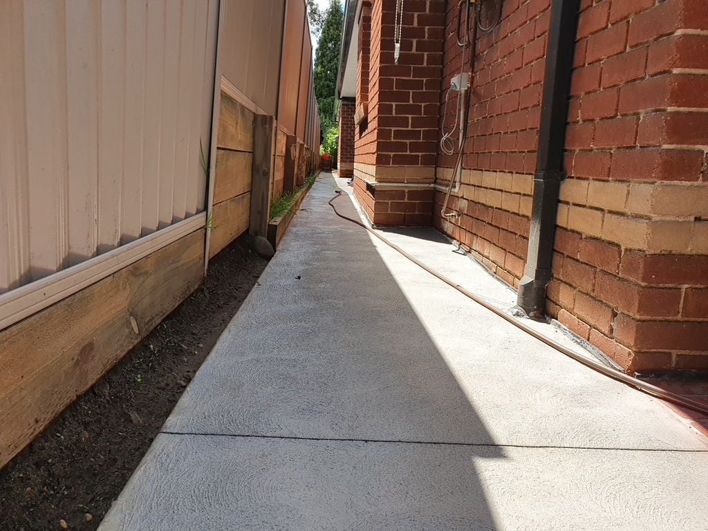

Before we did the sealing, we power-washed the concrete and left it to dry for 48 hours. To apply the sealer I used a 11mm-nap paving roller attached to a painting pole. For the side areas, I used a smaller roller.
It took about 45 minutes, and the sealer dried in about 30 minutes. It's easiest to all the sides first using the smaller roller then move to the main areas. I applied the second coat 24 hours later. I didn't tape the edges and walls but took my time doing the sides to reduce any carryover.
