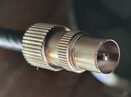

PAL is the type that plug into the back of your TV and some wall socket it can be easily identified by not having a spinning nut on the end whereas F Type has a spinning nut.
Below is a PAL cable.

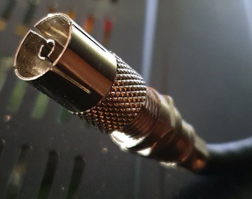

Whereas below is a F Type cable.
F Type connections can be found at TV splitters, boosters, HD boxes, wall plates and generally behind the plate throught to the antenna.
