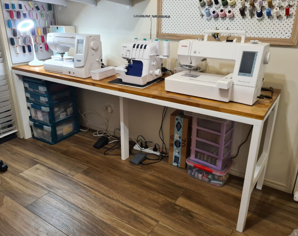

This sturdy, purpose-built sewing table has room for several sewing machines on its 2.2m timber benchtop.

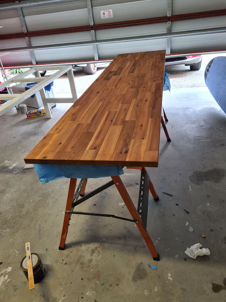

It was a challenge, but I'm happy with the outcome. I had my builder friend come and cut 5cm off the width of the benchtop with his fancy circular saw as I didn't think I'd be able to do it neatly with mine.

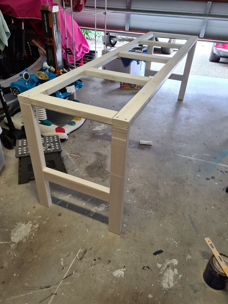

I already had the paint, which I had bought from Bunnings for other projects. For the frame I used one coat of Taubmans Tradex Ultra Prep and two coats of Tradex oil-based enamel. For the benchtop I used four coats of Bondall Monocel oil-based satin clear wood varnish (sanding between each coat with 240-grit sandpaper).

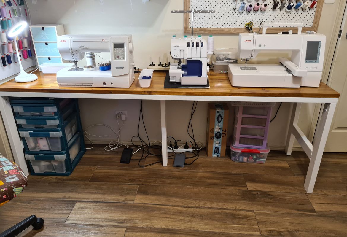

As I made my desk 2.2m long (to fit all my machines) I put four bracing pieces across the top of the frame at Nham's suggestion and one long one in the middle to the floor so it wouldn't sag when the benchtop went on.

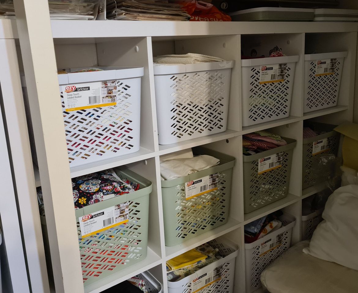

I replaced all the plastic tubs with one 14-cube storage unit and one eight-cube storage unit plus Ezy Storage Brickor plastic baskets, all from Bunnings.
I can actually move and find stuff in the room now. Before I just kept the door closed. I'm very happy with my new sewing centre.

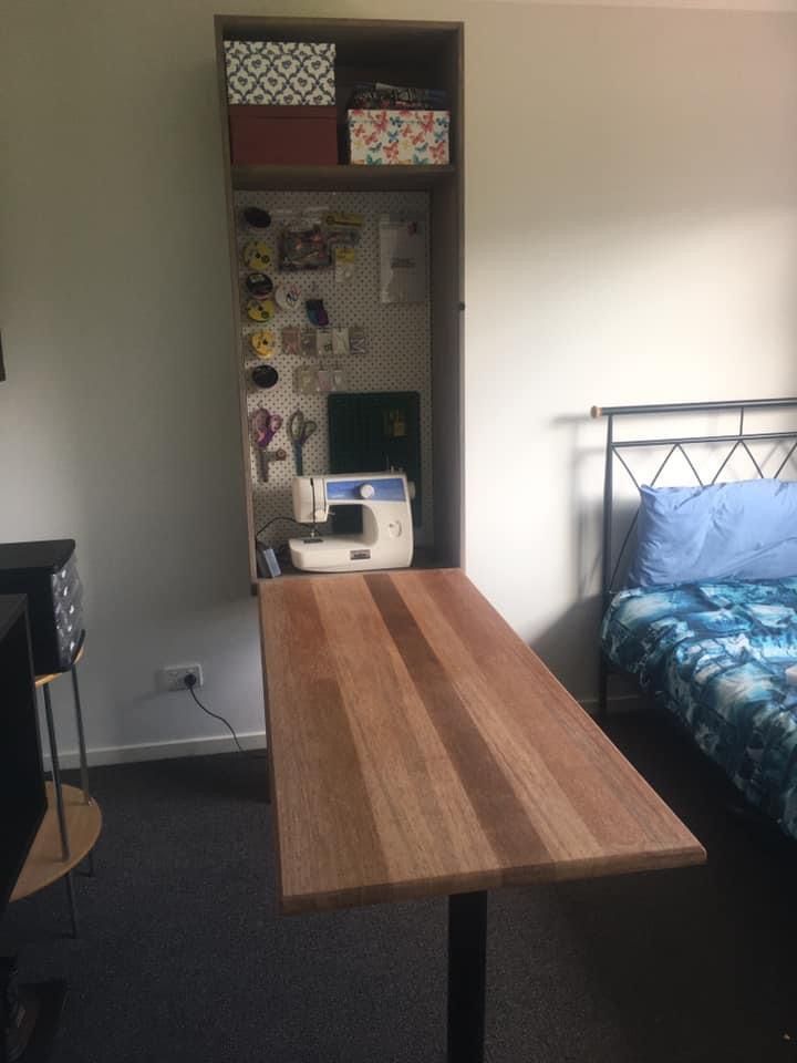

Bunnings Workshop member Gareth made this brilliant drop-down sewing table with built-in storage.

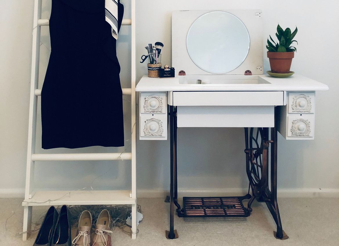

Workshop member bellee78 turned a vintage sewing machine stand into a stylish and functional dressing table.
